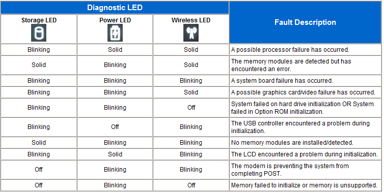

    Hi friends
    I have a dell latitude e7450 which ia not turning on laptop hdd led and powering is blinking wifi led is solid.
    Can anybody help

      Re: Dell latitude E7450 Not powering on
      Originally posted by sureshbobby
      Hi friends
      Can anybody help
      It looks like problem with video card, which I guess is integrated wit CPU.
      Also it can be just Bios problem. So at first I suggest you flash bios.
              Hi Friend tested the given bios but it now working, Now the error is
              power led & wlan led solid, hdd led blinking
