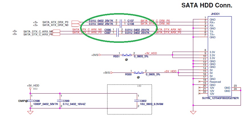

    I have problem with lenovo g505 with motherboard LA-9912P, cannot recognise any HDD or SSD.
    I guess it's cpu (because control everything in this board).
    Does anyone fix this problem?
    I attach schematic...

    Do you have voltage on pin 8-10 and 14-16? Are R551 and R550 OK?
    Check damage on connector and flex cable (if it has got one).

      8-10 = 3V
      14-16 = 5V
      So I guess the problem is cpu...
