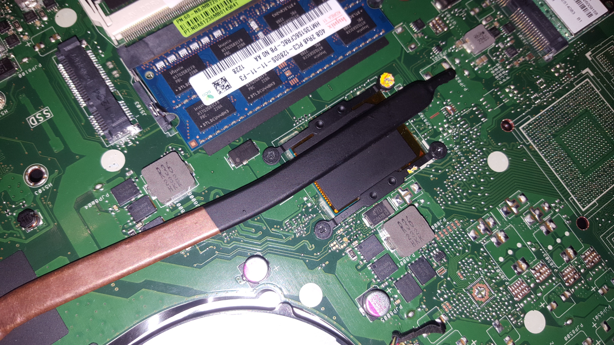

    Hi guys Laptop asus k56ca i5 3337u integrated with hd 4000gpu.
    Laptop power up but no display, no display on hdmi memory tested switched with working ones problem still exist.
    Motherboard k56cm rev 2.0
    Anyone got schematic?
    Upon inspection no visual damage all coil gives voltage readings all but one
    Take a look at the pic there are two coils right next to cpu R36 232 Hkk one gives 0.9v other 0
    Could this be what cases problem?
    Where can i find replacement
    Re: ASUS k56ca no display
    Have you try to reprogram bios with a dump ?
      Yes no effect
        are you sure that the bios is correct for this motherboard (UMA) ?
          Yes im sure its not bios issue...
