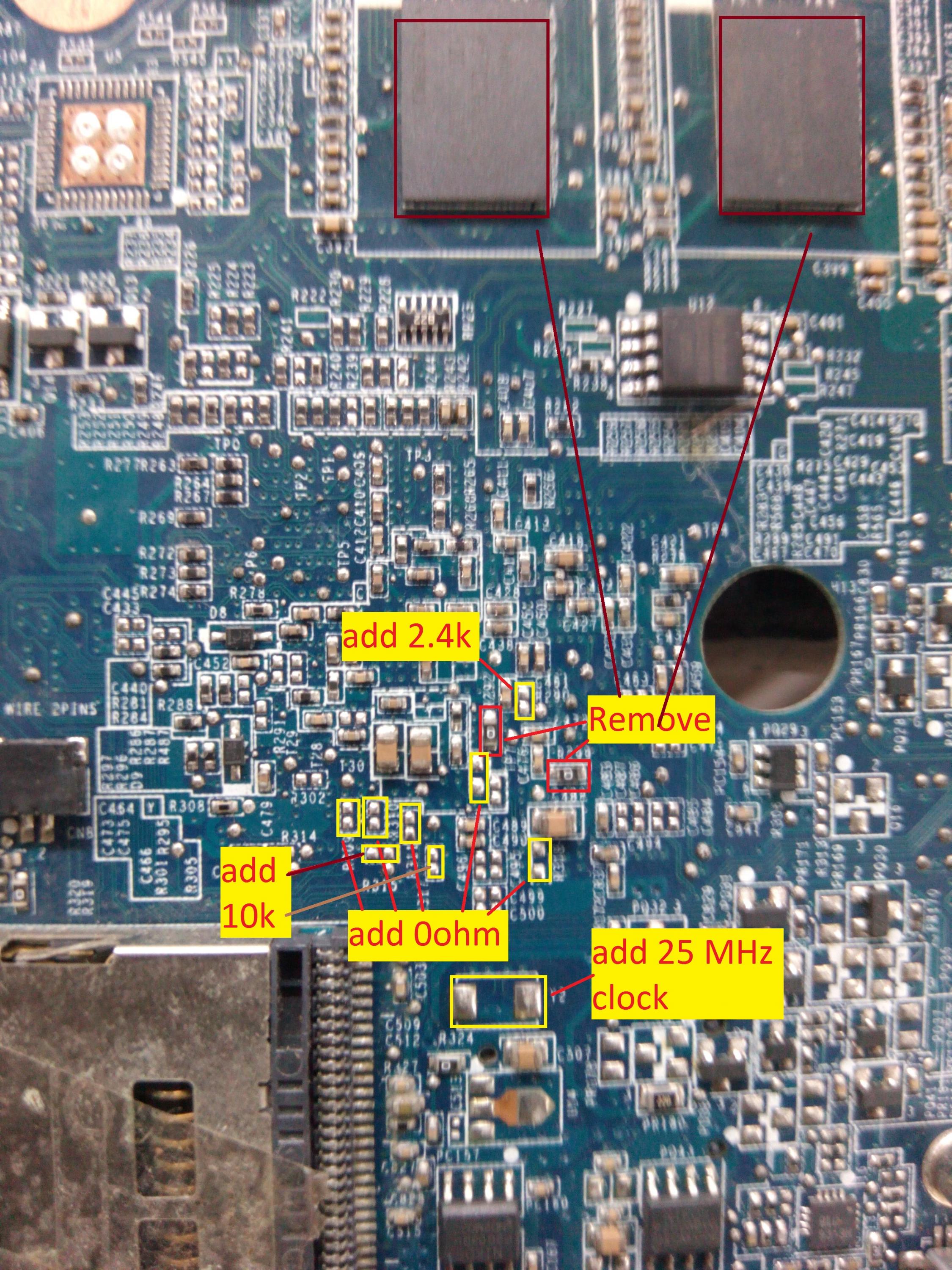

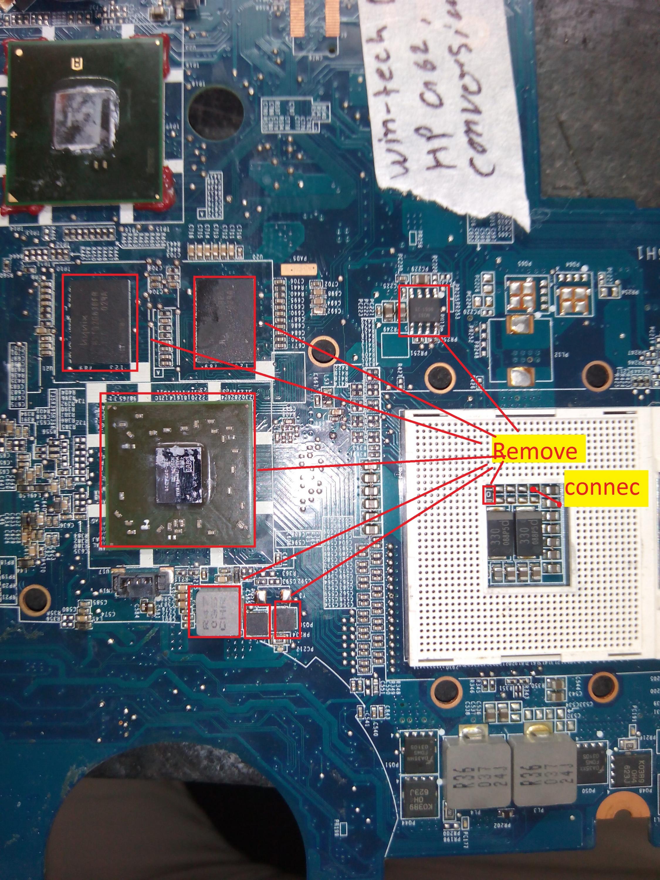

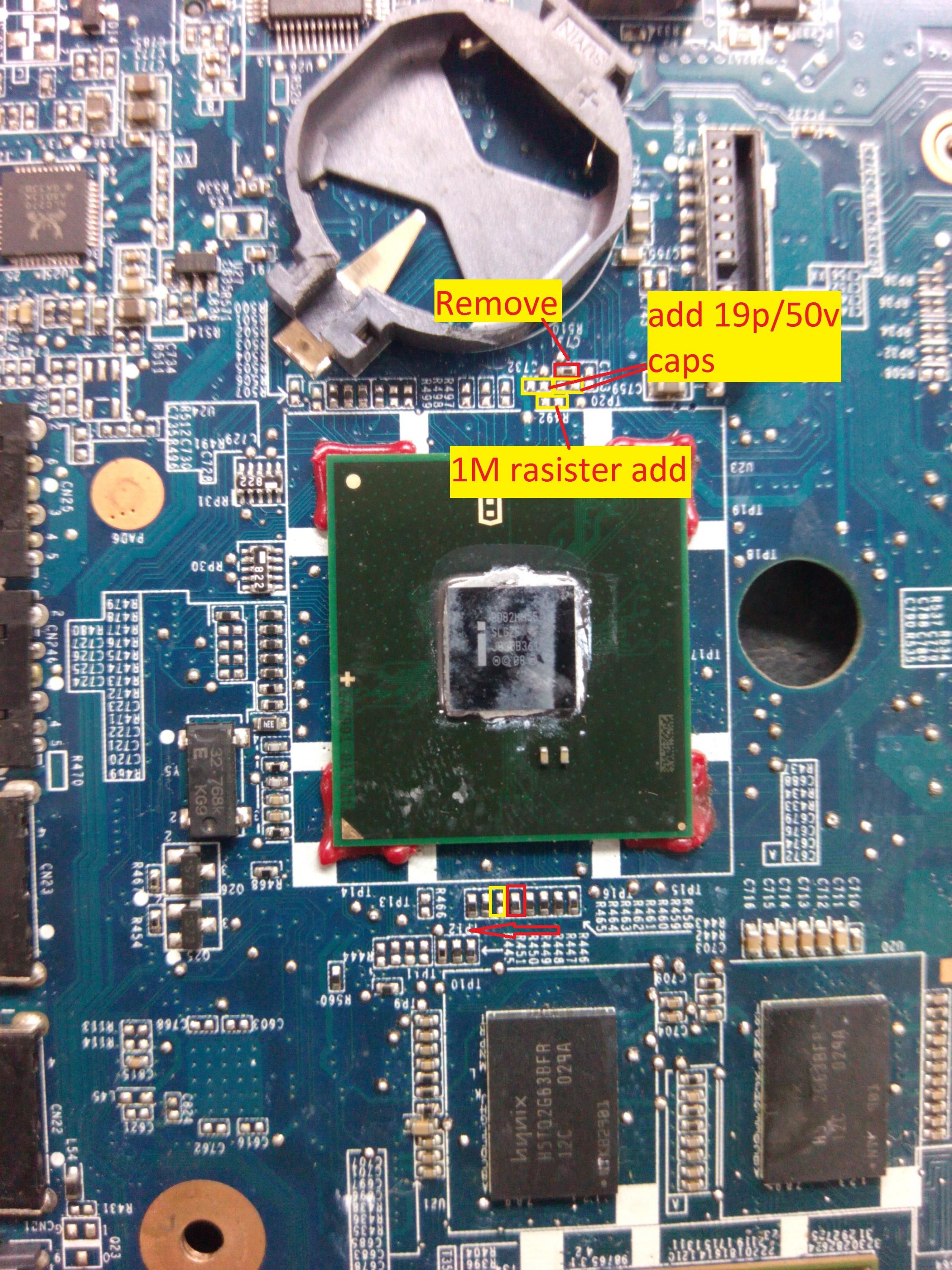

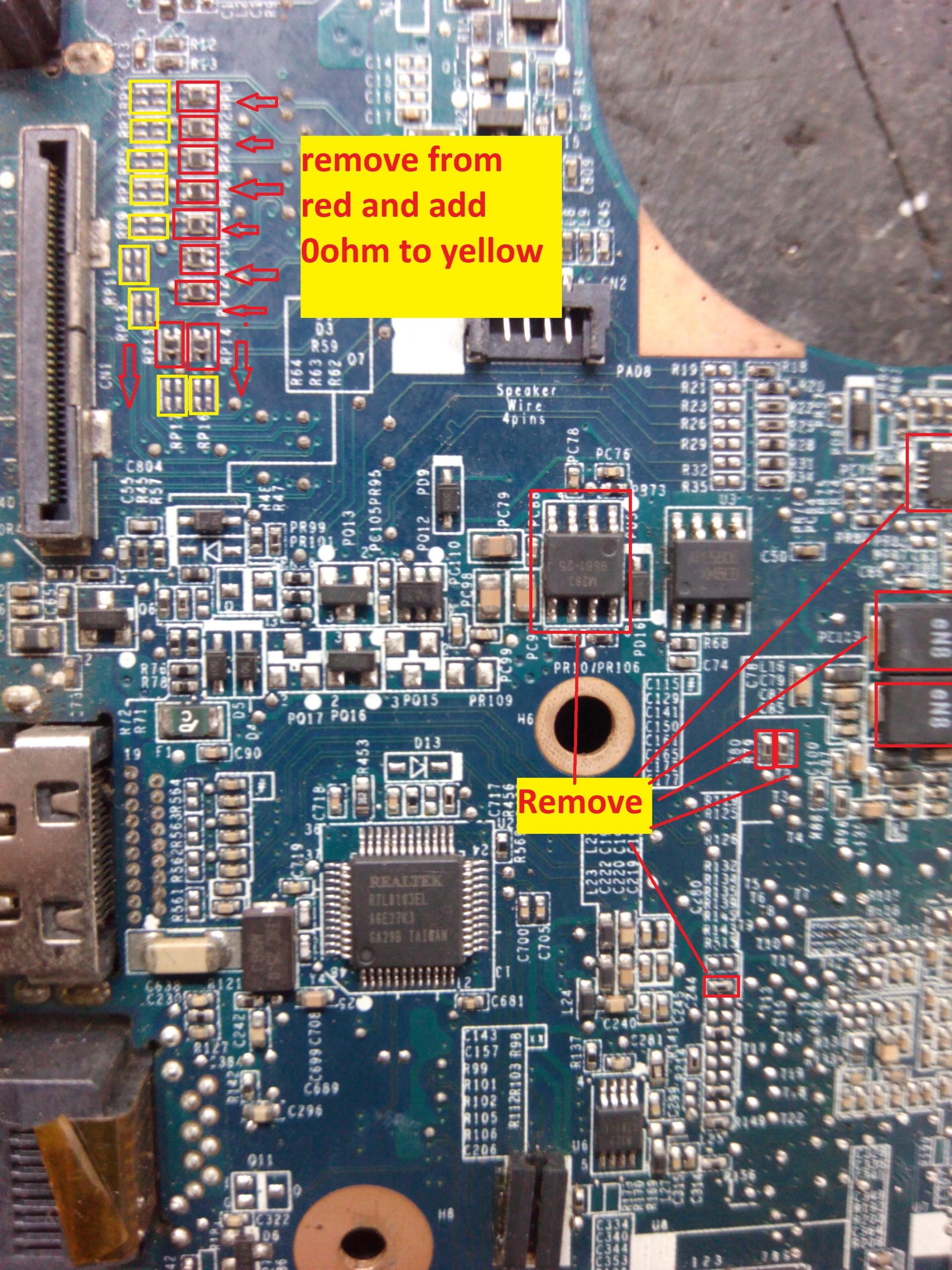

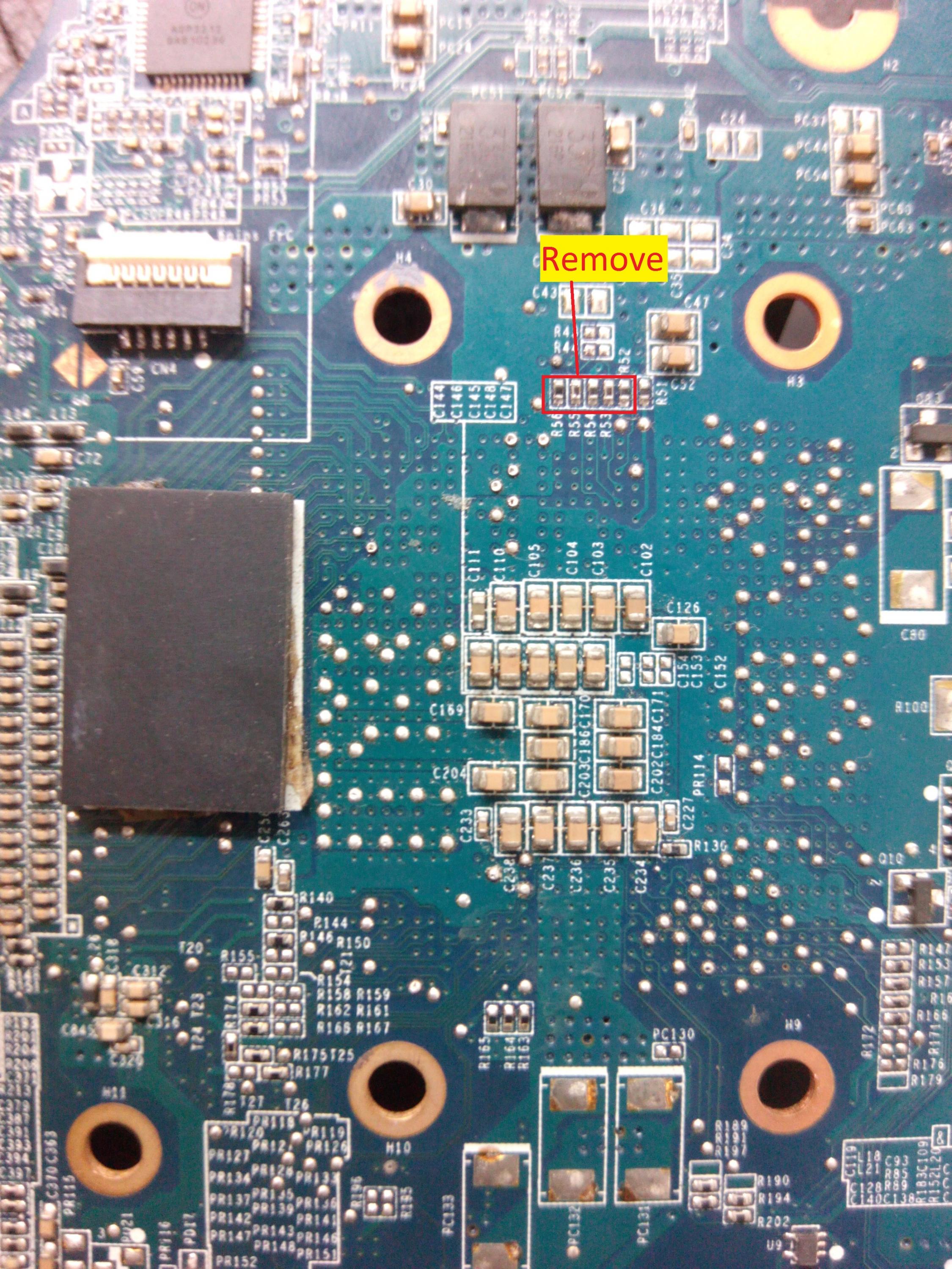

    CQ42 Discrete to UMA
    Anybody can help me to do this project?
    I already try some method but no luck. Backlight was comes out but no posting
    * Got backlight but no display
    Thanks In Advance...
  • cpt.charlie
    • Sep 2013
    • 270
    • Spain
    Re: CQ42 Discrete to UMA
    Maybe UMA systems use a different bios than discrete systems.
    • snsent
      • Nov 2010
      • 103
      • Malaysia
      maybe but my project for 4738G UMA enable is success without change BIOS...
