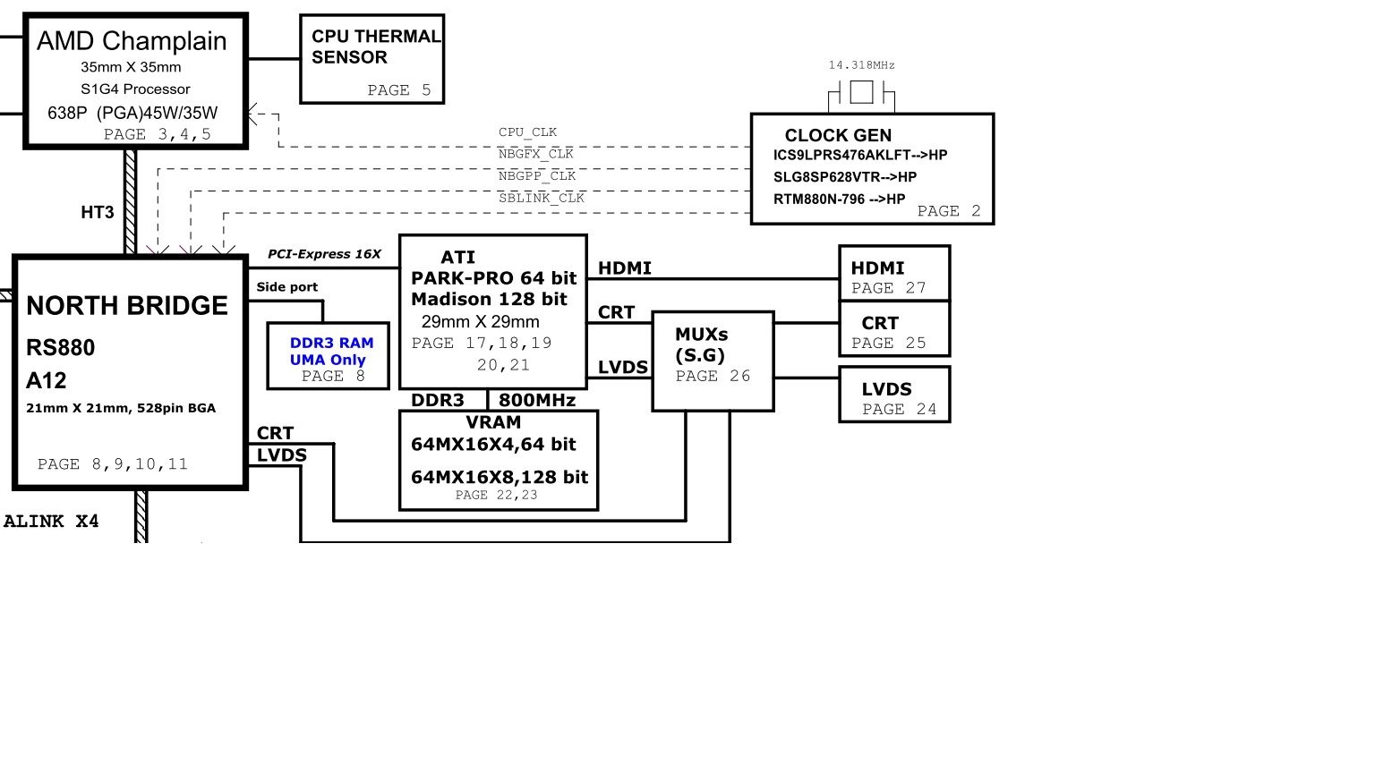

    i have hp dv7-4010sd without display. I have cpu core voltage, so i think problem is in display (gpu / gmch?).
    this laptop uses gmch and gpu for display then it is muxed?
    i don`t have LCDVDD (disp_on) on lcd connector. now i am confused and don`t know what to check. Does the display on signal coming from gmch (northbridge of gpu?) Does the gpu (ATI) only work when there is more graphic power needed?

    reflow ati chipset first that model have to much problem with him,non grafic chip
      Re: HP DV7 No display
      ok . i did a reflow but still black screen
      i see vgacore voltage is fluctuating , not stable. i measure on vgacore coil 1.0 ohm to ati gpu. i think that is to low? is there a short in ati gpu?
