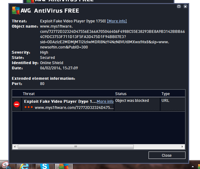

    I got, Exploit Fake Video Player. from clicking on link

      Re: HP Pavilion G7 (daor33mb6eo rev:E) and postcode 11h
      h'm, I have no problems watching videos online. I got it from the telephon's camera, file format mp4.
      Ok, attach the file on youtube
