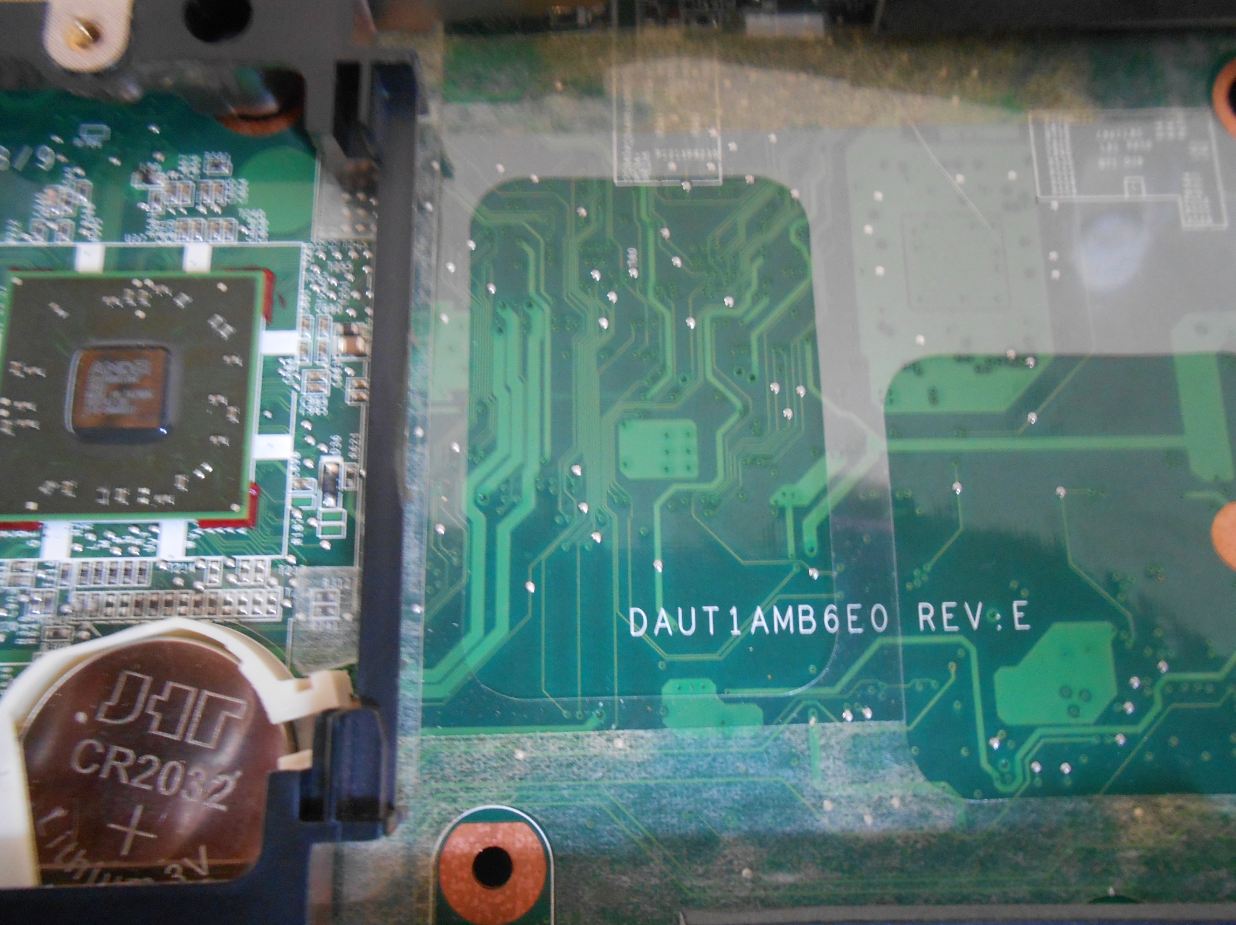

    Hi Guys
    I need a little help over here,i have a hp pavilion Dv7 3020ed,
    and the problem is that when i hit the start button, it start with a black screen,
    i have to hold the start button in untill it turn off, and start it again, and then it wil start,
    so why it start always at the second time and not at first, any body have a idea what it can be, thanks in advance.

                        I try evrything with no luck, the next step is reballing, the only problem is that i dont have the schematic for this mobo, can any one help me with this schematic, cee picture. thx

                          Re: Hp Pavilion Dv7, Start at the Second time.
                          Hi for my experience this model have problem with ATI CHIP you need to reball it or firs try to update the bios chip with programmer.
                            I think you are right, cuz Caps lock led blink 2, which it means bios, but i did update it, but did't work, the chip cold be the problem.
