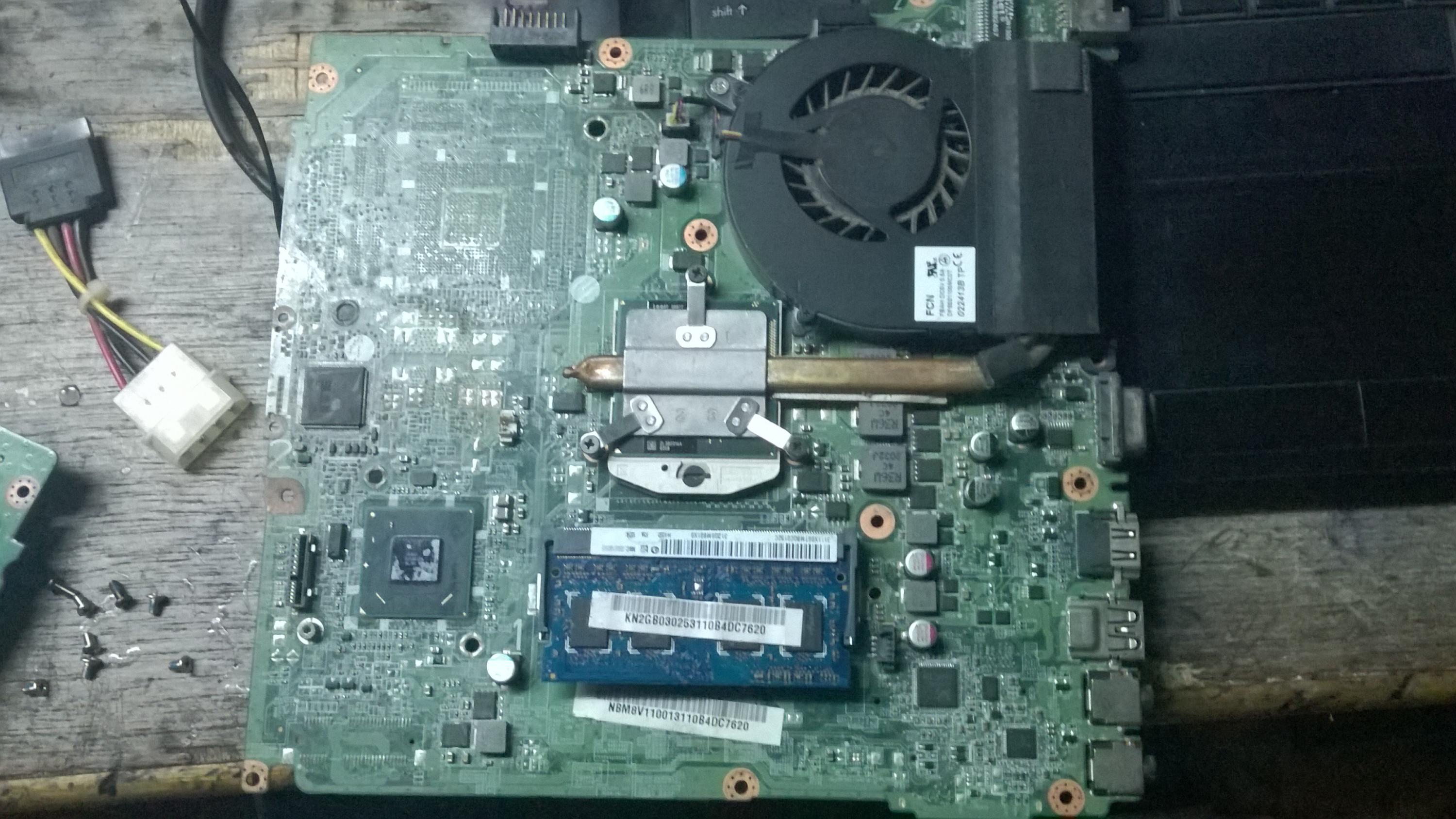

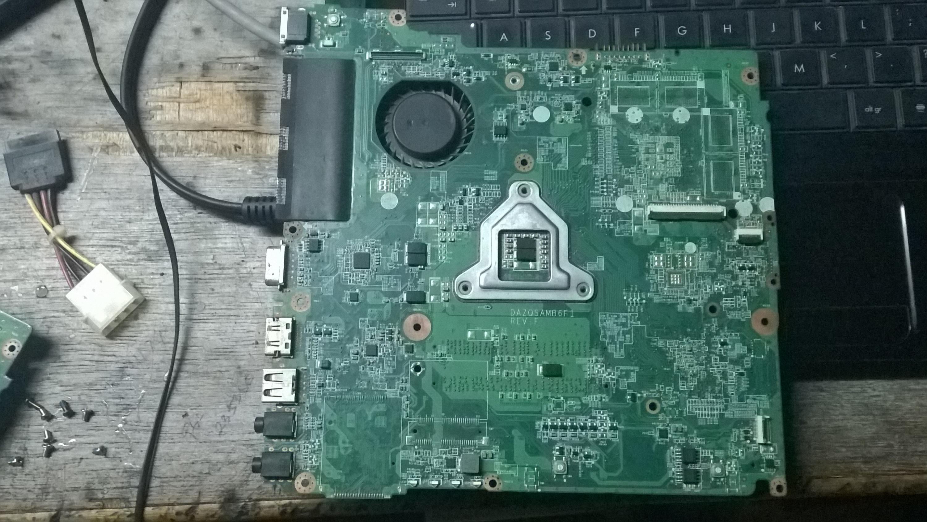

    Hi all pls help no power no charging light blinks

        Re: Acer aspire e1-431 no turn on
        Bro that board battery connector pin 3v coming ok and I /O 3v ok and bios IC 3v ok , cmos battery 3v ok, but power on switch not 3v coming
          try to replace mosfet p14A
            pls add p14a mosfet image or full number
