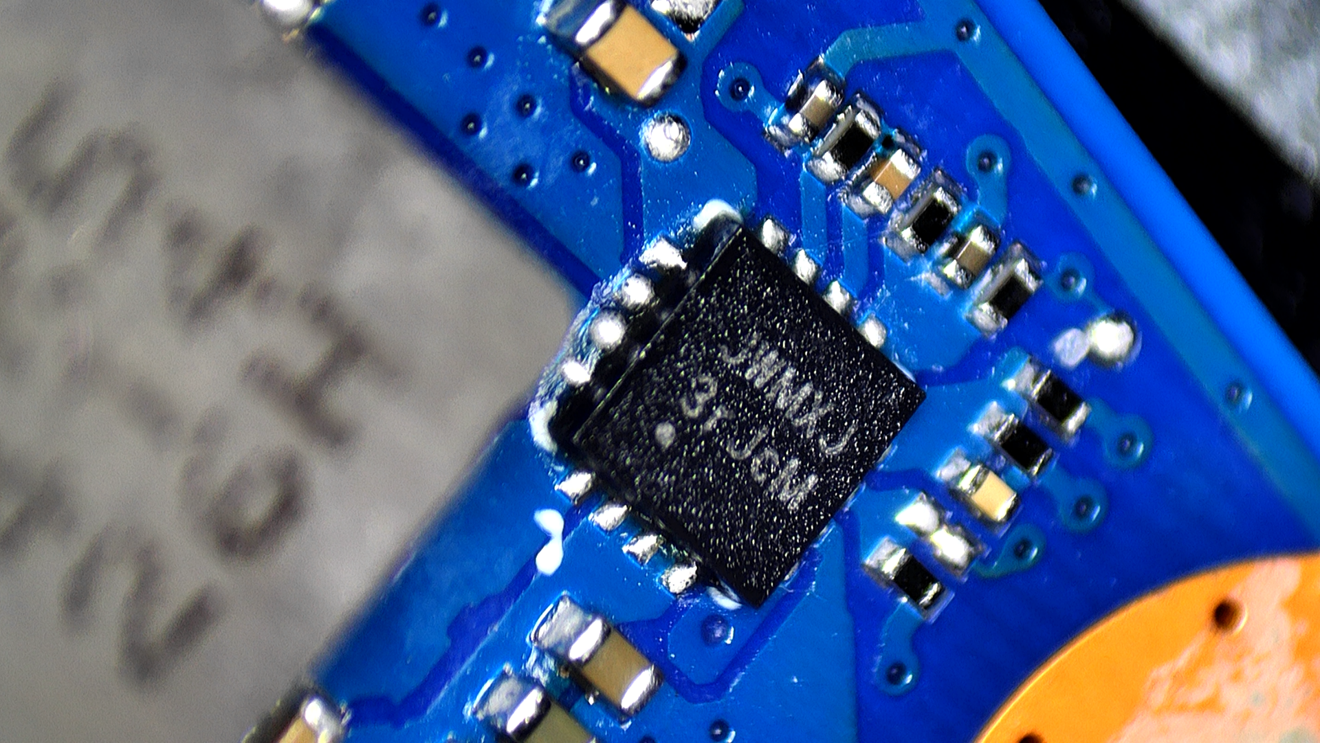

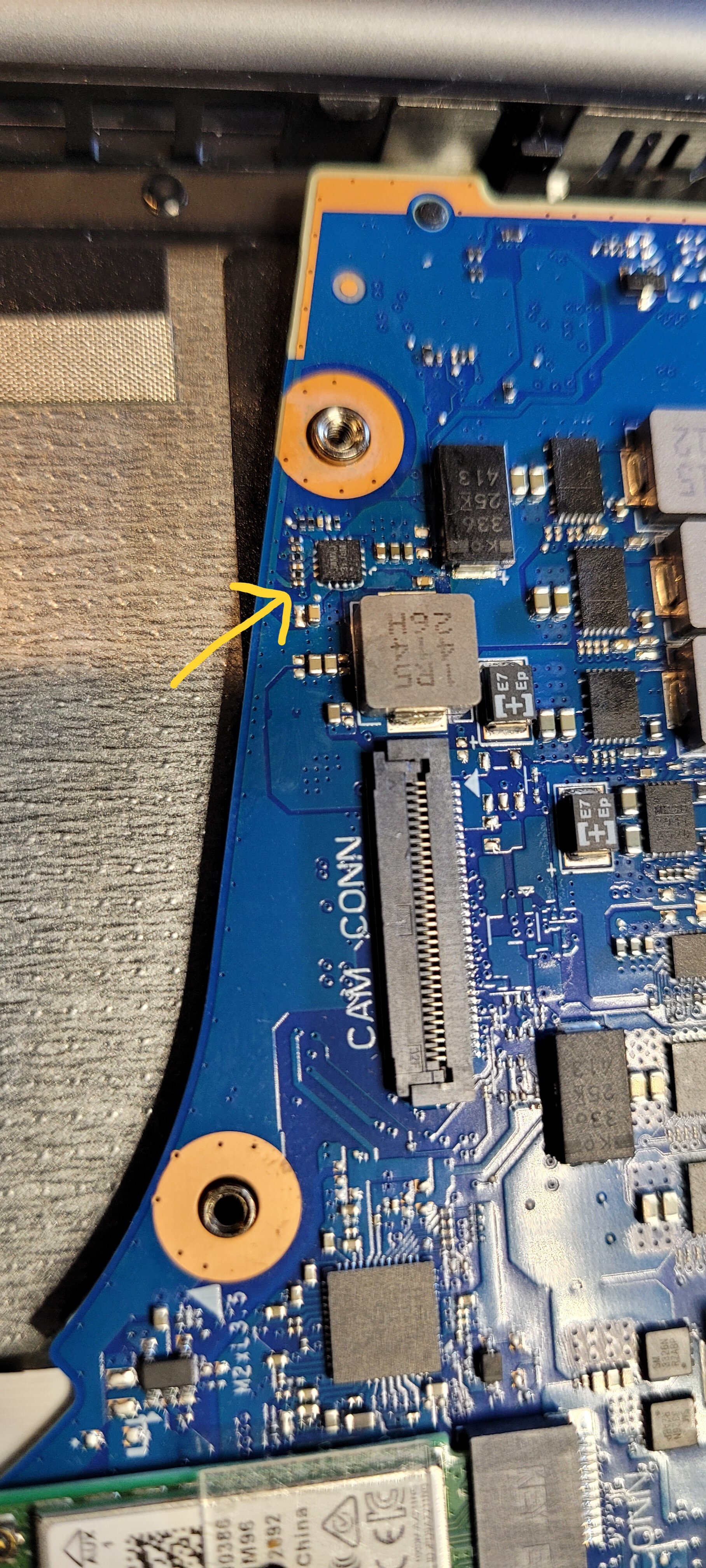

    Hello, this motherboard is flashing power button LED and not booting. I would appreciate some help with finding this IC name as its the only thing I can find having an issue on the board.
    Motherboard : NB6792A_PCB_MB_V4
    Chip marking : JWMXJ 3rJcM
    Thank you
  • mon2
    • Dec 2019
    • 14661
    Try this company:
    https://www.joulwatt.com
