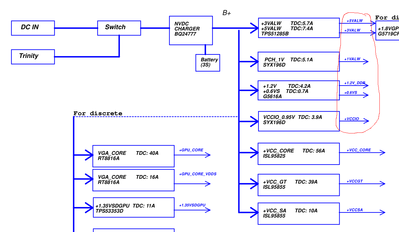

    I started going through the different voltages in the schematic for r1.0. All the voltages is marked with red are present.
    The one that is not is +VCC_CORE. I can't see anything wrong with ISL95829 (the 29 is in the PCB not the below mentioned 25).
    (I didn't measure the other voltages yet).
    Not sure how likely this one is to fail. It show no damage and doesn't give off any significant heat.
    Anyone any ideas?

      Hi man. I am a newbie at laptops repair, But if the ISL have the proper voltage input but no output............ it can be faulty. Not sure if you have a spare part to change it

        I'm wondering the same thing, but the setup with the ISL95829 and the different AOZ5029s makes it not as straight forward I think.
        Has anyone knowledge / info how this setup works (or should work)?
        Should the ISL95829 just start up VCORE if it has the correct input voltage?

          I cannot find the datasheet of ISL95829 looking for information about inputs to turn on the VCC-Core. If you can upload the image of the schematic, we can discuss together

            +VCCSA and +VCCST present or not? VR_ON? Resistance to ground of the +VCCSA power rail?
            Vcore is the very last in the sequence, and is under control of the CPU itself via SVID.

              +VCC_SA is present with 1V
              +VCCST is present with 1V
              +VCC_GT is not present

                  @reformatt yeah I saw that Vcore is controlled by the CPU itself, gives me the feeling this might really be an actual problem with the CPU...
