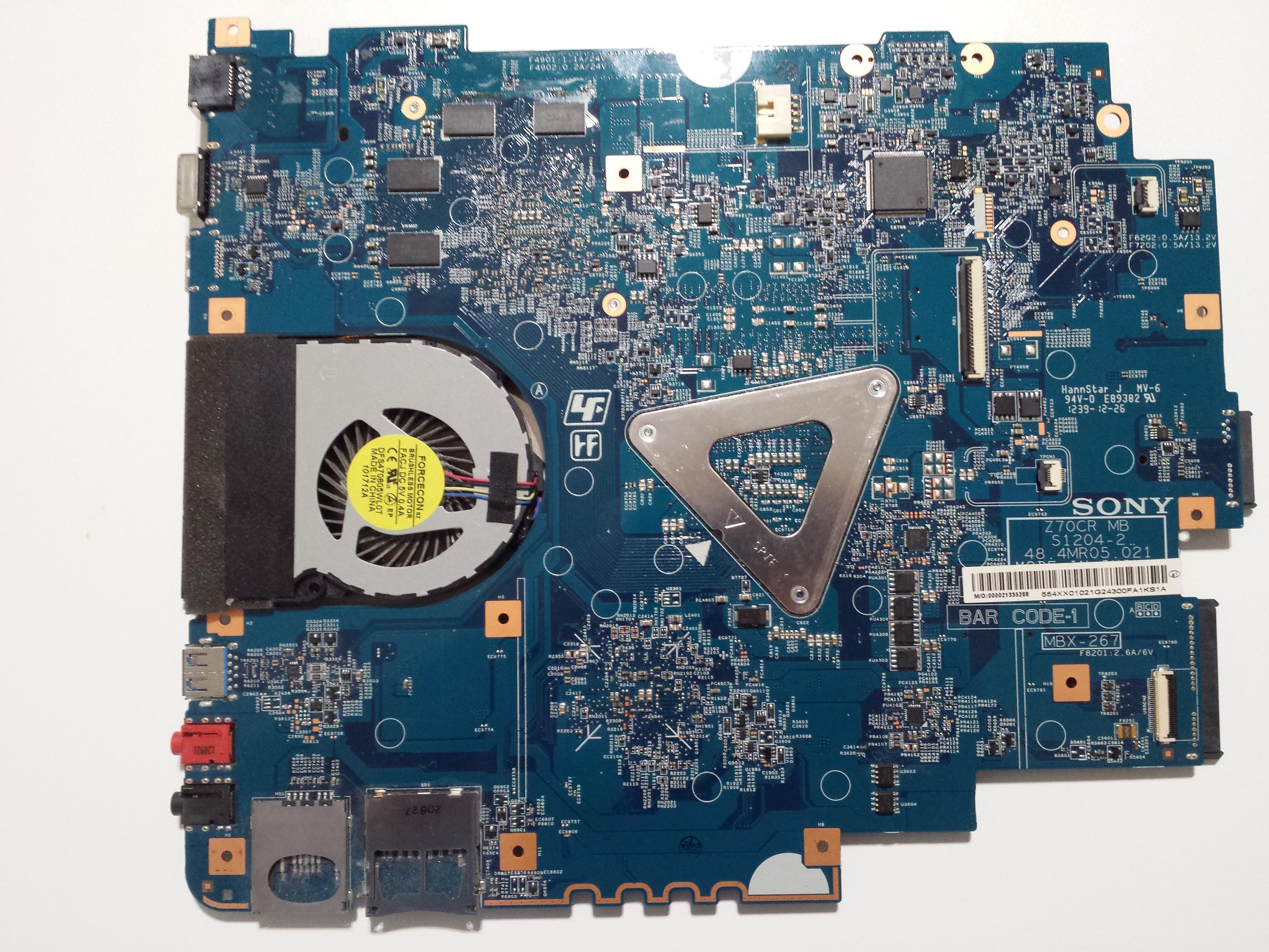

    Hi , laptop start but no screen
    after few seconds Hdd activity is here , keyboard backlight too
    and after 1mn10s laptop shut down .
    I have exchange U6001 and U6002 , change memory , cpu
    I tried to heat GPU , but nothing change.
    Fan works normally.
    What i have to check please ?
    Best regards

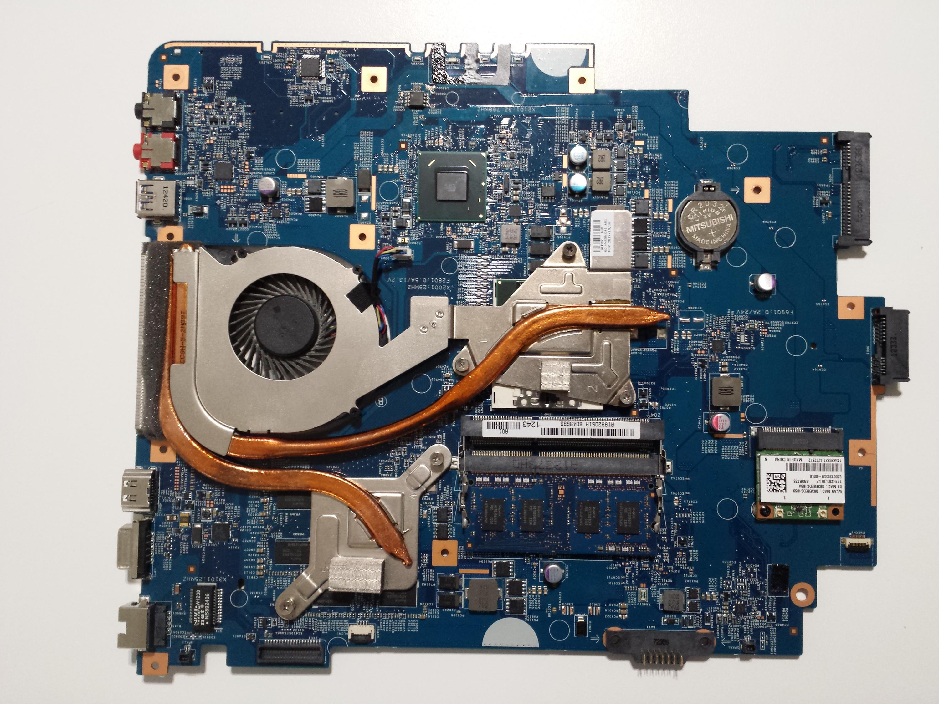

      Please, upload the mainboard picture, both side.
      • sebuncle
        • Jun 2010
        • 46
        • France
        Re: vaio sony SVE1712S1EB / (MBX267 (AMD 1go) / no screen
        Hi
        Here's photos
        Best regards

          Disconnect internal monitor and connect it to external.Try to change Rtc battery, hard drive a working one without virus. . flash bios.
          • sebuncle
            • Jun 2010
            • 46
            • France
            i have disconnect internal screen and connect to external --> nothing on external
            i have change rtc battery -> nothing change
            i have try other hard drive -> nothing change
            i have flash bios and Me --> nothing change
            Best regards

              Check if you have ec bios chip, flash that too. Check first if there's voltage running on that chip.

                Hi
                Hi , i have change ATI 216-0833002
                So screen comes laptop works.
