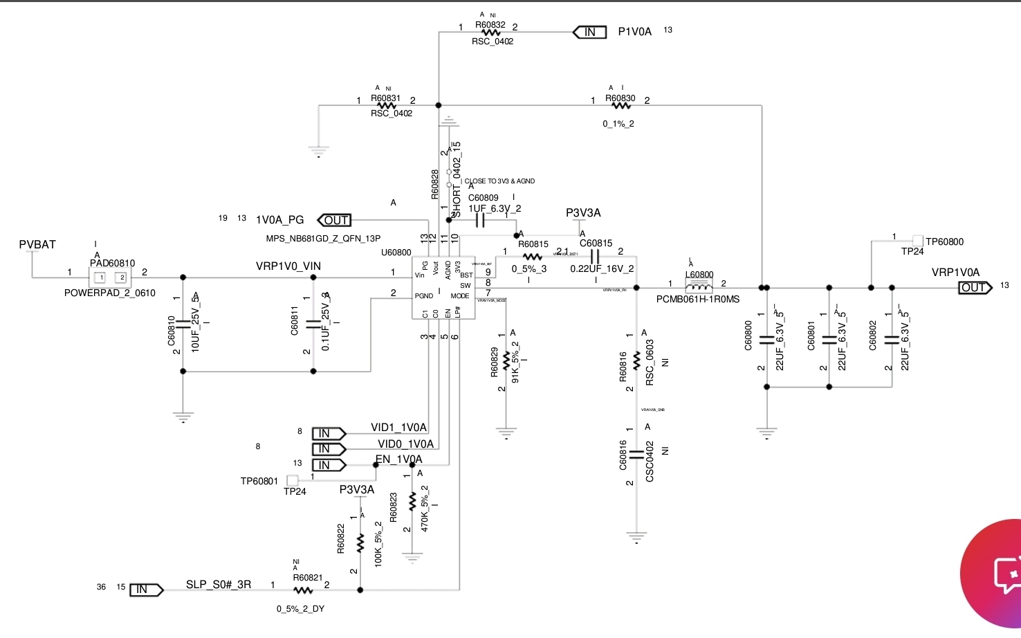

Xiaomi Mi Notebook Air 12.5 R10-6050A2789401 burnt component
  • Andri15
    • Jul 2024
    • 46
    • indonesia
    can someone help me find this burnt component?
  • Sephir0th
    • Oct 2020
    • 1289
    I could imagine it being the NB681GD-Z. As far as I can notice it's the only silkscreen code which does not match with its counter-part number on the silkscreen (U60800 instead of U60500).

      okay thank you, the only problem is I don't know the route
      • Andri15
        • Jul 2024
        • 46
        • indonesia
        where is the 12 foot path going?
