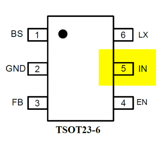

    The IC is a SOT23-6 package (with 3 legs on each side). Can you share the topside markings of this component?
    This part may be a local regulator where it takes in a higher voltage and lowers it to another power rail. If needed, pour a bit of IPA alcohol (Costco pharmacy stuff is great) - grab it from the Costco on the 401 This will enhance the markings to make them legible.

          Suspecting this part to be Silergy SY8113IADC which is a buck switching regulator (confirm the large grey inductor to the left).
          reference:
          https://www.ebay.com/itm/355757606709
          LCSC.com and Aliexpress sell these parts.
          https://lcsc.com/product-detail/DC-D...C_C479075.html

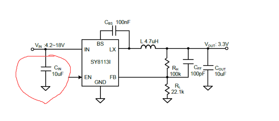

              Next, we need to study the purpose of this capacitor. By reviewing the datasheet, we can determine if the capacitor is for the input or output of the regulator.
              The removed capacitor was mated to pin #5 = INPUT pin so this was an input filter capacitor. According to the internet, the value is 10uf and the voltage rating for this capacitor should be enough to support the input voltage + a bit of overhead.

                    If you are using diode mode, the red meter probe must go to ground. The black meter probe should be to the pin to test.
                    So suggest to test with red meter probe to ground; black meter probe to the pin # 5 shown in yellow (above). This is the input rail to this regulator. Do you have a meter beep? What is the measurement on the meter in DIODE mode?

                    The capacitor being used on this board is important because you will have a high voltage as input to the regulator. Capacitors have a voltage rating that must be respected.
                    According to the Silergy datasheet, the input can be as high as 18v so as a rule of thumb, consider to use a replacement capacitor @ 25v or higher and 10uf capacitance. This is a ceramic part with no polarity so can be soldered in either direction.
