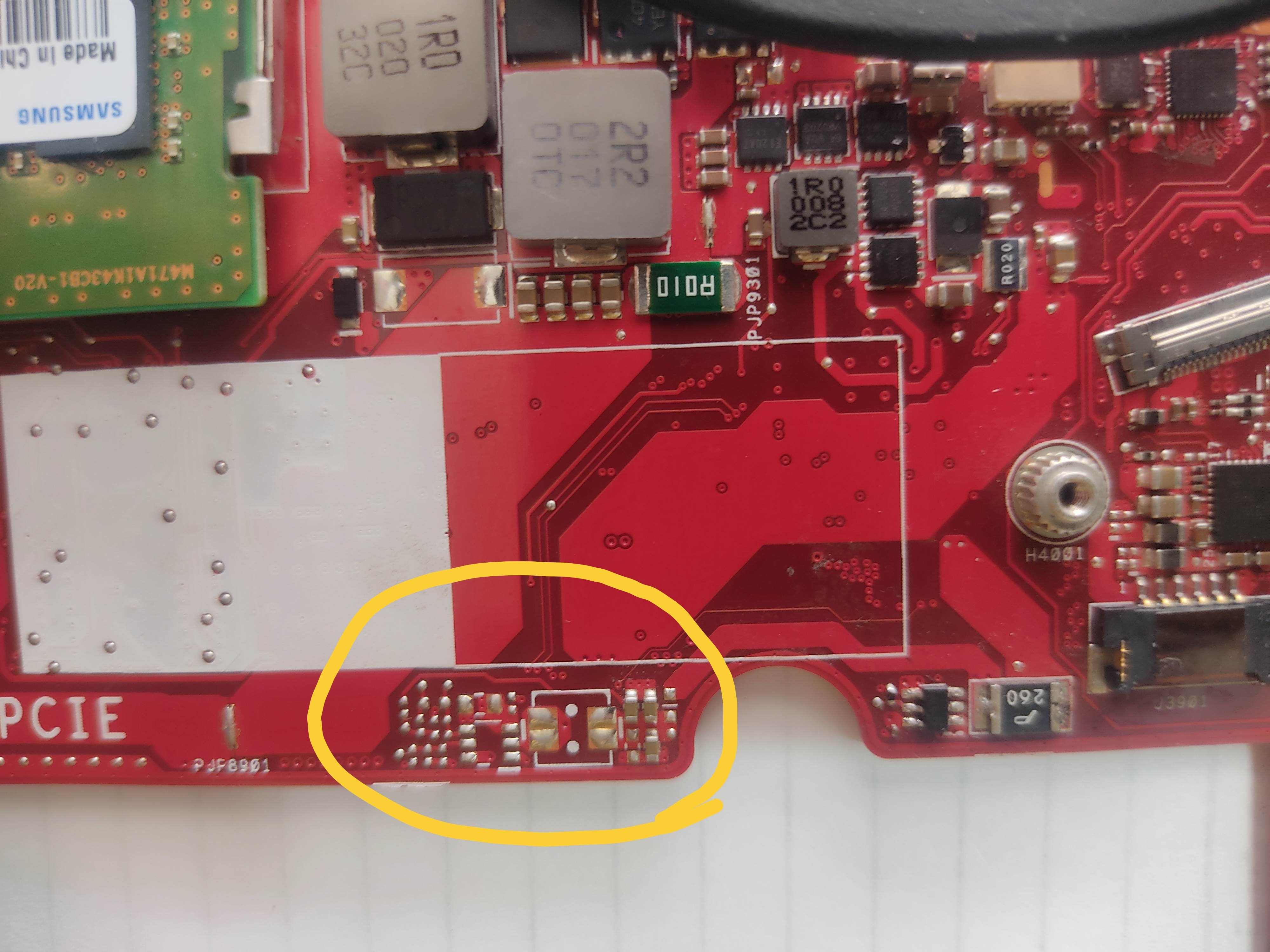

    Dont work LCD display Asus zephyrus s15 gx502
    Hello Friends
    I have an asus zephurus s15 gx502 laptop, unfortunately I don't have a display on the laptop LCD, but it works fine on the hdmi
    This happened when the battery socket was damaged during removal.
    Now the voltages I have are as follows
    +3VS_LCD_OC is activated at the moment of turning on the system and quickly turns off
    And on the pins
    LCD_BLEN_CON
    LCD_PWM_CON
    I have no voltage even at the moment of starting.
    In addition, the LCD cable is also healthyโ€‹

    Link schematic if available.

        PU8501-volatge on all pins after power button press?
        Resistance to GND on pin 6 of PU8501(No power attached).
        U4503,pin1-Resistance to GND?
        • b.rakhshani70
          • Feb 2020
          • 11
          • iran
          There is no pu8501 in my pcb
          I have attached a photo of it for you
          However, the voltage of its pins is as follows:
          1= 0V
          2= 0V
          3= 20V
          4= 0V
          5= 0V
          6= 0V
          Resistance of pin 6 to ground = open circuit
          Resistance of pin 1 in u4503 to ground = 10Mฮฉ and increasingโ€‹
          • b.rakhshani70
            • Feb 2020
            • 11
            • iran
            Picture of PCB
