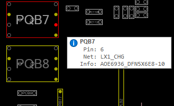

    History: I was using the machine as normal when it suddenly switched off and never came back on. I've owned the machine for over a year and use a Dell Thunderbolt Dock to charge my laptop with. This was connected along with a USB SSD when it stopped working. No water ingress, I keep the fans and grills meticulously clean. I use a genuine Dell 130W PSU into the Dell Dock.
    I want to learn as well as fix this machine, but im not sure if I've handled the diagnostics and repair in the correct order. Someone has uploaded a boardview on Badcaps forum recently, credits go to them but I have posted it here if it helps for reference. I should mention from the beginning that I have replaced ISL9241HRTZ and the EC as I wasn't getting certain voltages. I regret replacing the EC without asking for help first, but I have the original EC still...it just needs reballing if I need to resolder it..
    I decided that looking at the charging circuit was the best place to start. Measurements taken with USB-C PD charger connected and battery disconnected.

    I think I can take away a few things from this.
    1) SDA_CHG and SCL_CHG should be at 3.3v, otherwise it most likely wont communicate to the battery or the EC.
    2) LX1_CHG and LX1_CHG look abnormal at 1.62v. I replaced two dual N channel posfets Is it safe to inject 20v here?
