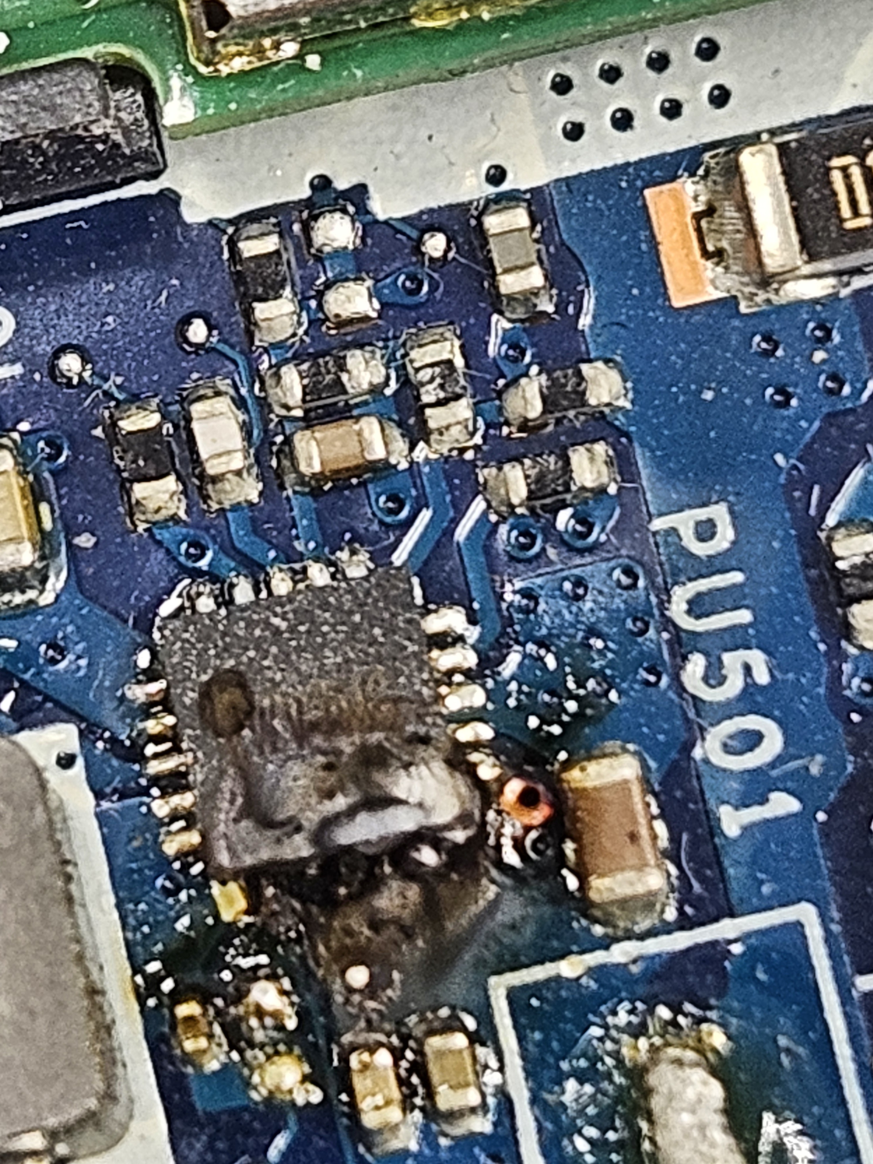

    This Yoga 720-15IKB (board LA-E552P) has a burned PU501 IC. As there is no schematic or board view, I am guessing that it is some kind of step-down converter for some rail, maybe 3.3v? I can not read the markings to find a replacement.

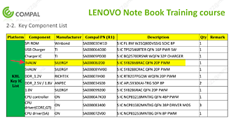

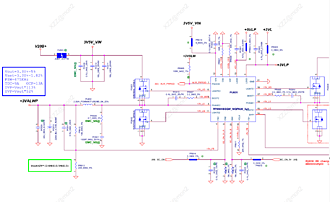

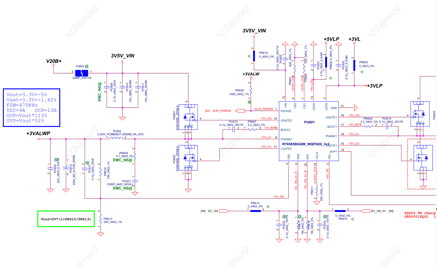

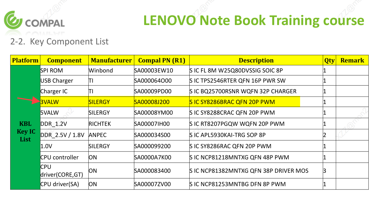

    From another Yoga model, believe it is PU601 on the other board.
    RT6585BGQW_WQFN20_3x3
    SY8286BRAC ; may be a drop in replacement for the above - confirm it
