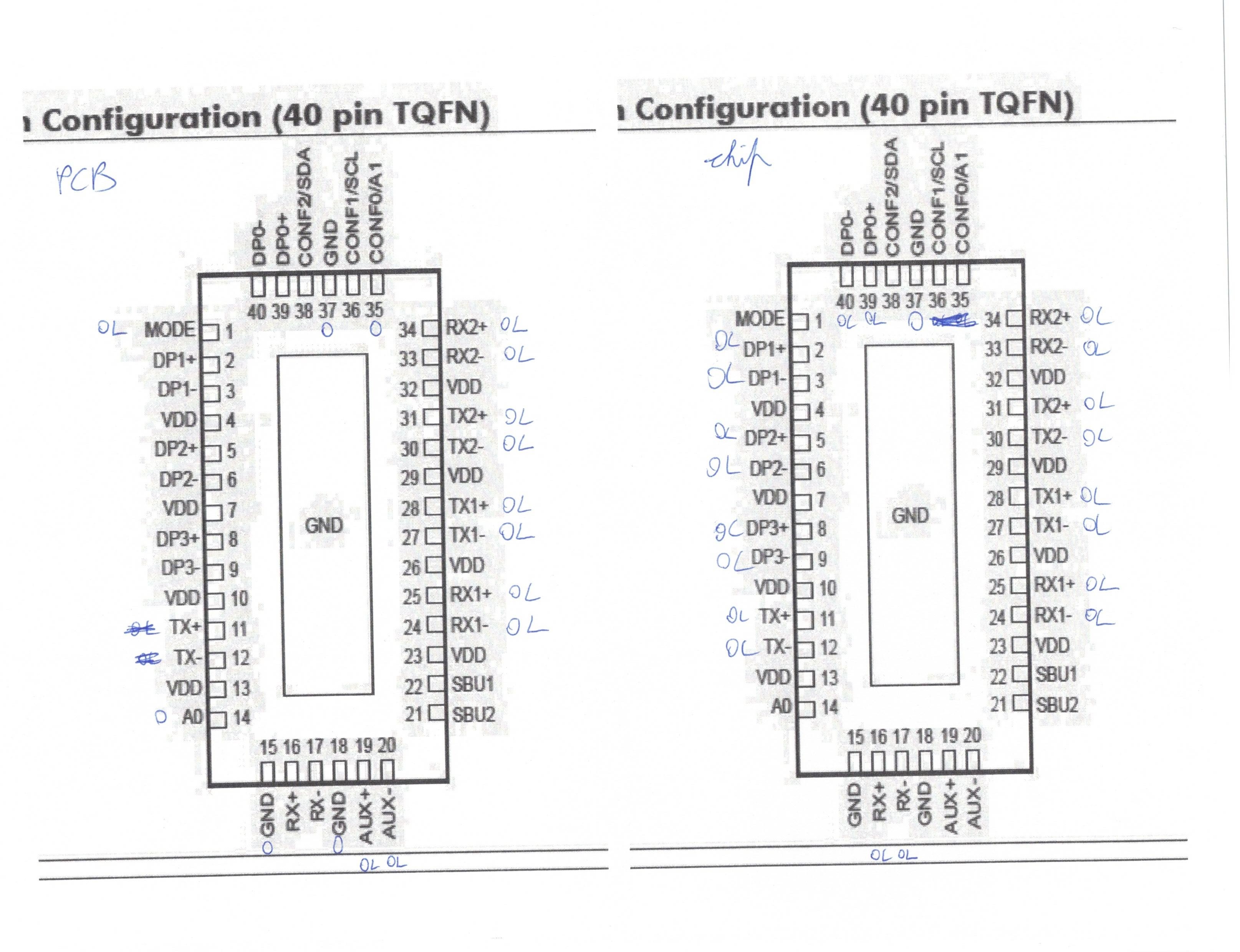

    PI3USB30532ZLE is a MUX (multiplexer) that will steer the full USB connections to either target A or target B, based on the select pin. Suggest to download the datasheet for this component. Then remove all power, meter in diode mode.
    Red meter probe to ground. Black meter probe to the pin to test. Test each pin of this MUX to confirm that the pin is not shorted (ie. there will be a low voltage measurement in DIODE mode if shorted) and also not 'open / floating' = OL on the meter during the same method of testing. Only wanting to confirm this MUX is soldered in properly. Otherwise, the USB connections from the physical connector are not reaching the logic board.
      Ok, will do.
      Low voltage as of below 0.2V? So if I get OL, it means the pin was not solder properly?

        Correct. Low voltage would be something even lower and close to 0v. This will imply a shorted pin inside the device under test.

          I measured the chip PI3USB30532ZLE and got lots of OL. I think it is the flux. So I removed the chip and measure on the PCB and the chip separately. The result is in the attached picture.
          I removed the STM32F chip at the same time. So the measurement is taken with both chips off the PCB.
          When you combine the 2 readings, it is suppose to get AD pin short, and RX2, TX2, TX1, RX1 at OL.
          Is that something to be expected? Is the CONFO/A1 pin abnormal shorting to ground on the PCB?
          It seems like CONF0 and CONF1 together switch between the 3 modes. So may be it is normal.

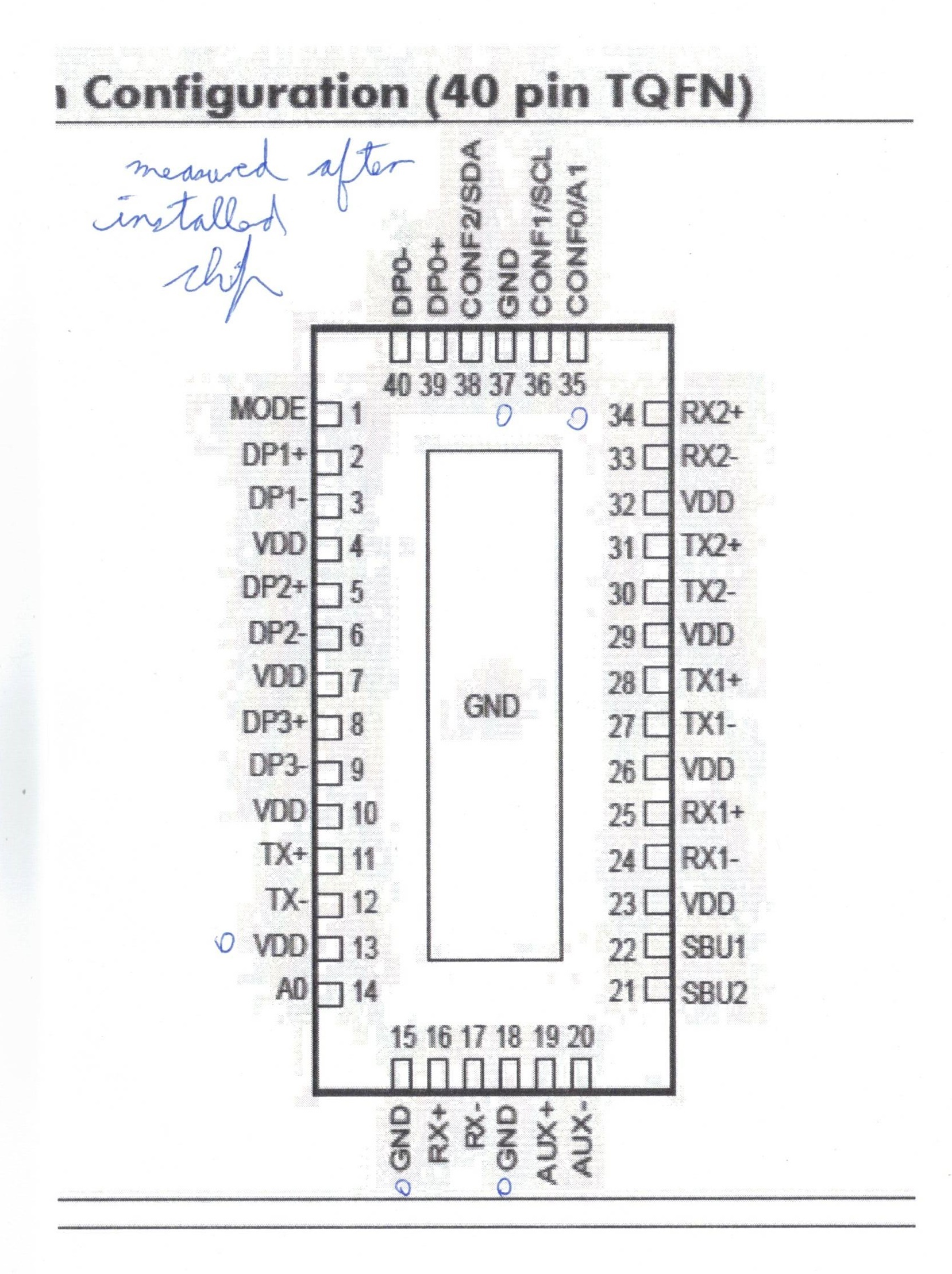

            Ok I measured again after installing the chip, the result was not as expected.
            One of the VCC measured 0V while the other VCC has a number.
            I would think all the Vcc pins are connected, but it seems that it is not. I wonder if it is shorted to ground when I solder it on?
            Update: I measured it again and it shows a value on that pin. I must have measured it wrong last time.
            Everything seems normal from the reading.

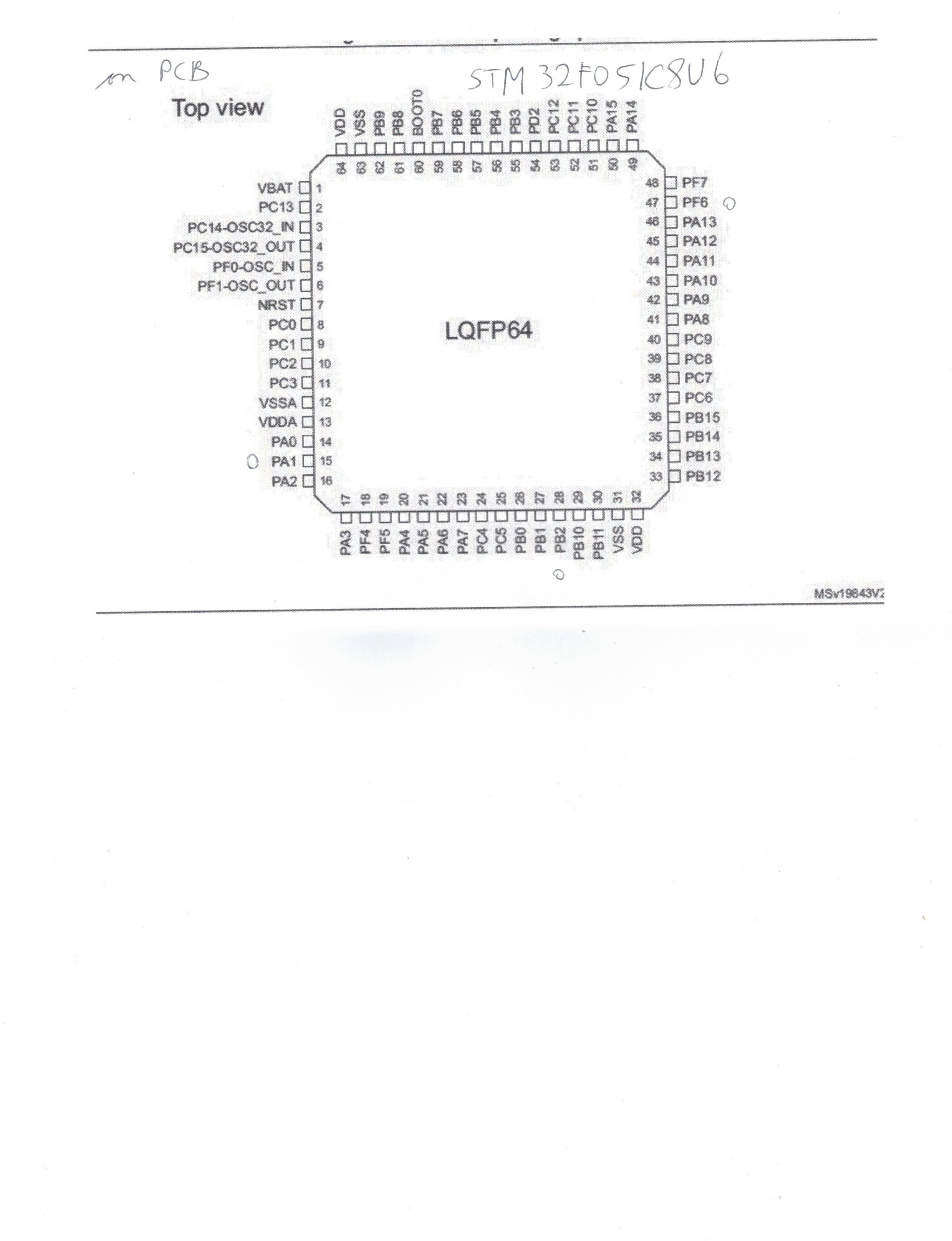

              I installed the STM32 and measured the pins too.
              There are a few pins that are 0V but no OL.

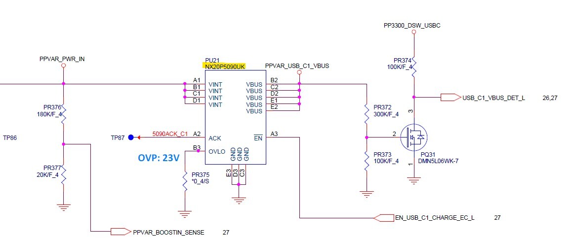

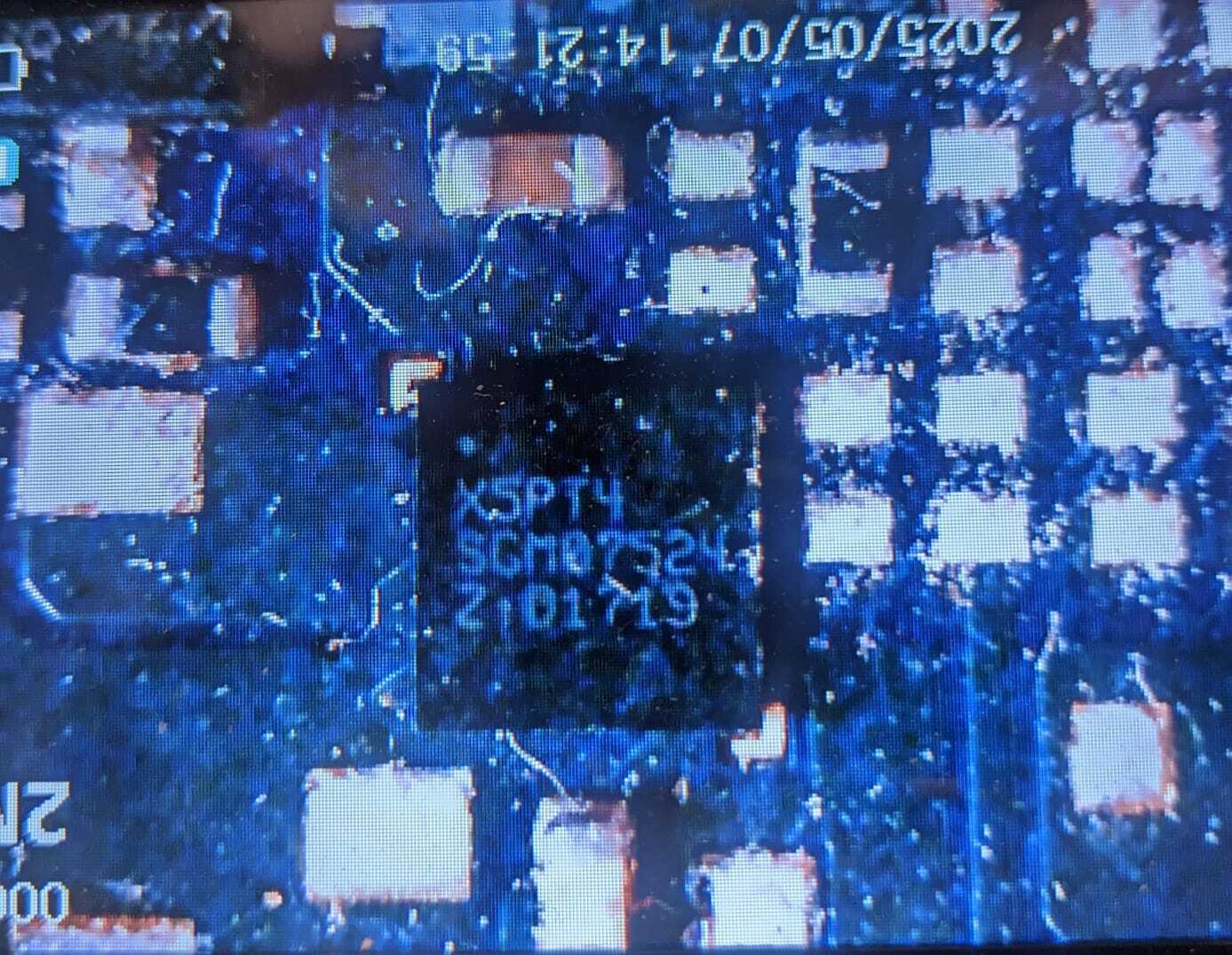

                  #48
                  I finally have it figured out!
                  I traced the VBUS line from the USBC port and looking at the schematic from another laptop, I found the USB PD and Type-C current-limited power switch X5PT4 from the picture which is similar to NX20P5090UK from the schematic.
                  The V out pin from this chip is directly connected to the VBUS pin on USBC port.
                  This is a bga chip so I had to remove it in order to get access to the pin. With the USB stick inserted, I measured the Vin pin and 5V is present. I then measured the EN pin and it is 3.3V. This chip is active high so that means the gate is closed and Vout should have 5V. But so far I got 0V so this chip must have been fried.
                  I took the same chip from a scrap board and reballed it. It is a bit challenging since the grids are small, but I eventually got it done. After replacing the chip, with the USB stick plugged in, I measured VCC pin at 5V!
                  I then booted up the machine properly and it can finally detect the USB stick!
                  I then test the PD charger and VCC charges at 20V instead of getting stuck at 5V like before. I think this USBC port is fixed.
                  However, when I test the other port, the Vcc is still at 0V. I think the same chip from the other side is also fried. But now I know what to do!
