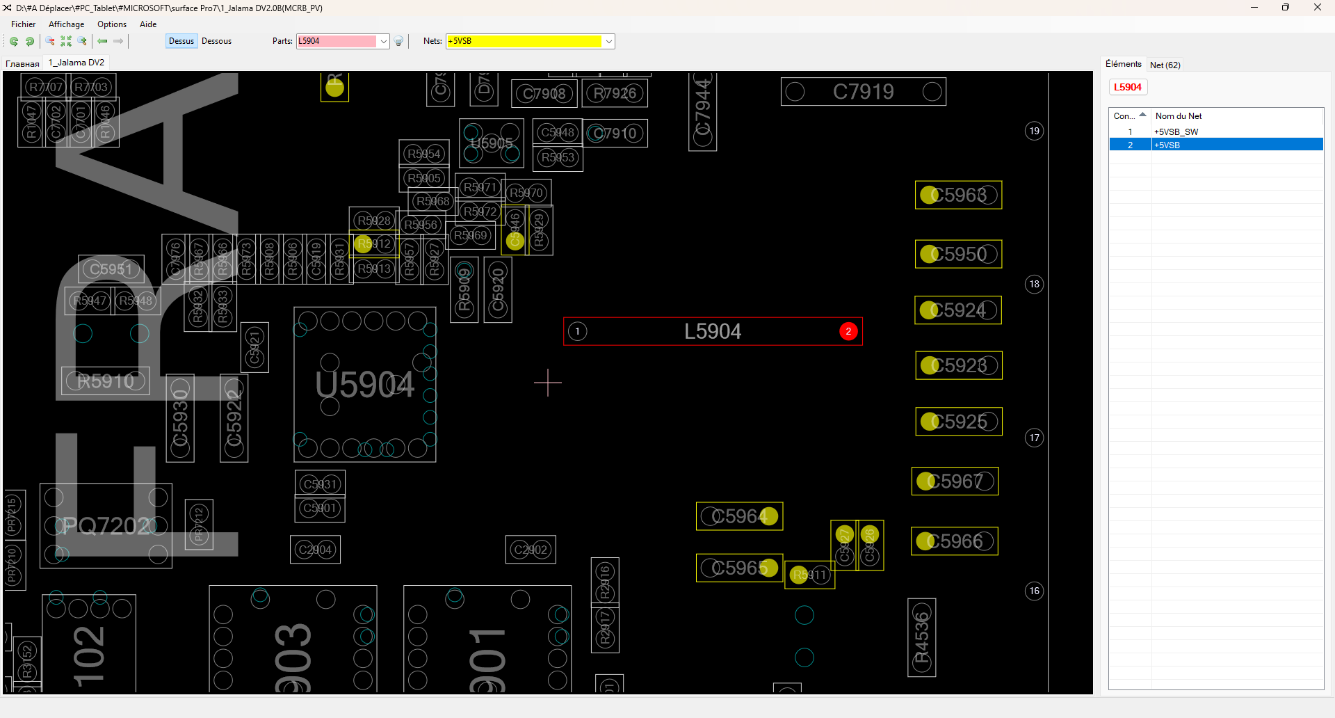

            If you mean the Pin#15 (of the U5904) I have 0V when the DC is plugged led power on.
            I read it from the capacitor C5919 as there nothing else related to this pin.
            On the board the R5908, R5906 are not populated, only the C5919 is present and did not find short to ground (1.2MOhms without power supply).
            Don't hesitate to ask me other measurement (it wil take time as I will be at work all the week).

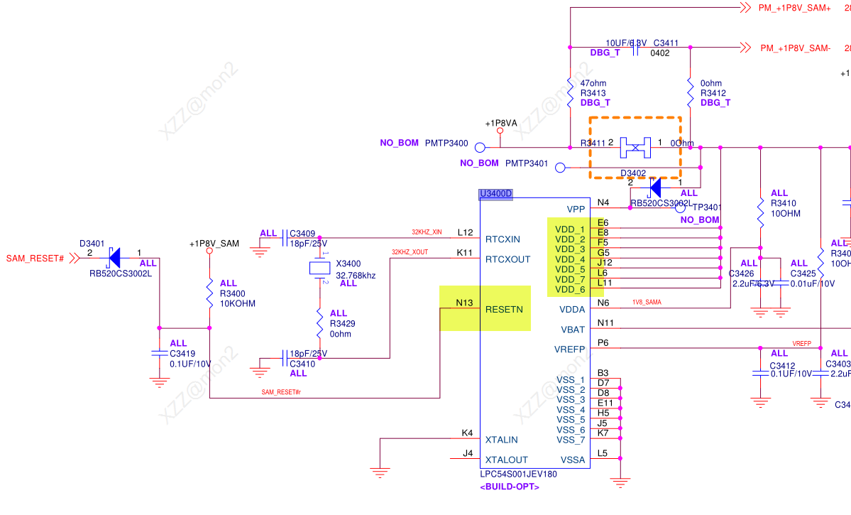

              This enable pin and others are being driven by a NXP ARM Cortex M4 microprocessor @ U3400D = LPC5400. Review the U3400D block of pins and confirm that this part is being powered. Test their voltage to ground.
              • titomno2
                • Aug 2020
                • 103
                • France
                Hard for me but I think I have the information (the boardview and schematic are not easy to understand).
                So measured voltage at pin 1 of the R3411 and read 1.788V so I assume VDD are OK.
                Measured also SAM_RESET#R on C3419 pin 1 and read 1.783V so I assume RESETN is OK.
                So I assume the NXP ARM Cortex M4 is powered.
                It is quite painful to find area to check the value without touching the shield.
                SL1_HPD2_EN = 0V
                3P3V_HDP_EN = 3V
                3P3V_HDP_VIN = 3.3V

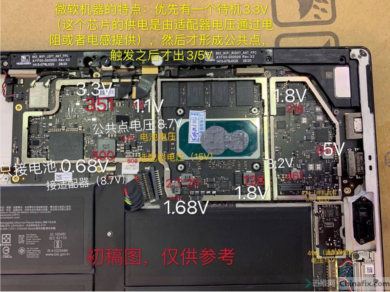

                  See if this helps. The voltage to ground are listed for each inductor on this model.
                  The values in RED are diode mode measurements. Remove all power. Meter in DIODE mode. Red meter probe, yes red to ground. Black probe to the point to test.
                  • titomno2
                    • Aug 2020
                    • 103
                    • France
                    Very instructive. So with red probe on the ground and multimeter on diode mode here are the results:
                    Voltage Picture On my board
                    0.68V 500 523
                    3.3V 351 406
                    1.1V 23 0 (giving 1.400 and drop to 0 real flat)
                    8.7V 625 680
                    8.7V 508 577
                    1.68V 25 91
                    1.8V 128 257
                    8.2V 461 493
                    5V 369 402
                    1.8V 218 298
                    So, should I apply a low voltage on the coil 1.1V to find any cap getting hot ?
                    • mon2
                      • Dec 2019
                      • 14691
                      Indeed, this rail appears to be shorted. Let us confirm another way. Remove all power. Meter in resistance mode this time. Measure the resistance to ground on either side of this same inductor. What is the resistance in ohms?
                      Hoping that you have only a shorted capacitor onboard. The next logical step will be to consider the voltage injection as you have noted. Keep the voltage low - suggest 0v8 to 1v0 (max). Being a hard short, the shorted part will crack / heat up quickly. If you have a thermal camera, the part will offer a throbbing thermal signature. Alternatively, you can pour IPA on parts suspected to be the defective and shorted. The IPA will evaporate quickly with the heat from the voltage injection.
