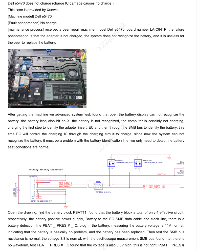

    dell latitude e5470 not charging

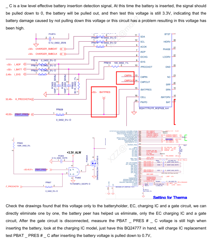

    this laptop no have 12v on pbatt1, but it should right?...i have another dell laptop different model and it has 12v on pbatt...i found this schematic and boardview is not for e5470 but the marking is same...ive try bypass PSID but no luck, still not charging
    LINK to schematic & boardview --> https://www.badcaps.net/forum/troubl...bv#post1671359

    Attached.

      thank you sir...i see that the problem is from pbat_pres#_c is not pulled down to 0v and he change the charging ic right....but mine it does pulled down to 0v when i inserting the battery...or i should try to replace the charging ic also?...because if so,i have to order the ic first since i dont have bq24777 ic right now

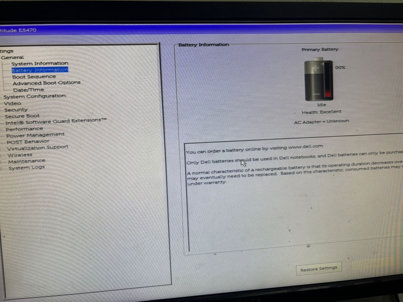

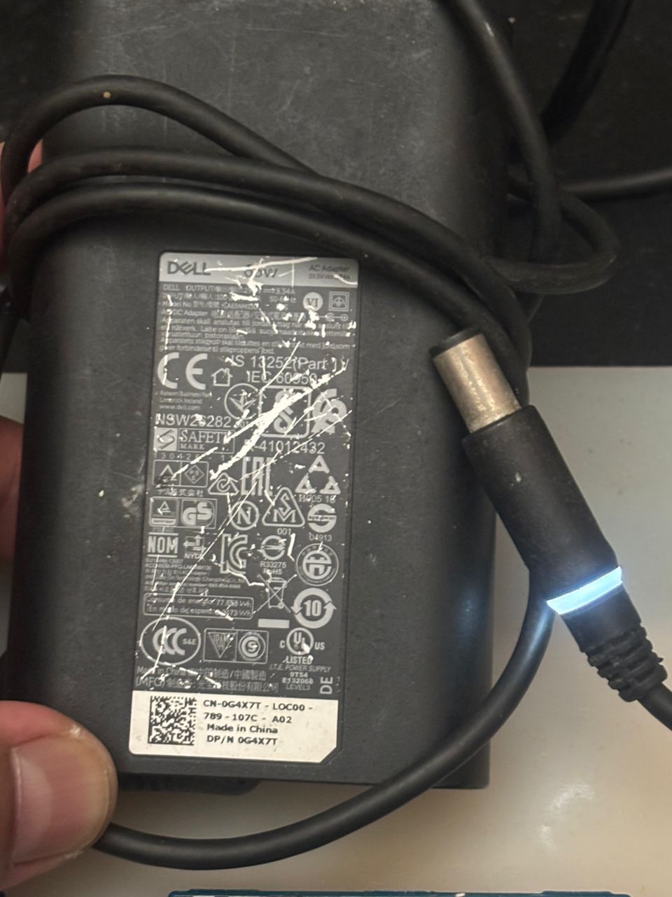

          yes laptop does power on with adapter...even im using dell adapter it saying adapter Unknown...perhaps adapter is not original maybe?

            Issue is with the PSID since the adapter details cannot be properly detected.
            Attach the power adapter, what is the voltage to ground on PL4 (either side is ok). This voltage must be ~3 volts. Respectively, this same contact must be able to mate with the center needle like pin of the adapter connector. Confirm that this center pin is not bent on the power adapter. Confirm this pin is able to mate with the motherboard's power connector.
            Is the power adapter a known good model that functions with another Dell ok? If not, source a known good adapter for testing. When the PSID is not functioning as it should, the motherboard speed will be throttled and the battery charging function will halt.

                  0v on PL4 sir...im using dc power supply and also this adapter...seem like original...i try this adapter on other dell laptop its charging normally

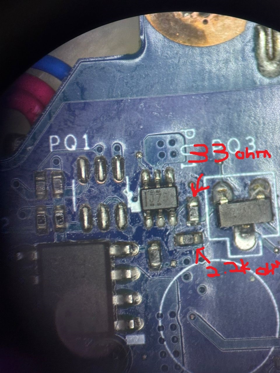

                        Confirm the voltage on resistor PR6. Test both pins to ground.
                        Also test the resistance across PR6. No power during resistance checking.
                        • dqtech
                          Badcaps
                          • Jul 2018
                          • 630
                          • N/A

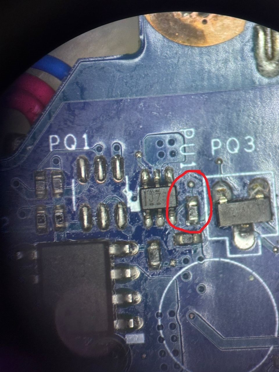

                          this is PR6...resistance test got 33ohm....and 0 voltage on both side sir

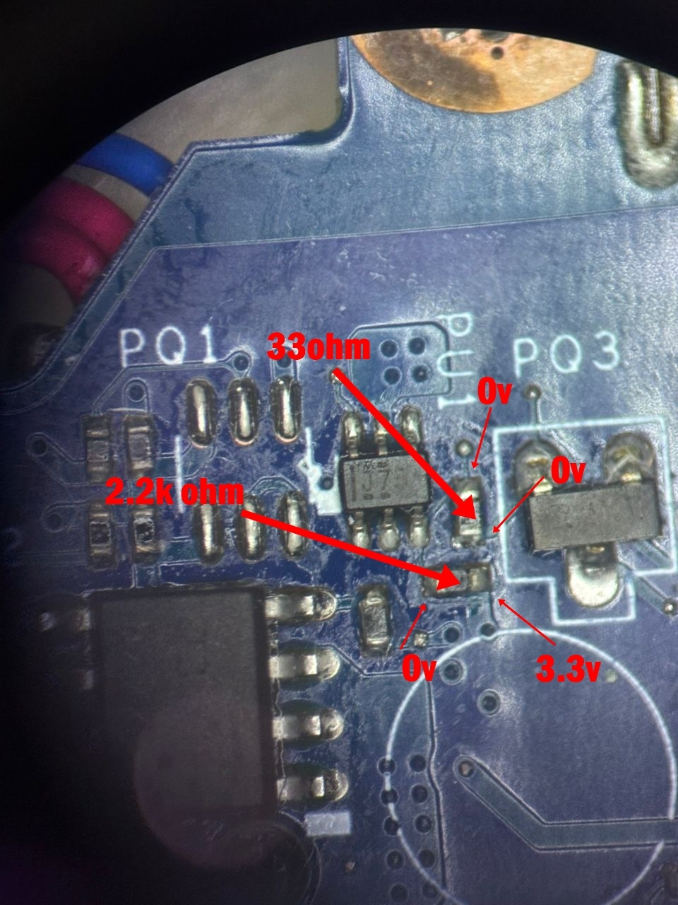

                            No. PR6 is 33 ohms. PR7 should be 2k2 ohms. You must also have the +3v3_ALW rail present.
                            • dqtech
                              Badcaps
                              • Jul 2018
                              • 630
                              • N/A
                              yes sir...its PR6...33 ohm ...0 voltage on both side
                              • dqtech
                                Badcaps
                                • Jul 2018
                                • 630
                                • N/A
                                like this sir
                                • mon2
                                  • Dec 2019
                                  • 14148
                                  Someone is pulling this line low.
                                  Remove all power. Measure the resistance to ground on PL4. If there is a low resistance, then most likely, the ESD transient device @ PD6 = PESD5V0U2BT has triggered and is shunting this signal line. Then you must flux and remove PD6 and test again.
                                  If the resistance is ok on this line, continue..
                                  With the power adapter connected, measure the voltage to ground on each pin of PQ3.
                                  Carefully, also measure the voltage on each pin of PU1 switch. We need to confirm that this switch is being powered on pin # 5 with +5V_ALW. Confirm the voltage to ground on pin # 4 = PS_ID from the EC.
                                  The EC is the bus master that is driving this 1-wire interface.

                                    "Remove all power. Measure the resistance to ground on PL4. If there is a low resistance, then most likely, the ESD transient device @ PD6 = PESD5V0U2BT has triggered and is shunting this signal line. Then you must flux and remove PD6 and test again."
                                    with PD6, resistance to ground on PL4 is = 41 Ohm
                                    without PD6 = 110K ohm
                                    • dqtech
                                      Badcaps
                                      • Jul 2018
                                      • 630
                                      • N/A

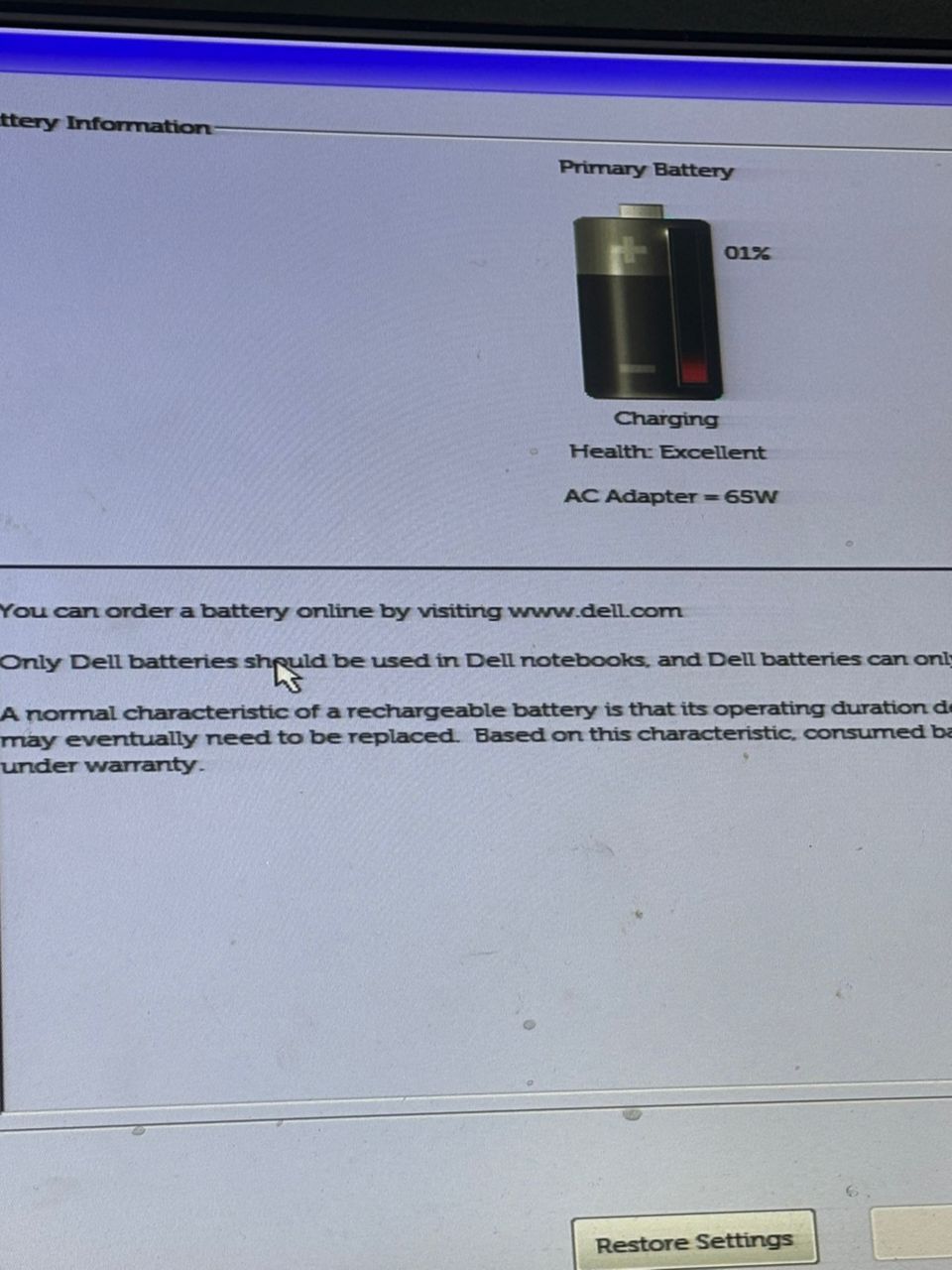

                                      thank you so much sir mon2 ....everything working fine after PD6 replacement
                                      • mon2
                                        • Dec 2019
                                        • 14148
                                        Well done!
                                        While the product will work ok without PD6, it is a good idea to install another PD6 onto the board. This part is used to suppress higher than 5 volt signals to ground. This is a safety crowbar part that will enable only if the signal voltage is too high to protect other parts from damage. The part is passive (out of circuit) unless the voltage is higher than the trigger voltage of this TVS diode.
                                        Good case closure!
