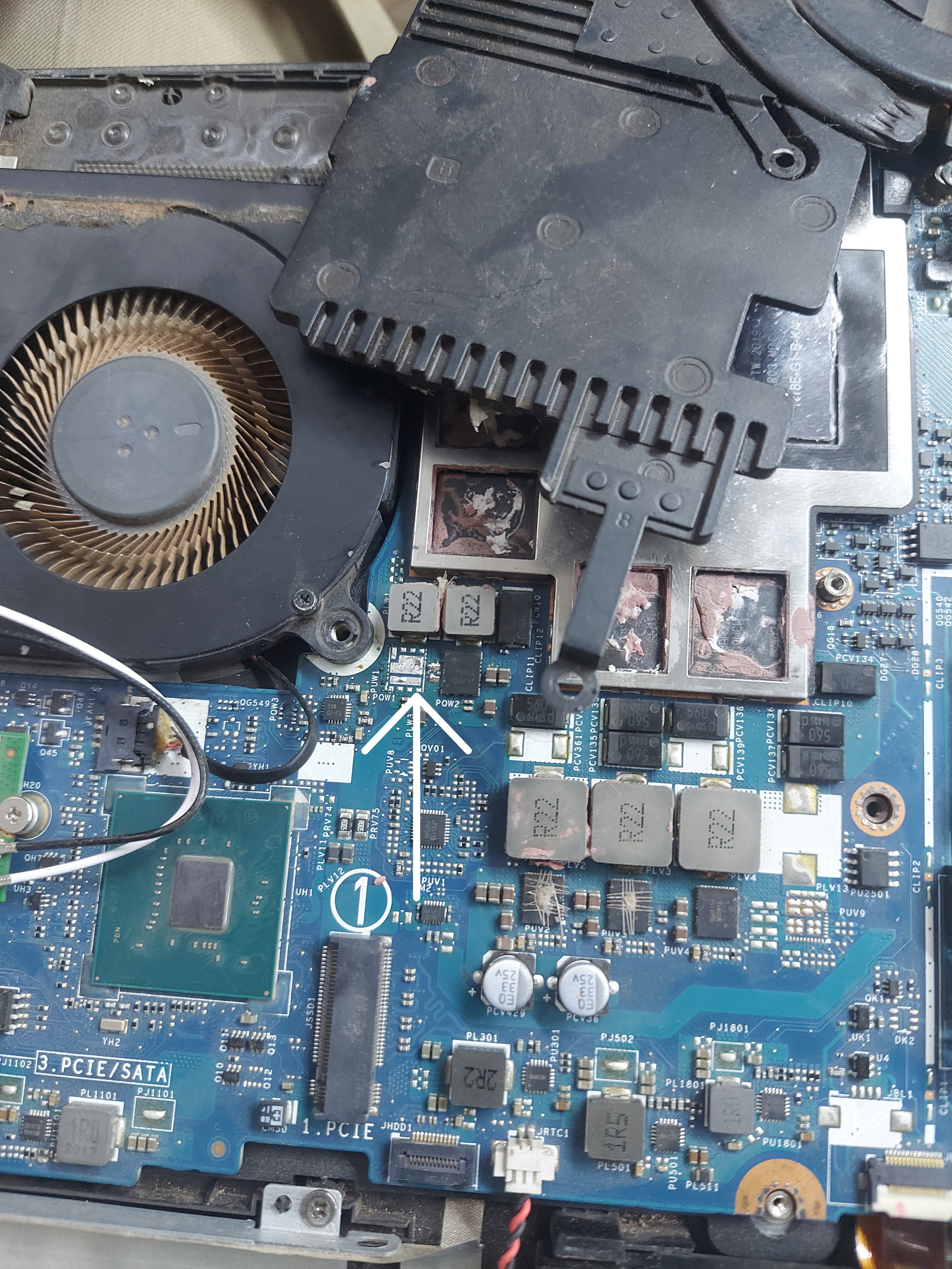

    I try to fix this motherboard no power missing 19v
    the first DCIN PQB11 mosfet receiveide 19v in drain.
    the test i have done :
    Mosfet PQB11 and PQB12 check and change still have no power
    Charging IC PUB1 check step:
    -VCC pin 28 = 19V
    -ACDET pin 6 =2,62V
    -REGN pin 24 = 6V
    -CMSRC pin 3 = 0V
    At this step i replaced IC but still problem no voltage in gate on 2 dcin mosfet
    What i missing?
    the schematic in below
    I use Rev:0.1 schematique and boardview

    Does your logic board also have stuffed the mosfets @ PQB18, PQB19, PQB3? Each is a suspect.
    Best to test each of these DCin mosfets using resistance mode. Remove all power. Meter in resistance mode.
    Measure the resistance across each mosfet:
    source / drain
    source / gate
    gate / drain
    Each measurement must be in hundreds of K ohms or higher else could be defective / leaky.
    Without power, measure the resistance to ground of the main power rail @ ACN / ACP on the charger IC. If this rail is too low of a resistance then the charger IC will detect this fault using the ACN / ACP pins and will turn off the DCin mosfets by keeping ACDRV low / 0 volts. ACDRV must be ~25v to enable the DCin mosfets.
    Post each measurement. As a quick test, you can remove the above noted mosfets to check if ACDRV returns to a normal value of ~25 volts.

      Thank for suppor, ok i understand in futur i avoid it
      No PQB18 and PQB19
      Mesure resitances of each mosfet:
      Calibre: 600K
      -PQB11
      source / drain :576 K
      source / gate :591K
      gate / drain :105K
      -PQB12
      source / drain :107 K
      source / gate :107
      gate / drain :
      -PQB3
      source / drain : OL
      source / gate : OL
      gate / drain : OL
      Circuit charger IC mesurement without power:
      ACN:0.0k
      ACP:0.0k
      When noted mosfet remove ACDRV have 2.62V

        The resistance to ground of ACN is 0 ohms? This is a direct short.
        The MOSFET measurements are low.
        Flux and remove MOSFET PQB12. Power up without PQB12. What is the voltage of ACDRV?

          ACDRV = 0V

            yes resistance to ground of ACN is 0 ohms

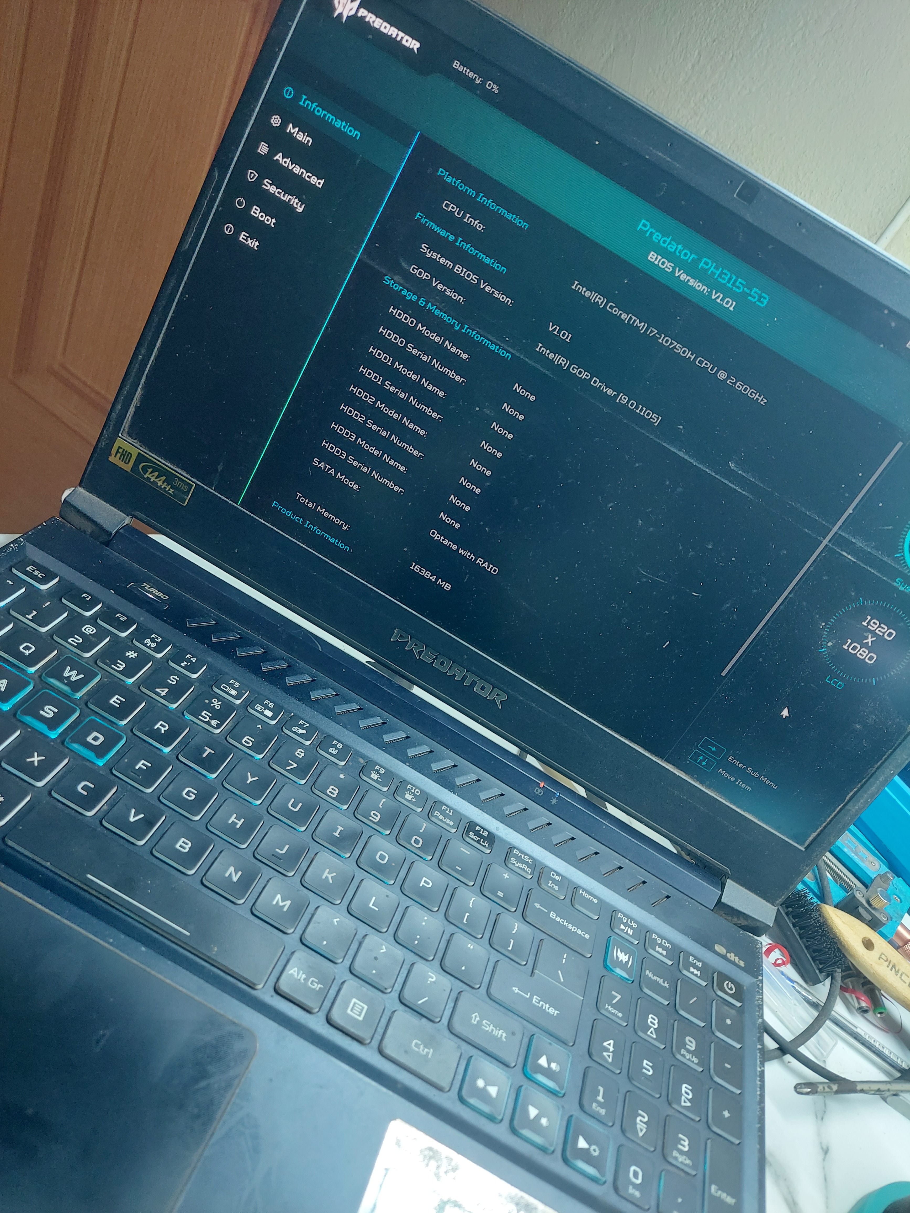

              Thank mon2 PQB12 was leaked after remove it the gate of dc IN recover her 25V, after replace pqb12 there was short to ground due faulty to PQW1 then i remove and computer power on now. i will order and replace it. thank so much for helping
