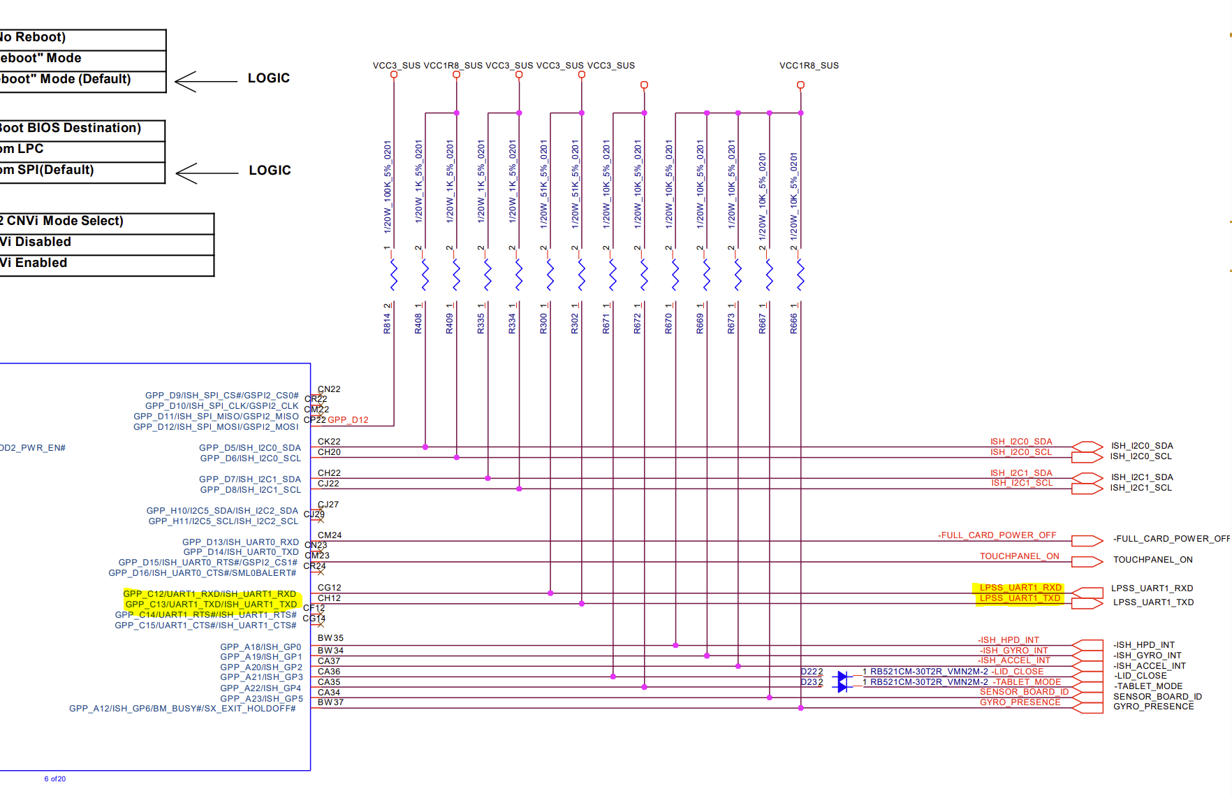

                I still have not made any progress with my machines.
                The only sign of life, that I could get out of them, is a small piece of text on one UART-Interface of the CPU (see attached picture), which is called "LPSS".
                I get the line "FSP-T: CAR Init", which according to some stuff I found online seems to be a very early stage of (U)EFI initialization.
                I was hoping to get some more information out of that interface or at least could send some queries, but so far, I could not get any other response from this interface.
                Sadly, I could not find any information about how this interface could be used.
                Anyone here maybe have an idea?
