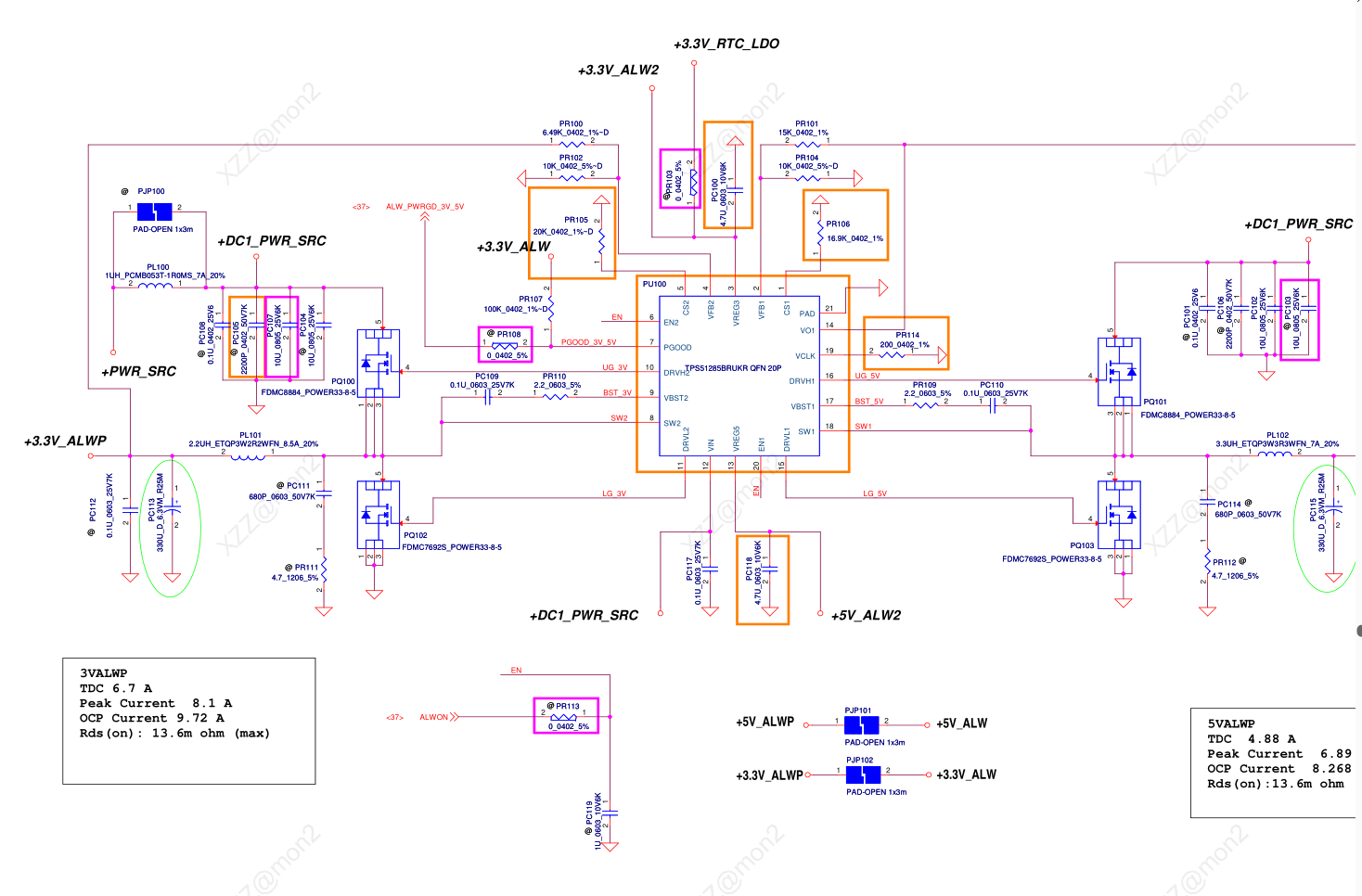

    Hi folks
    Don't power, making voltage injection desire PU100 is in short heats to almost 90 degrees celcius
    The problem is that I don't know his name doesn't appear on the boardview, and I'm looking to replace him with what I read on boardview is IC for powermagnamet
    Model:E7240
    MoBo:VAZ50 LA-9431P Rev:1.0(A00)
    CPU:i7
    PD:take a picture as best I could with the help of a digital microscope you can see something like (T2858) no reference to this number in DataSheet matches it has a total of 20 contacts 5 on each side of the package Click image for larger version

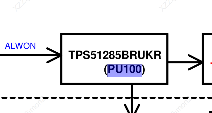

    Perhaps:
    TI # TPS51285BRUKR
    https://www.ti.com/lit/ds/symlink/tp...oogle.com%252F
    Confirmed.

      thanks so much mon2 very fast and accurate response, you have an incredible database I lack tools like those in any way I am very grateful the honor is yours I will write the result of the repair
