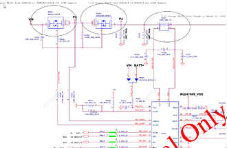

    Hello, I got a problem with my Lenovo Legion Y50-17IRH, motherboard model fy710/fy714 NM-C531 Rev 2.0
    I cannot get it to boot, the white power led lights up for 10-12s, and then resets, it's unable to make post. When I power the motherboard with power supply, it draws 0.034A and there's missing 1.2V on coil.
    It randomly boots, usually after removing the power supply and waiting 20-30mins, it boots, but only without SSD installed, it shows that boot failed, and when I got SSD connected, it just shut downs after 10-15secs into post.
    When it shut downs, or I press power button for about 10s, the amp draw goes from ~2A to 0.034A making it unable to boot again, with missing 1.2V, so I have to disconnect everything, and I can run it again in 30mins.
    Any help what I can measure to check if any component is broken?

    Keep the SSD out and try to power up. Does it everytime? With no power, measure the resistance to ground of each and every inductor. Checking if there is a low resistance = shorted part on that power rail. Each inductor is linked to a power rail.

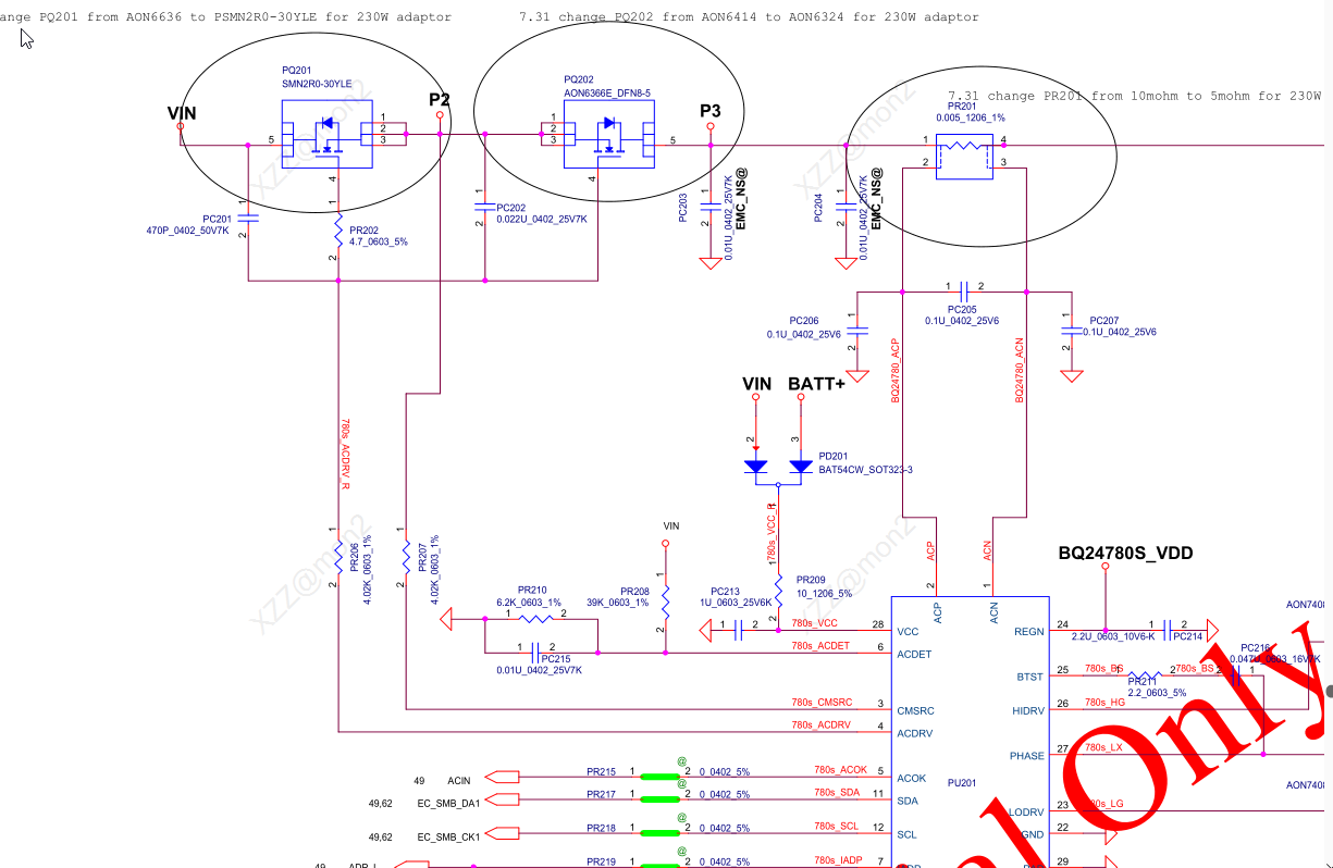

        Attach the power adapter. Measure the voltage to ground of the DCin mosfets.
        Check the following pins on the BQ charger IC:
        ACOK
        ACDET
        REGN
        VCC
        Post each measurement.

          ACOK - 3.2V
          ACDET - 2.7V
          REGN - 5.9V
          VCC - 19.7V
          PQ201
          Drain - 20V
          Source - 20V
          Gate - 26V
          PQ202
          Drain - 20V
          Source - 20V
          Gate - 26V
          Earlier I have measured PQ601 and PQ602
          PQ 601
          Drain - 20V
          Source - 3.3V
          Gate - 3.3V ( was 3.7V when it "booted" to no boot option menu)
          PQ602
          Drain - 3.3V
          Source - 3.3V
          Gate - 0.19V ( Was 1.9V when it "booted" to no boot option menu)​
