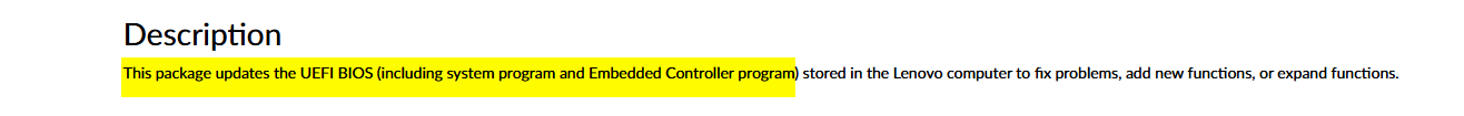

                                From the Lenovo website:
                                https://support.lenovo.com/ca/en/dow...-thinkpad-l470
                                • nikal
                                  • Jul 2023
                                  • 37
                                  • Greece
                                  #36
                                  Originally posted by mon2
                                  Yes I know that however, if there is already a firmware in the internal flash of the EC the PCH won't try to force a new EC firmware flashing (or is it the EC its self that triggers the flash procedure?) So the only way is the external flashing using a programmer. It's unfortunately a dead end as I said. System won't power up without the correct EC firmware so there is no way to initiate a EC firmware flashing. That's my assumption. In the meantime, I found the EC firmware in Vinafix but this is a paid site and in addition, I need to buy a programmer too. What about Vertyanov in case I decide to buy one?
                                  • mon2
                                    • Dec 2019
                                    • 14719
                                    #37
                                    There at least a few techs who own these programmers so wait for their feedback. We purchased the higher end T56 unit but have yet to come across the need to reflash the EC and would likely need some adapter to mate with the keyboard connector.
