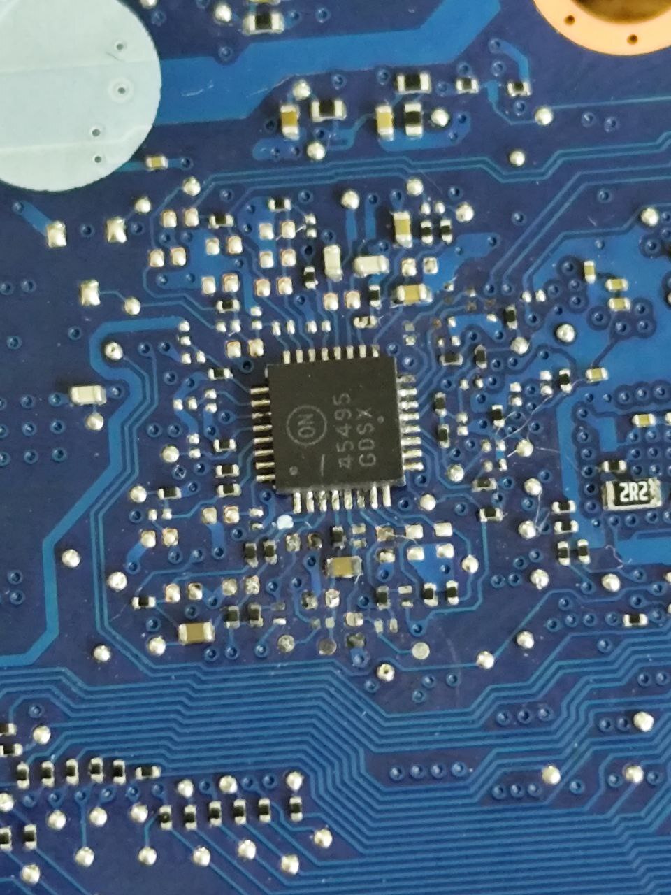

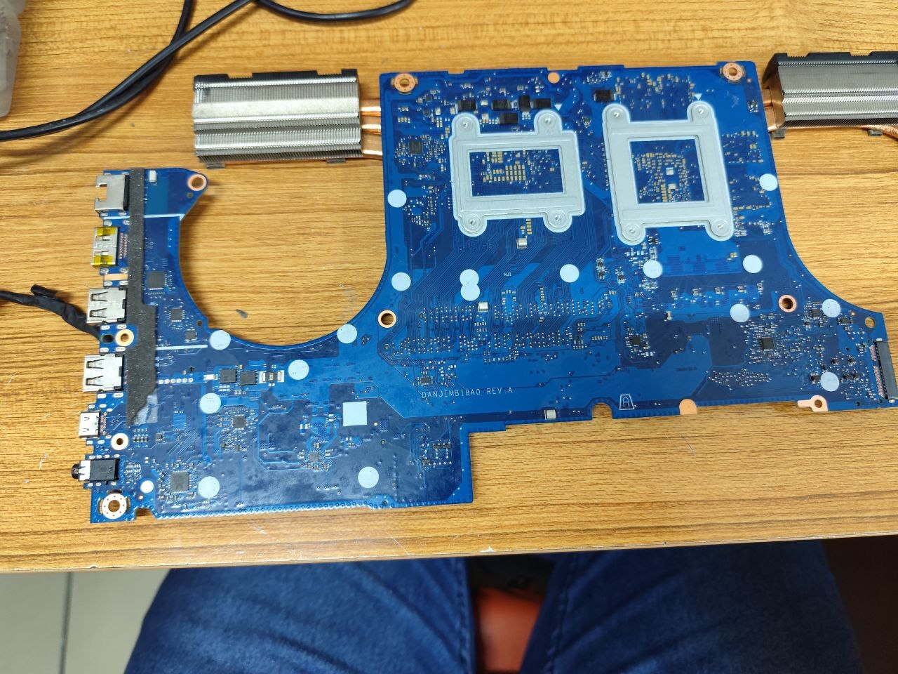

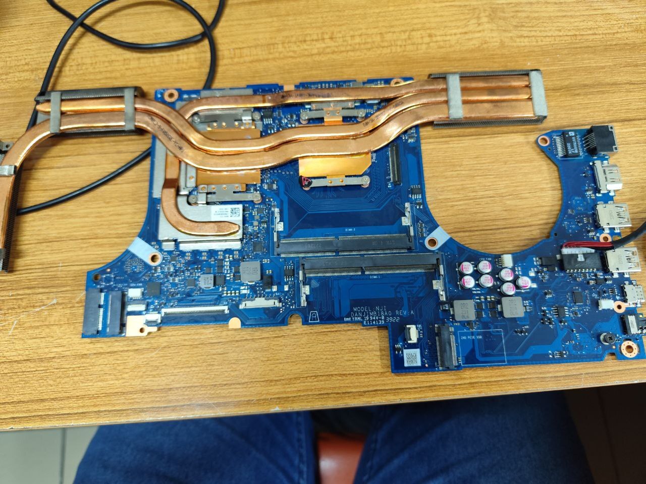

    danjimb18a0 rev a missed component
    Coke spilled on the computer that came from the customer. When it first arrived, there was data on the screen but it was shutting down immediately. After cleaning the motherboard, the device started but there was no image. Then I realized that there were missing parts around the integrated circuit in the picture. I need a high quality image of the motherboard for this part.

    Quanta NJI boardview is available. Why not use it?

        not same model my ic is NCP45495 the ic in the boardview is boardview

            problem solved .. I found the resistors on the same model motherboard
