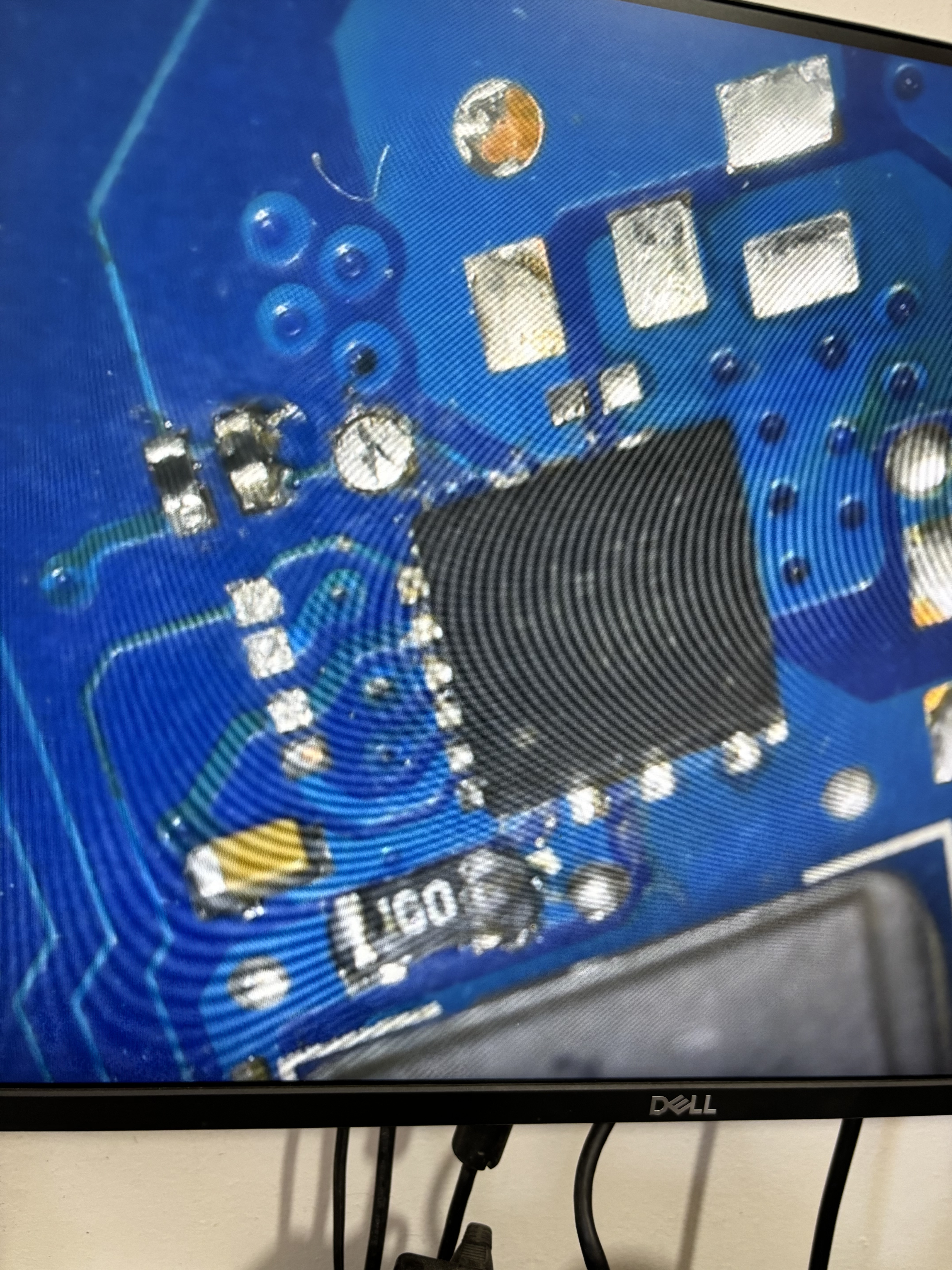

    Trying to save this cutie from going to the scrap.
    Brand: ASUS
    Model: TP412FA-EC378T
    Laptop does not power on properly.
    3.2vSTB is available.
    5v isn't working
    Seems like someone already tried playing with this board.
    need datasheet for the below IC LJ=7B
    found 1 blown resistor 100-> 10Ohm
    some resistors\ caps are missing around this chip.
    Anyone can share schematics for this board or datasheet for the above IC?

    https://www.richtek.com/assets/produ...S6258BC-03.pdf
    Richtek RT6258CGQUF

        After looking at the datasheet provided
        i found enable pin is too low 1.4v (supposed to be above 2.3v)
        Why is the enable pin low?
        Who is supplying that signal?
        can i cut this trace and feed it 3.2v?
