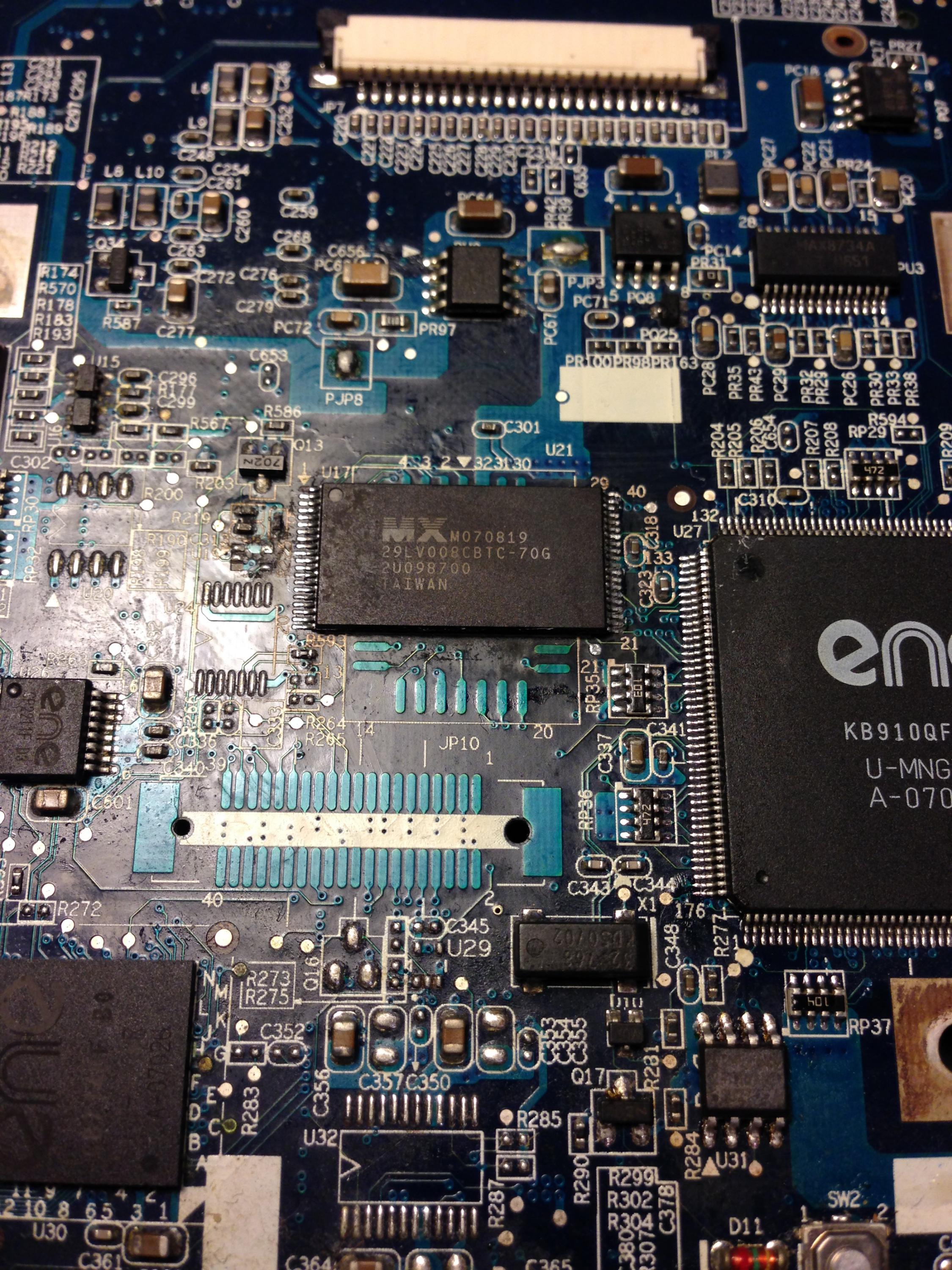

                            now when i take a look at the bios IC (U17) i see that someone has change it. Marking on the IC is 'MX M070918' and the schematic say it shoud be 'SST 39VF080'. I se that it has beed soldered.
                            Now if i buy SST 39VF080 i do not have TSOP 40 adapter from my TL866 promramator.
                            ...the quieter you become the more you are able to hear...

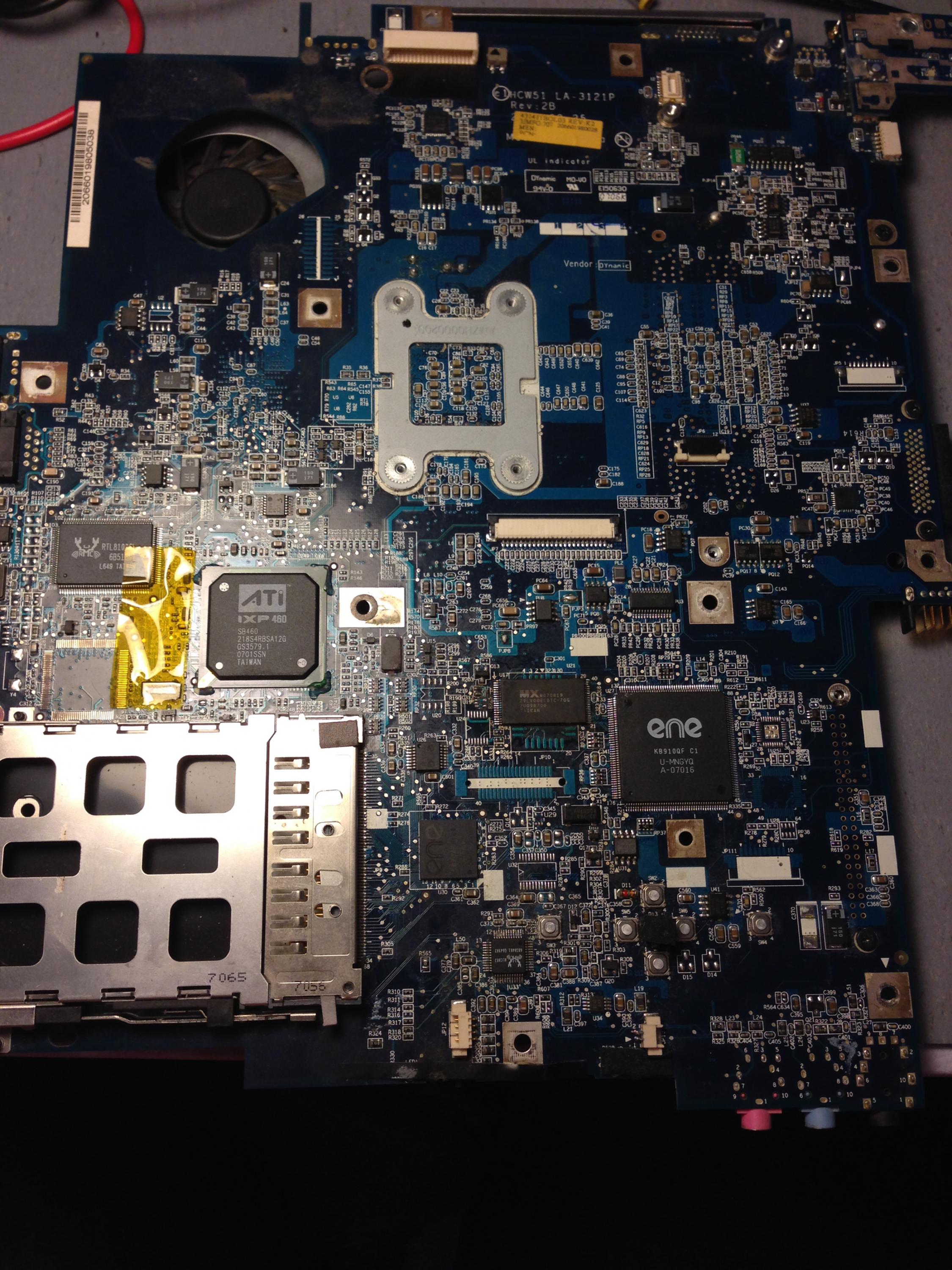

                              pics of mobo may helpfull
                              • rtstorm
                                • Feb 2012
                                • 971
                                • Croatia
                                Re: Acer Aspire 5100 - Compal LA-3121P wont start
                                Here it is
