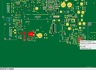

    Just wondering if anybody has any experience with this laptop. I can't find a schematic it asks for 20V from the PSU but will draw no current.

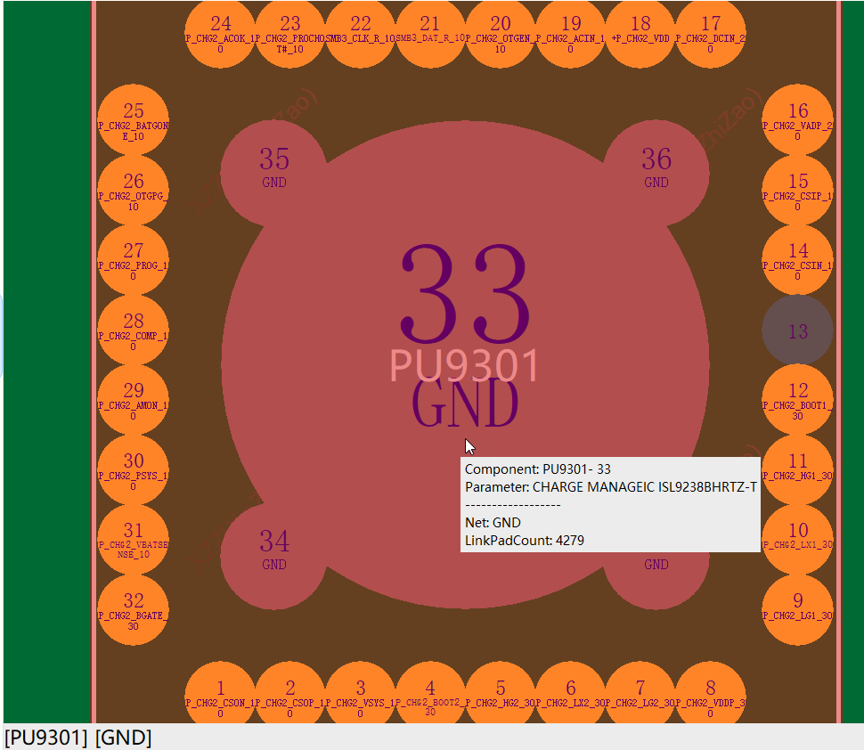

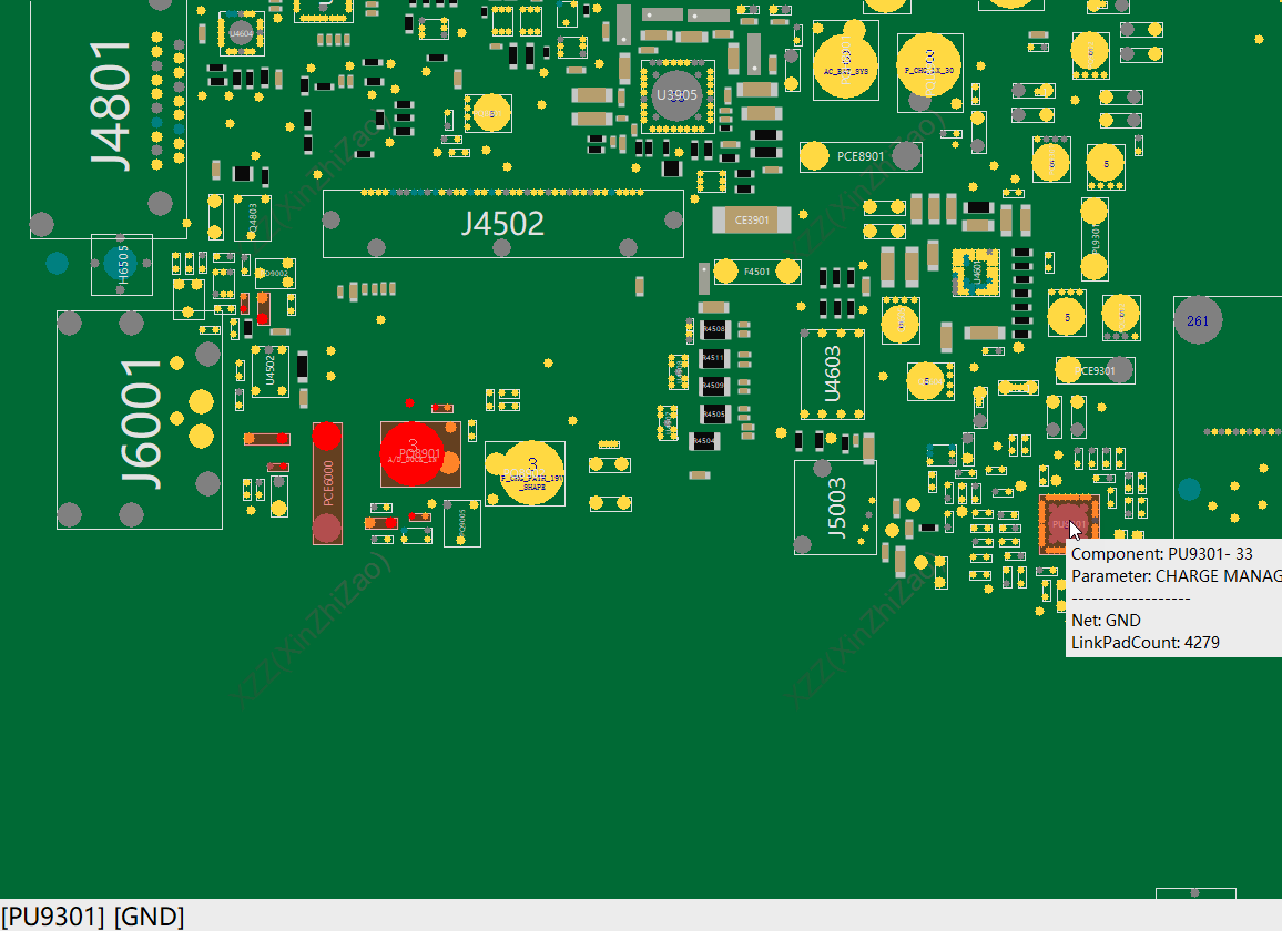

    Review starting with the power adapter / source. Check the charger IC using the ACOK signal. What is the voltage to ground?

      The voltage is reading -0.01V
      Is that checking if PWM is working?

        No current draw.First thing to check is whether 19V reaches CLR.
