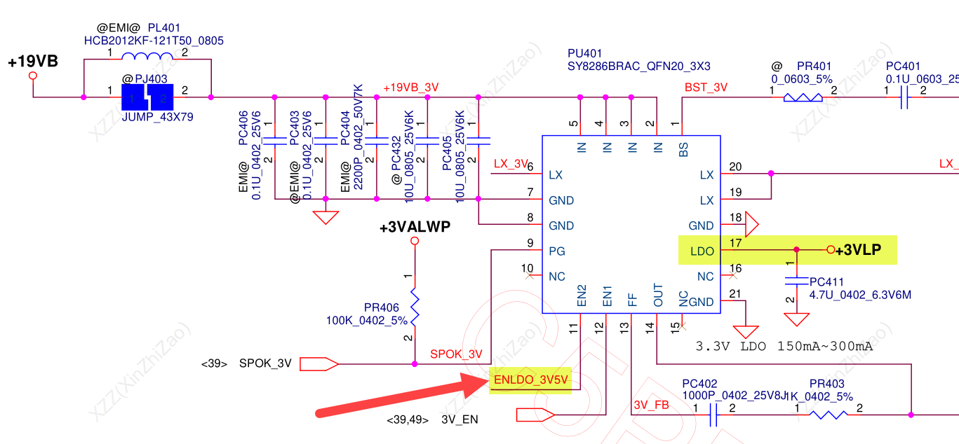

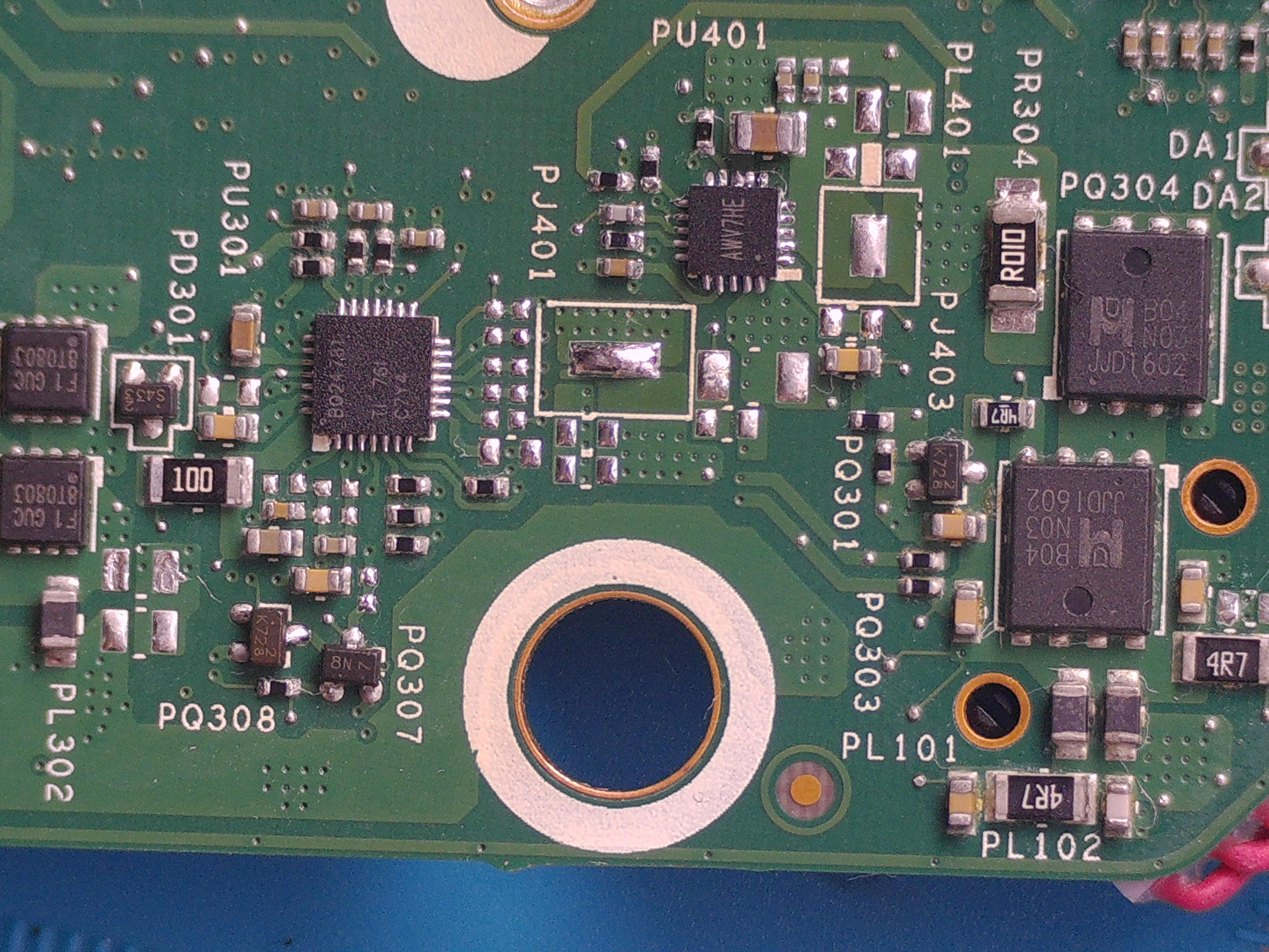

    Trying to fix a motherboard that not starting.
    At first it appears to have a shorted 3V/5V componentPU401 (heating up and consumption was high).
    After replacing still no 3.3V everything seems in place except one capacitor removed.
    ENDLDO (#11) is 4.5V when 19.5V is applied.
    +3VALWP [#14) is 0V when 19.5V isapplied.
    +19BVB_3V (#2,3,4,5) is 19.6V and present.
    BST_3V {#1) is 0V (don(t know if it is normal)
    LX_3V (#19 and 20) is 0V
    SPOK_3V (#9) is 0V
    3V_EN (#12) is 0V (I checked the RB15 and RB15 seems ok, also DB1 and DB2 are OK in diode mode).
    Please tell me if other measures will be usefull, I'm a little bit loss.
    Thank you

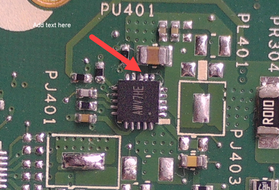

    Flux and clean up the following pads. The pins look to be shorted.

      hi mon2
      Both pad are on the ground that's why I let the pin shorted.
      I will give it a try to check all other pads.

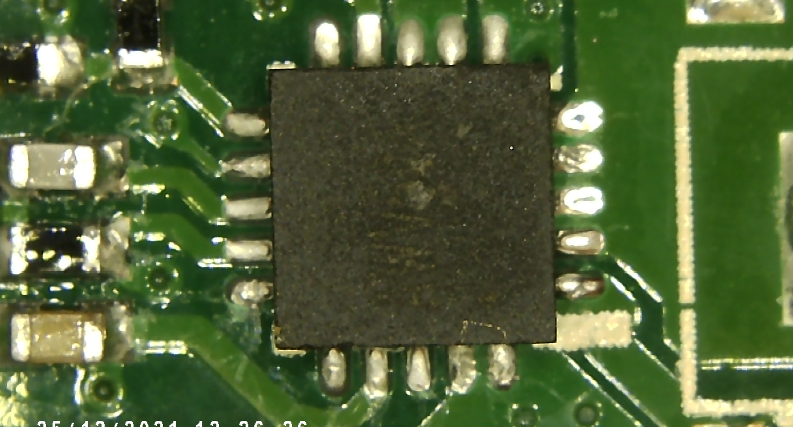

        I also checked all voltage at each pin on the SY8286 ic chip:
        BS, Pin #1 => 0V
        IN, Pin #2,3,4,5 => 19.58V
        LX Pin #6, 19, 20 => 0V
        PG Pin #9 => 0V
        EN Pin #11 => 0V
        ILMT Pin #13 => 0V
        FB Pin #14 => 0V
        BYP Pin #15 => 3.3V some times and 0V most of the time (a bit strange as it seems not to be used on the motherboard schematics)
        VCC Pin #17 => 0V (my issue :-)).
        I tried both IC (the one removed as it was heating up and the brand new one, readings are the same).
        I think something is wrong somewhere but nothing obvious on the board (not burned or missing component except a decoupling capacitor on the charging circuit).
        Any idea will be strongly appreciated.

              Hi. Good review.

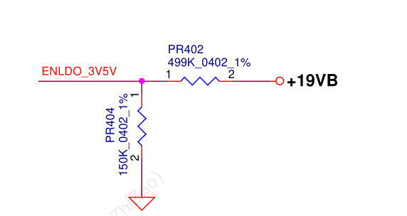

              1) Remove all power. Meter in resistance mode. Measure the resistance to ground of this LDO rail @ pin 17. If there is a low resistance on this rail then someone is shorted and needs to be reviewed.
              2) The enable for this same LDO rail is the ENLDO_3V5V signal fed into pin # 11 (EN2). This voltage is also 0 volts.
              Investigate the resistor based voltage divider for this ENLDO_3V5V signal. Confirm the voltage to ground on each side of the PR402 resistor.
              3) No injection needed unless we know there is a short condition on the rail. The resistance check will confirm this.
              Click image for larger version  Name:	LDO.png Views:	0 Size:	160.7 KB ID:	3322411
              Click image for larger version  Name:	enable_signal.png Views:	0 Size:	18.0 KB ID:	3322410

                1) I read 48.42kOhms (so no short there).
                2) My bad I Have wrongly copied the value on the first page I read 4.49V opn the EN #11, and the PR402 measured at 499K and P404 measured at 150K (but off the board I'm not able to measure one the meter is not catching the value and the other I have MOhms)
                • mon2
                  • Dec 2019
                  • 13898
                  Ok - to summarize, you DO have a valid enable signal. Be sure that this voltage is reaching this regulator's enable pin.

                      With all due respect, I think the issue could still be the soldering. There is a metal belly = EP under this IC. Review the removed part. It is possible that pad is not properly soldered onto the PCB. Consider to reflow with ample flux and use tweezers on 2 edges to gently push the chip away and allow the part to naturally bounce back into position. Keep flowing the hot air with low pressure in circles to keep the solder in liquid mode.
                      Not too much heat so that the PCB does not burn but enough to do the job. The part should sink onto the board.
                      From where did you source this IC? Not sure but check if available from local stores / online or of course Aliexpress. Use only stores with high ratings. They are cheap enough to source more for testing.
