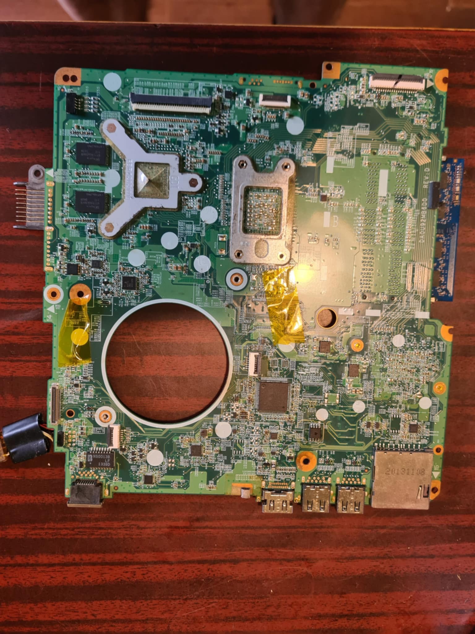

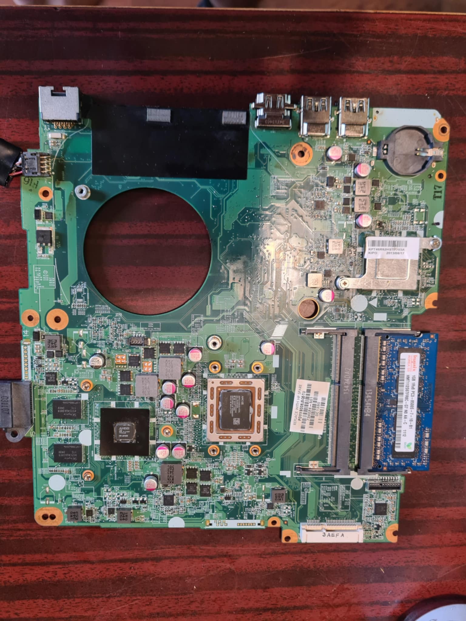

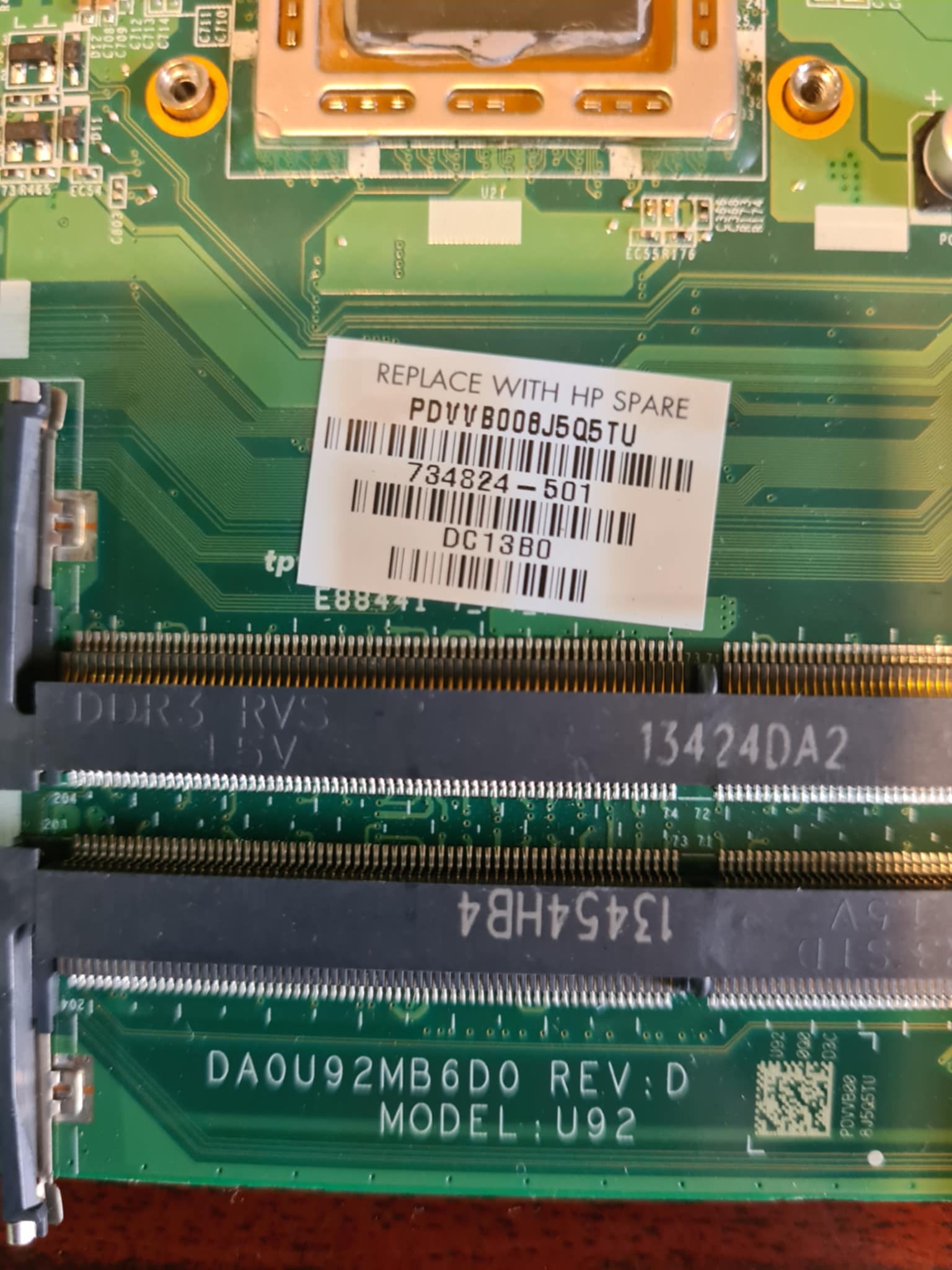

    board: daou92mb6do rev d
    model: 15-n038so
    After press power button 3x blinks on dc jack. If i remove bios chip nothing happens. Tried few bios bins, result is same.
    Have old bios, included here, schematics, board, and pictured of mb. [MOD EDIT] Link to schematic/boardview --> https://www.badcaps.net/forum/troubl...ded#post893026

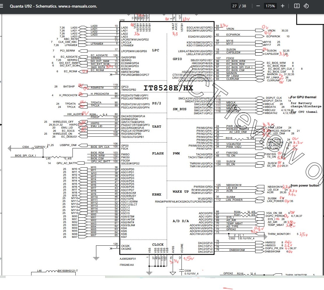

    I have ec chip voltages on picture.
    Click image for larger version  Name:	065440b5-54e6-42e3-95ca-b2d7f9a22eb5.jpg Views:	18 Size:	320.5 KB ID:	3313200 Click image for larger version  Name:	3661c924-b925-49e8-868e-7b197d979652.jpg Views:	18 Size:	436.1 KB ID:	3313201 Click image for larger version  Name:	992f3afb-010a-48f1-a158-d6214fc9c248.jpg Views:	22 Size:	467.6 KB ID:	3313203 Click image for larger version  Name:	ite8528E-HX.jpg Views:	19 Size:	276.1 KB ID:	3313202
    Iam pretty exhausted, any suggestion will be good.

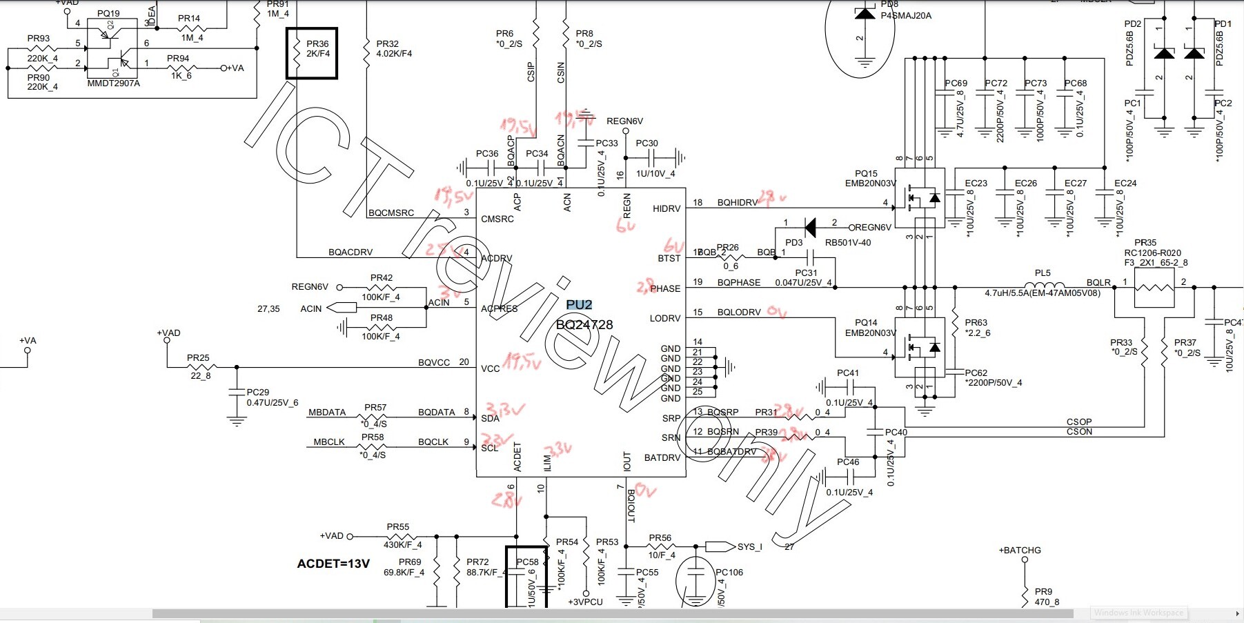

    Review the 2 x dcin mosfets and the charger ic. Does the adapter voltage reach the main power rail? If not then the dcin mosfets and power rail resistance checks should be made. No power during resistance checks.

      Ima thinking about it8528e/hx what pins need to be high or low before AC_LED_ON#

          Yes iam aware of that problem, using HP adapter middle pin is 18,5V then after connect to mb voltage drop to 0.52v , further going to ad_type in ec chip pin 71 voltage is 0.6v. I think this is ok but maybe i`am wrong. I did re-check right now.

            Share the voltage to ground of the following pins on PU2 (charger IC) with the power adapter connected:
            REGN (pin 16)
            ACDRV (pin 4)
            ACN (pin 1)
            ACPRES (pin 5)
            • baddjavo
              • Jun 2018
              • 87
              • Serbia
Name:	pu2 voltages.jpg
ID:	3313850 all pu2 voltages
