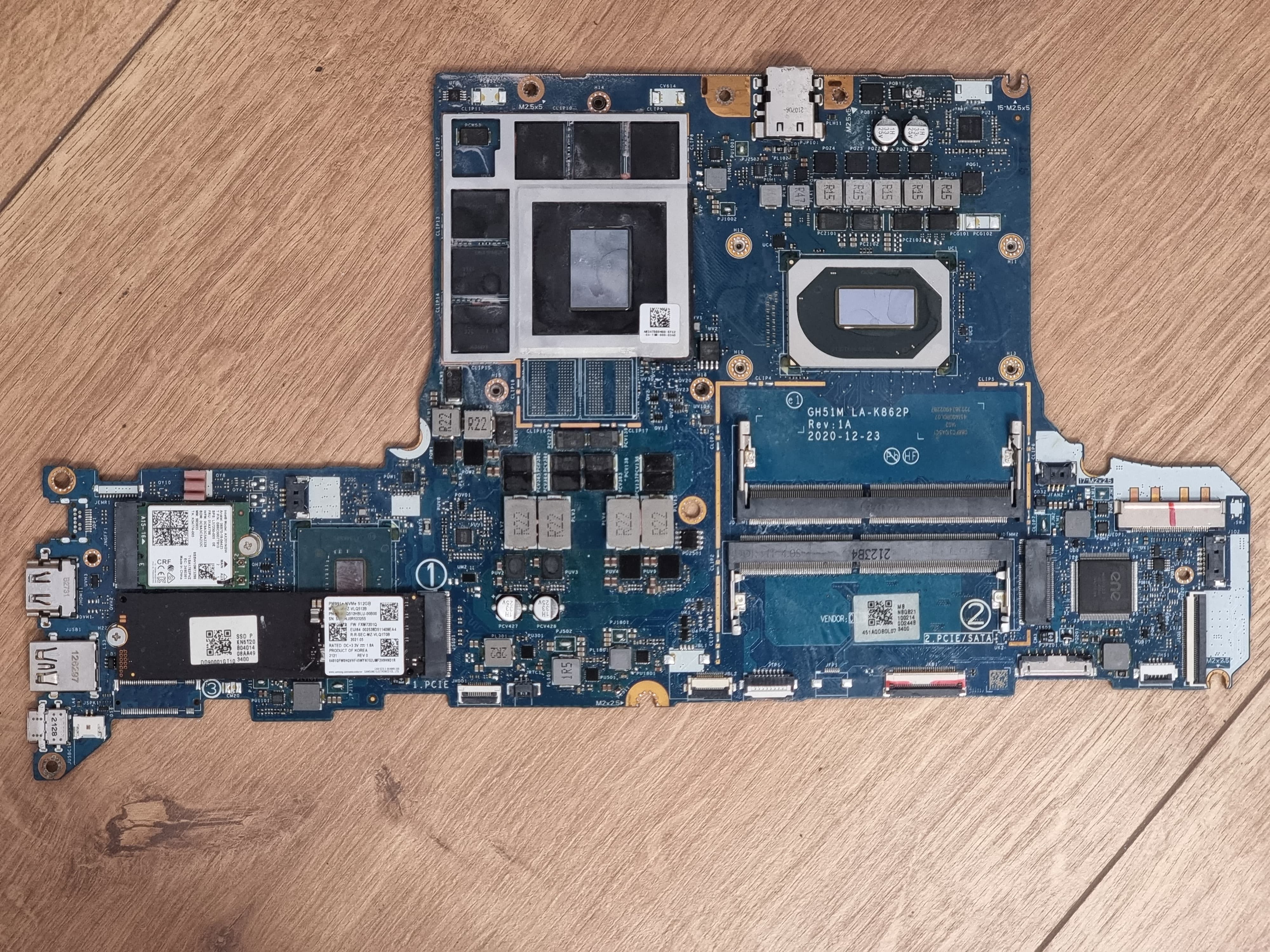

    Can someon Help me, I have a GH51M LA-K862P, and there is a short somewhere after PRB3 and PRB46. I've looked for it using a thermal camera, but I can't find it. Maybe we can find it together. It's a very interesting case.

      I am using the following boardview and schematic. I believe the boardview is not exactly for this model, but it is very similar. PRB3 pins 3 and 4 have a short to GND, as do PRB46 pins 3 and 4. I used a thermal camera to try to locate the heat source. I connected a lab power supply 3A and 1V directly to pins 3 and 4. The power supply indicates a 100% short to GND , but there is no heat anywhere."

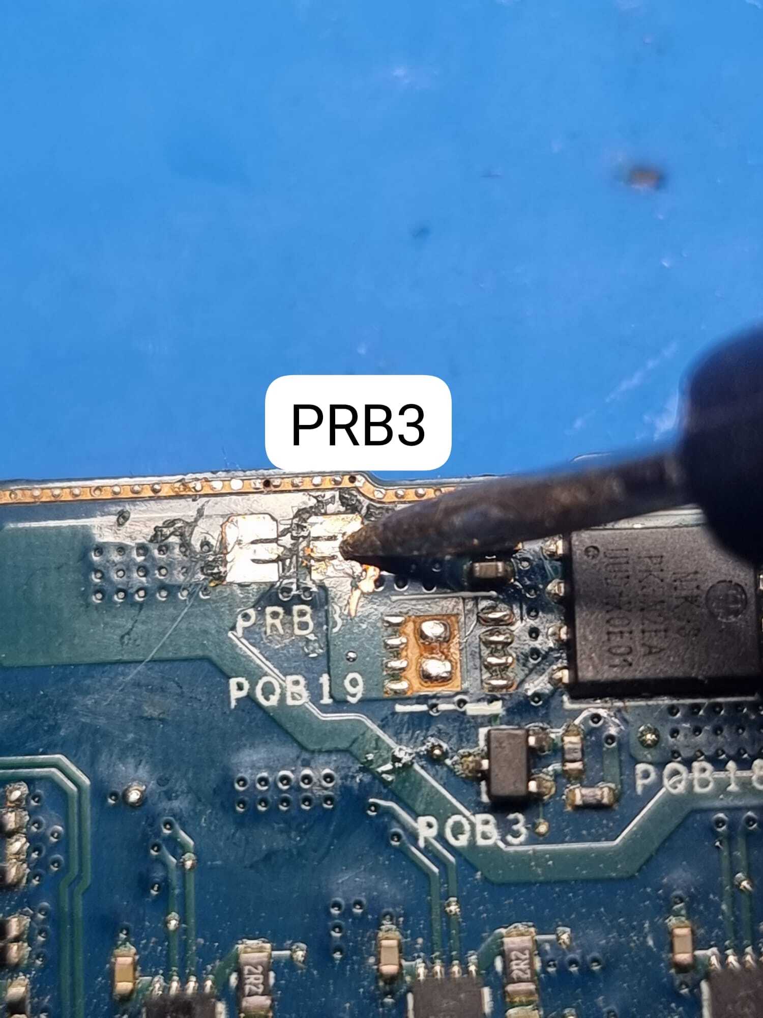

        Flux and remove PRB3 and PRB46 off the board. Then measure the resistance to ground of the same rails. Post the measurements. Which side of the power rail is showing the short condition?

            I removed PRB3 and PRB46, but the short on pins 3 and 4 remains. It looks like ACN_CHGR is shorted to ground because I removed PQB1 and PQB13, but the short is still there. Then I removed PLB1, but the short didn't go away

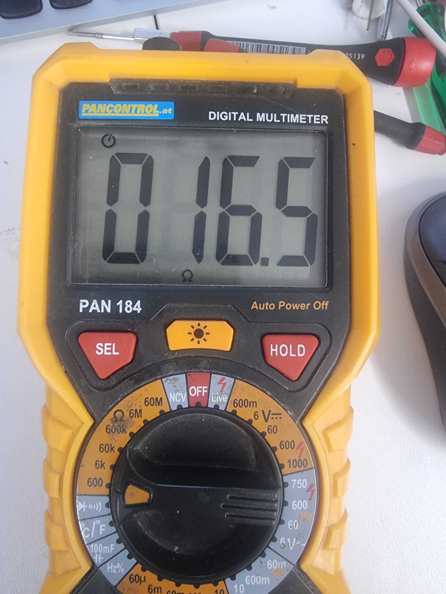

                    I am sorry, I was in Diode mode. hier correct measurements 0,165 and Pic.
                    • mon2
                      • Dec 2019
                      • 14334
                      So you have 16R5 = 16.5 ohms to ground. That is of concern and as per post # 6, you most likely have a high side shorted mosfet which usually means trouble. That is, this high voltage rail has passed onto a low voltage rail (due to the leaky mosfet) and most likely killed the downstream low voltage parts.

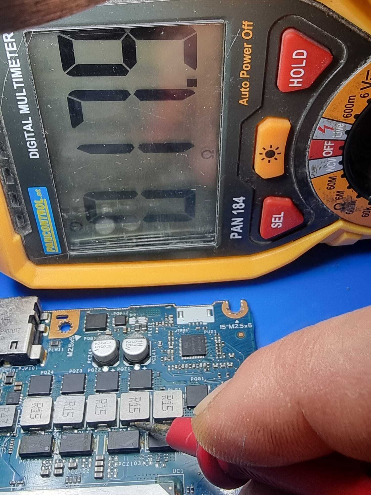

                      Remain on this meter scale. With no power to the board, place one meter probe here and other meter probe onto any 2 legged inductor (usually grey in color) on the board. Checking for a low resistance path between the 2 points being tested. Each such inductor has a high side mosfet. If you see a low resistance then that high side mosfet is defective.
                      Start with the CPU VCORE inductors. Post all suspects.

                          I selected PCZ102 (+VCC_CORE) I get 18,0 ohms.
                            DANG!
                            Measure resistance between PRB3 and +VCC_CORE then

                              resistance between PRB3 and +VCC_CORE is 18.0 ohms

                                Then it is not the power rail we are looking for or the previous shared measurement of the main power rail is not exact, still.

                                      No, it is the right side. As I mentioned at the beginning, this board view is not exactly like my board. Look at the picture again, it says PRB3. 'mon2' wrote that I should remove PRB3 and PRB46, message number 5. My measurements are correct; I have checked them again. With PRB3 and PRB46 or without, it doesn't change anything.
