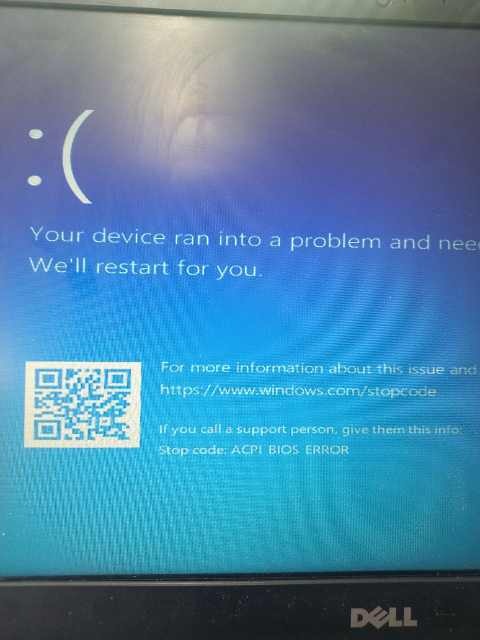

    Model: Dell Inspiron 15-7567
    SN: FZF5YF2
    MB Part number: LA-D993P Rev:1.0
    When I run Windows or any flash drive that contains Windows, it gives me a blue screen with the message “ACPİ BİOS ERROR.”
    - I tried changing the Sata Operation settings (AHCI-RAID ON)
    - I tried repairing Bios File (Rebuild Bios Region - Clear me)
    But without any benefit
    Please help​

    I am suspecting the fault is with the applied BIOS. Post or hunt down a known good bios on the BIOS forum.
    Just found a BIOS image in my database. Will link it for you to test.
    Here you go (check the last post):
    Dump Dell Inspiron 7567 LA-D993P - Badcaps
    A virtual falafel in exchange if right
