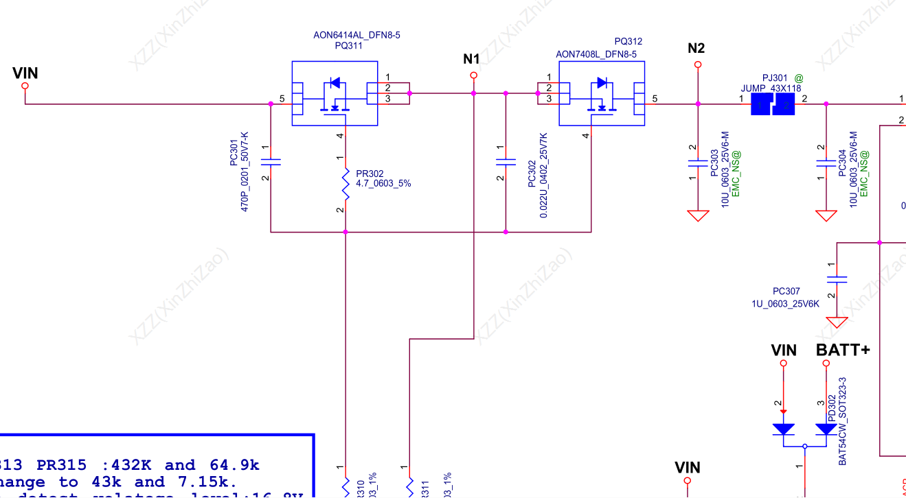

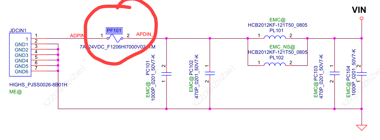

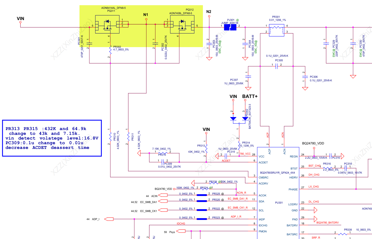

          Update - first check the voltage to ground on EACH side of the fuse @ PF101.
          Next...
          1) Remove all power. Meter in resistance mode. Measure the resistance to ground of the drain pins (5-6-7-8) on mosfet PQ312 - any of these pins is ok. We are checking to see if there is a shorted component on the main power rail which is after the highlighted 2 x DCin mosfets.
          2) If the resistance is not too low, power up. Meter in DC volts mode (30v or higher or auto-scaling mode). Carefully measure the voltage to ground on each of the highlighted DCin mosfets.
          Check the voltage to ground of PQ311:
          Drain pins (5-6-7-8) ; any of these pins is ok - voltage should match the power adapter voltage since this is the INPUT to the board.
          gate pin (4)
          source (1-2-3)
          Repeat for the 2nd DCin mosfet @ PQ312.
          Post each measurement.
          Click image for larger version  Name:	power_path.png Views:	0 Size:	97.9 KB ID:	3269937
          Click image for larger version  Name:	dcin_mosfets.png Views:	0 Size:	180.9 KB ID:	3269938

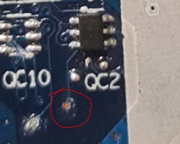

            Just as I was dismantling it to prepare for measurement, I noticed two interesting things (1 for sure) (it had never been disassembled before). What do you suggest?

              Pour ipa (alcohol) on these regions of the board and clean it up with cotton swabs / q-tips.

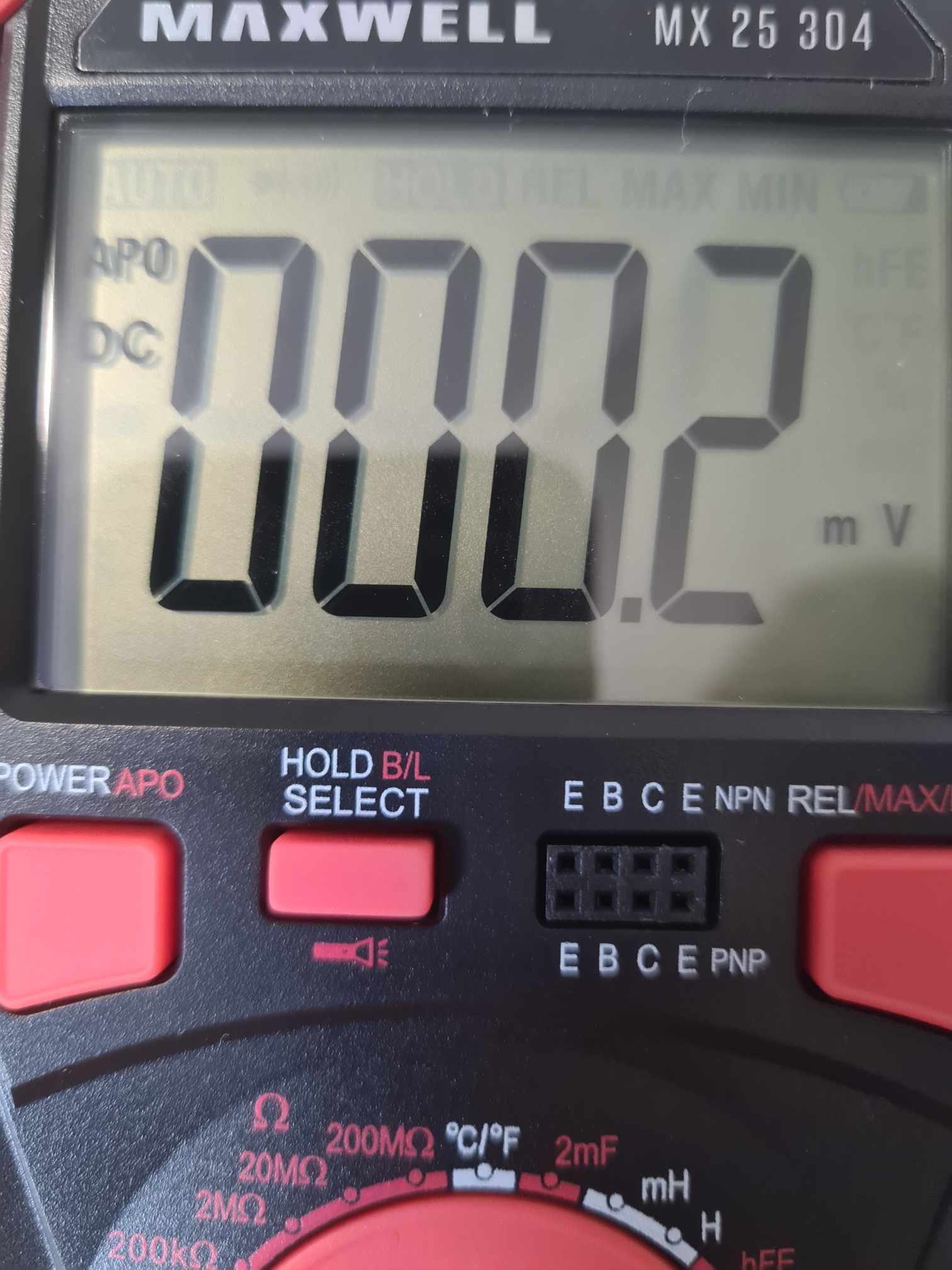

                Here are the measurements: I'm not particularly skilled with a meter, so if any value seems really odd, I'll remeasure.
                fuse@ PF101 (without power cable). both side is the same 0.7 mV sometimes 0.2mV or 0(!) for both of them: Click image for larger version  Name:	441888220_1111106390184465_659125734515590559_n.jpg Views:	0 Size:	144.5 KB ID:	3270052
                pq311 pin 5 is 20.4V , pin 4 (gate) 26.2V pin 1-2-3 20.4V
                PQ312 pin 5 is 20.4V , pin 4 (gate) 26.2V pin 1-2-3 20.4V
                (I cleaned with alcohol but still the same issue)

                  The voltage measurements on PQ311 / PQ312 confirm that your fuse @ PF101 is not blown.
                  1) In the shared video - was the battery connected or disconnected? Is the power adapter connected or disconnected?
                  2) With the battery AND power adapter connected, carefully measure the voltage to ground @ PL302 inductor. This inductor is usually grey in color and will have 2 contact leads. This inductor is in series with the battery charge leg of the logic board. Need to know what voltage is present here.
                  3) Does this logic board function ok if using ONLY the power adapter?

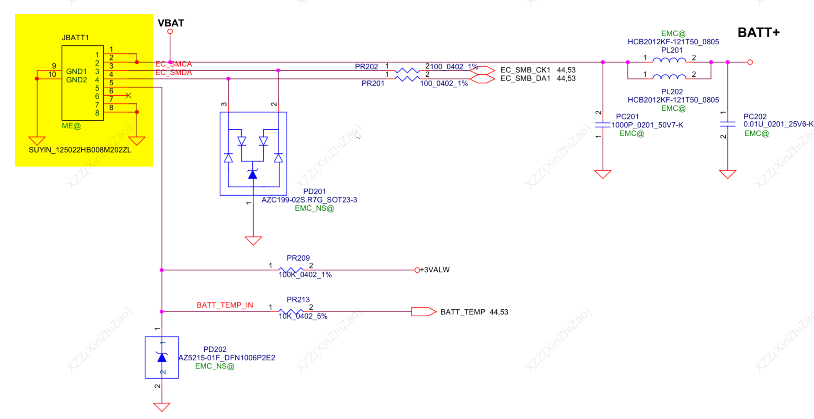

                      @ PL302 inductor both legs are 8.5V (charger and battery plugged in)
                      Edit(!) Battery is charging, but when I turn it on, it runs for a few seconds without any fan or image, then it turns off along with the charging, and then it starts charging again.
                      • mon2
                        • Dec 2019
                        • 14882
                        See attached. Connect both, the battery and power adapter.
                        Carefully measure the voltage to ground of each pin on the battery connector. If this is not possible to do, consider the alternative test method.
                        Remove all power -> meter in DIODE mode. Short your meter probes and the meter will tone beep.
                        Place the red meter probe, yes RED, to ground (any metal shield is ok). Black meter probe onto the point to test.
                        Test each pin on the battery connector (no battery / no power adapter if using DIODE mode of testing).
                        We are checking to see if the TVS ESD diodes @ PD201 are defective or not.

                          Here you go: First option;
                          Click image for larger version  Name:	441987823_771258035114034_8487487618856117020_n.jpg Views:	0 Size:	411.2 KB ID:	3270095 1 pin: 8,5V 2 pin: 8.5V pin 3 3.2V pin 4 3.2V pin 5 0.3V pin 6 0V pin 7 0V pin 8 0V
                          Edit with method 2: only 8,7 beeping
                            SMBUS lines are ok and the TVS ESD diodes are not blown.

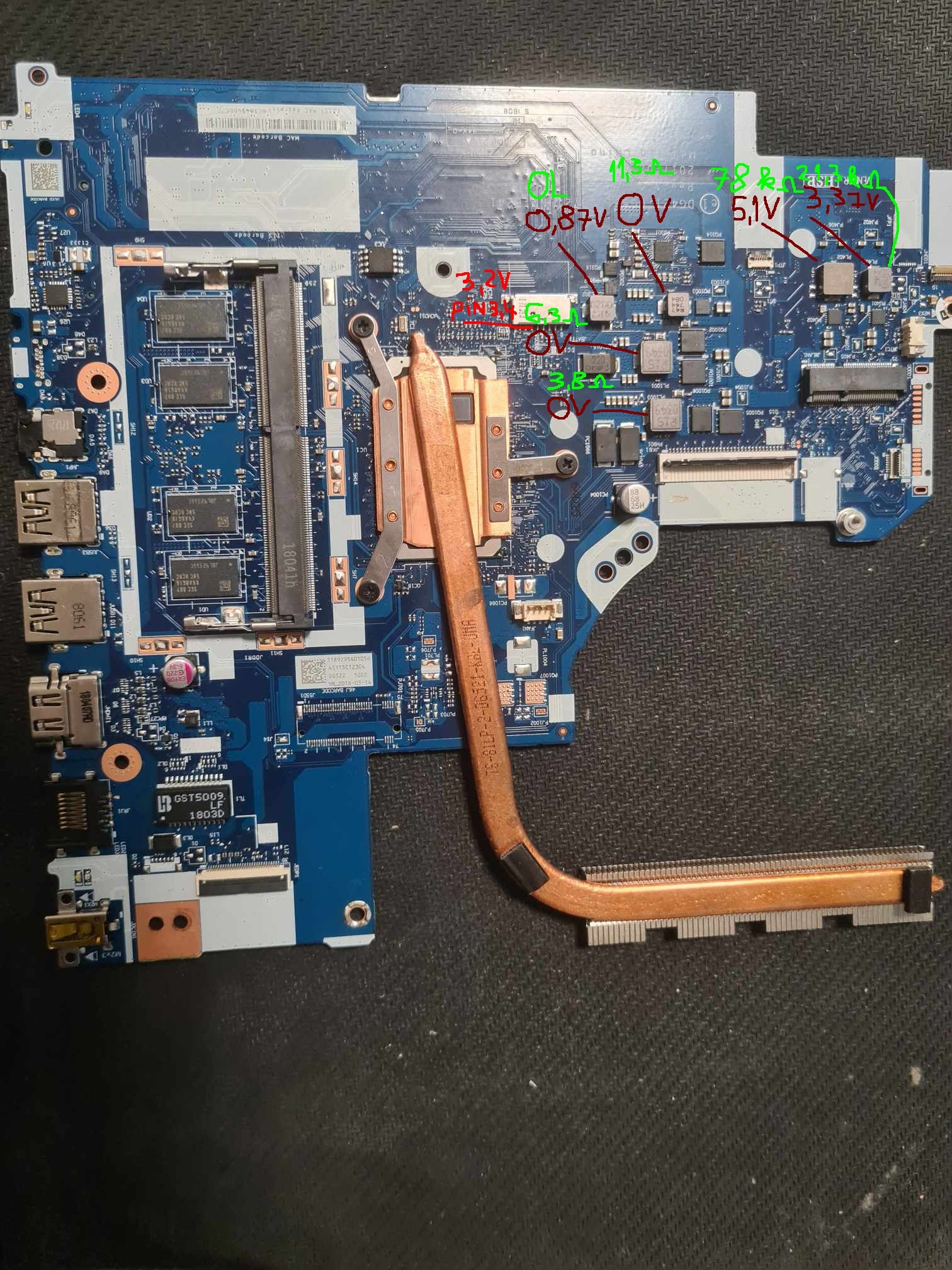

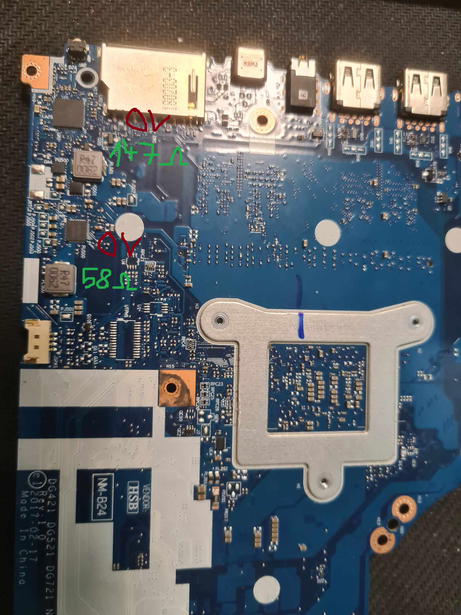

                                I made a brief summary, unfortunately I still don't know what else could be the problem
                                If anyone happens to have any ideas, I would appreciate it!

                                  UC4 pins seems like bridged with extra solder. Check it once

                                    I measured it, and I find it a bit odd that I only measured 5.1 volts on the 11th leg. ( power cable is only plugged)
                                    Click image for larger version  Name:	441991950_412919198367810_2749003784766318593_n.jpg Views:	0 Size:	212.8 KB ID:	3270659Click image for larger version  Name:	aa.png Views:	0 Size:	38.4 KB ID:	3270660
                                      • 22293
                                      What youve measured is pin 4 ,look at the number 1 (and the white line next to it) and 8 around the IC .

                                        Thank you, I really overlooked it. However, could this mean something?
                                          • 22293
                                          Pin 4 is ok 5 volts Always on voltage. Pin 10 looks like it might be bridged or it has something on the solder. QC2 might have a broken trace
