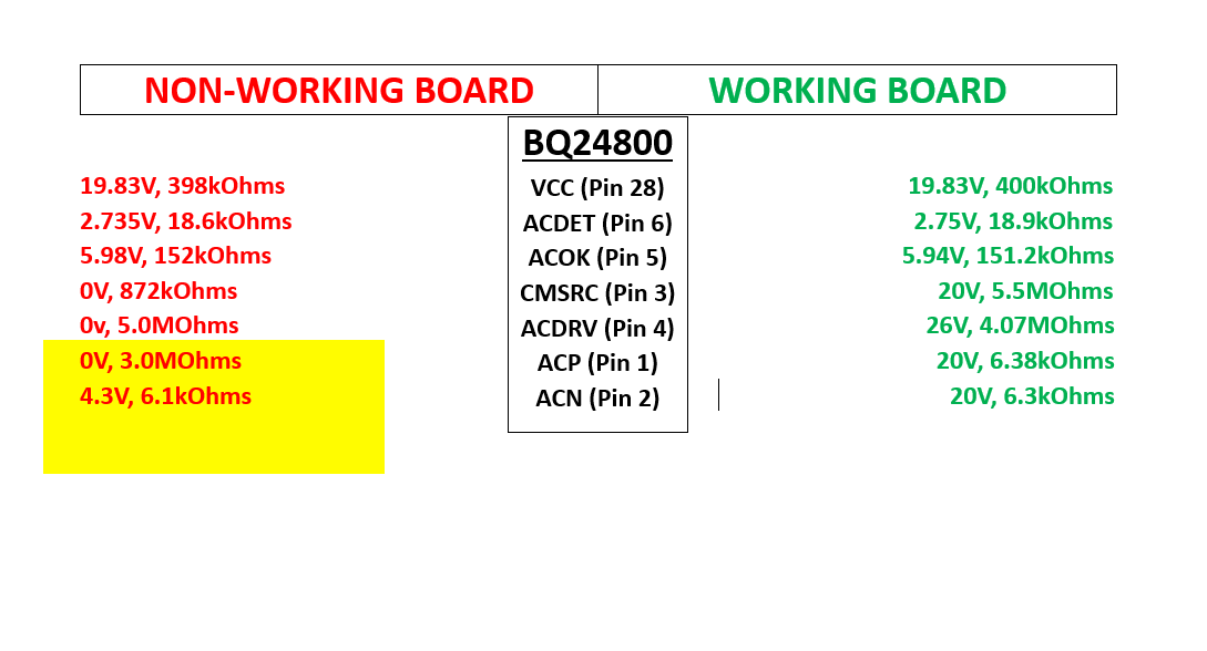

    I have an Asus G14 (GA401QM) that has a power issue. Originally the board had a shorted 5V rail and dead EC. I reballed a working EC, soldered it on, and I resolved the 5V issue by replacing the APL6012 and the low side 5V mosfet. Resistances on all power rails are healthy now, but 20V does not make it through the first MOSFET. 20V is present on the drain of the first MOSFET, but there is no voltage on the gate or source.
    When diagnosing this issue, I thought that the issue was due to the BQ24800 chip not outputting the correct signals so I soldered on a known working chip and the same issue is present. To check whether the chip that was originally on my board is good or not, I soldered it on to the working board and it works fine.
    Resistances and voltage measurements are attached in the Word document and boardview/schematic are in the respective section on this forum.

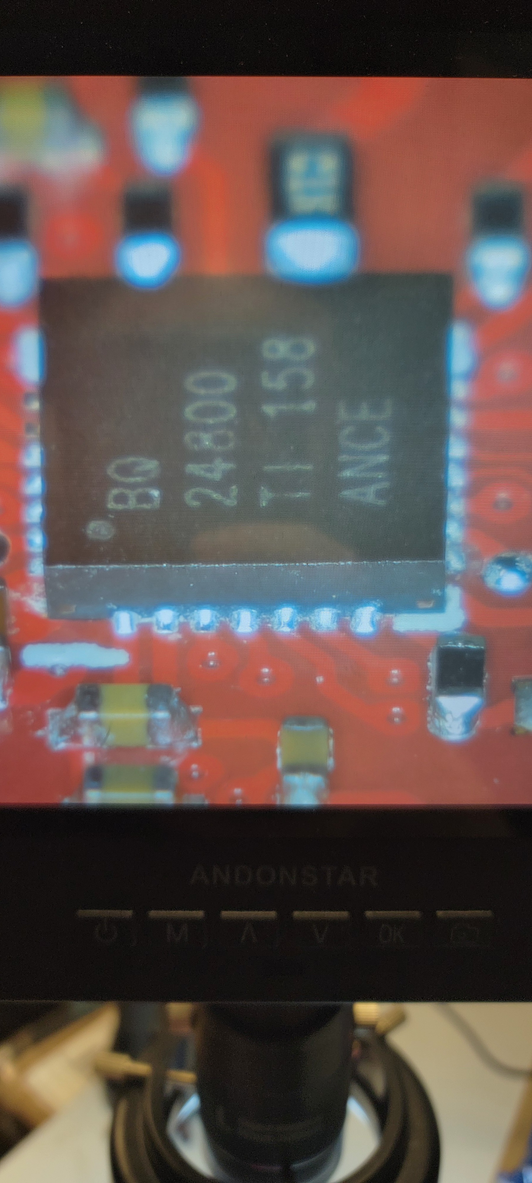

        The current sense resistor across ACN / ACP pins of the charger IC do not appear to be soldered correctly. Confirm this detail. The charger IC may need a reflow as well. You should have the same voltage on each side of this current sense resistor. Also the same resistance to ground on each leg of this important resistor.
        • ResoluteHawk
          • Nov 2021
          • 154
          Pins on the BQ chip are soldered perfectly, and the pins make contact with the board. Same resistance to ground is present on both sides of PRS8901, but not on the BQ chip. BQ chip presently on the board is confirmed working correctly on another board.
          • mon2
            • Dec 2019
            • 14368
            You will need to flux the BQ pads and allow for the BQ chip to melt into place once the solder is in liquid form. This is highly recommended for a good contact.

                Couldn't have soldered those pins any better.
                Same readings still.

                  With no power -> measure the resistance between pins 1 & 2 directly on this charger IC. We are checking the full current loop path for the main power rail. What is the measurement?
                  • ResoluteHawk
                    • Nov 2021
                    • 154
                    Resistance between pins 1 and 2 of the BQ chip rises north of 3M Ohms. It should be continuous as measured on a working machine.
                    Might be looking for a blown 0 Ohm resistor somewhere.
                    Also, new discovery: Laptop turns on and POSTs into the BIOS with just a battery.
                    • mon2
                      • Dec 2019
                      • 14368
                      You have a trace break in this current sense path. Use the same method to trace from the ACP to one side of the current sense resistor, etc. Hunt it down in segments and repair where the trace or path is broken.

                                Also, I checked the two diodes that supply the power to the BQ chip, and both of those diodes have a 0.3 voltage drop from one end to the other.
                                Current sense resistor one end to the other end => Continuous tone.
                                ACP at BQ chip to the current sense resistor => Continuous tone.
                                ACN at BQ chip to the current sense resistor => 0.8 voltage drop < something wrong here
                                Connection between ACN and ACP directly on the BQ chip pins => Above 3M Ohms
                                VCC (Pin 28 of BQ) = 19.85V when AC is plugged in.
                                I'm lost. I don't know where else to look and I don't see any other path from the BQ chip to the current sense resistor than what I already tested.
                                Are we suggesting that the trace itself that is in the layers of the board is damaged?
                                  Connection between ACN and ACP directly on the BQ chip pins => Above 3M Ohms​
                                  CLR = current load resistor / sense resistor - many ways to say the same thing.
