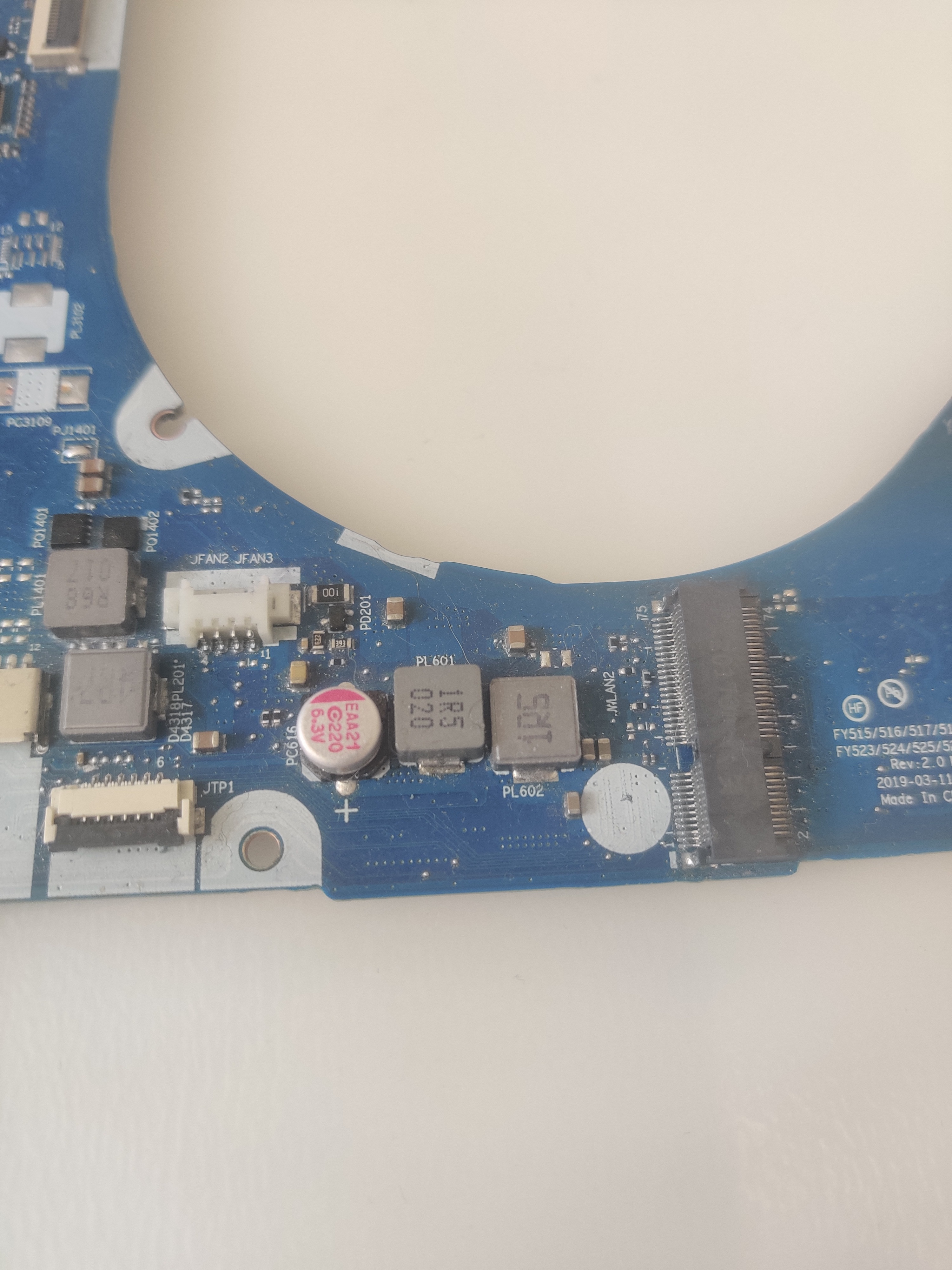

    I am still new to this, so I might sound brainless/ignorant in parts of my description/questions, since I have a lot of gaps in my knowledge, but I will do my best.
    The laptop is Lenovo Legion Y540-15IRH, and the motherboard model is NM-C221 Rev 2.0 (Schematics and BoardView can be easily found). To save time I have the exact problem in the laptop as the one shown in this video:
    https://www.youtube.com/watch?v=tfucZ_WKpz4
    I was checking the voltages I found that the main power rail V20B+ is good, and same for the +3VALW circut, but when I tried the +5VALW, the circuit was shorted and I think the problem came from one of these 2 MOSFETS PQ603 (AON7380_DFN8-5) and PQ604 (AON6380_DFN8-5), and while checking voltage with the multimeter on DC mode I made a mistake of touching two pins of the drain of PQ603 with the red probe, which caused more problems. And now I think there is a short even in the main power rail, since when checking for voltages I could see that there is voltage coming in to PQ201(AONS32314_DFN8-5) 20.5V, but no voltage coming out from that MOSFET or anything else afterward. My questions are:
    -Will replacing PQ201 with the right component, fix the main power rail problem and at least revert the motherboard to the initial problem?
    -Am I on the right track or should I look for the short somewhere else entirely?
    I would really appreciate any help, thanks in advance. And if you need clarification or have any questions, I would be happy to reply.

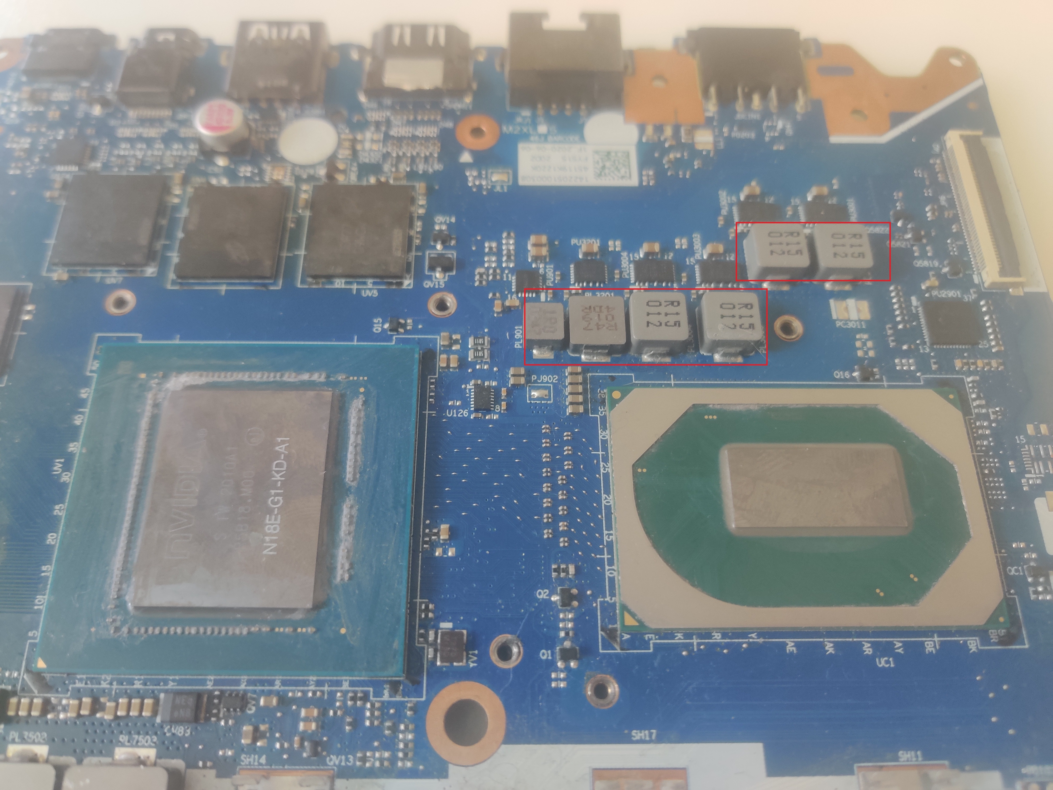

                  Next suggestion is to logically view where this short may be present. Hope it is not the CPU but time to pull the band-aid off.
                  Meter in resistance mode (use lowest scale if it is a manual type) -> Measure the resistance to ground at the inductor group that is near the CPU. What is the resistance measurement? There should be multiple inductors in this area as the multiple power rails take turns supporting the power to the CPU so that not one is over worked. The CPU current demands are very high so multiphase power supplies are used.
                  • mist79
                    New Explorer
                    • Apr 2024
                    • 13
                    I really appreciate you explaining what happening to me, and why we are doing what we are doing; I need that since I am just a beginner. So I am not sure if this is what you mean, but here is the measurements for the group of inductors that are close to the CPU (The boardview that is provided is not the exact same as the model I have, but close enough). Resistance to Ground, on the lowest scale, for:
                    PL3001 = 1.3
                    PL3002 = 1.2
                    PL 3003 & PL3004= 1.3
                    PL3021= 10.5
                    PL901 = 32.4
                    If these are not the components that I need to measure, plz take a look at schematic or the boardview and let me know which ones I am supposed to measure.

                        No. Continue to check each and every inductor for the same resistance to ground as the one of the main power rail.
                        • mist79
                          New Explorer
                          • Apr 2024
                          • 13
                          Can you clarify what you said there? what do you mean by checking every inductor in the main power rail, can you specify which ones? (parts number from the schematic [password: Y540] so I can check it). and what do you mean by "for the same resistance to ground" what value are we looking for?
                          • mon2
                            • Dec 2019
                            • 14732
                            On every board, there are numerous power rails. These are often switching power supply rails. A switching power supply rail requires the use of an inductor (often grey in color and 2 leads). We are wanting to check each inductor's resistance to ground to see if there is a similar resistance to ground measurement. If there is not, then the fault is not on a high side mosfet. So far, I do not believe that your CPU is shorted. Ideally, you will find that it is a capacitor onboard that is defective and we can smoke it out with a voltage injection.
                            For now, continue to test each and every inductor in resistance mode to ground. If you find a similar low resistance reading - post the details - otherwise continue to test other inductors. This is only a cursory review of the power rails for other shorts.

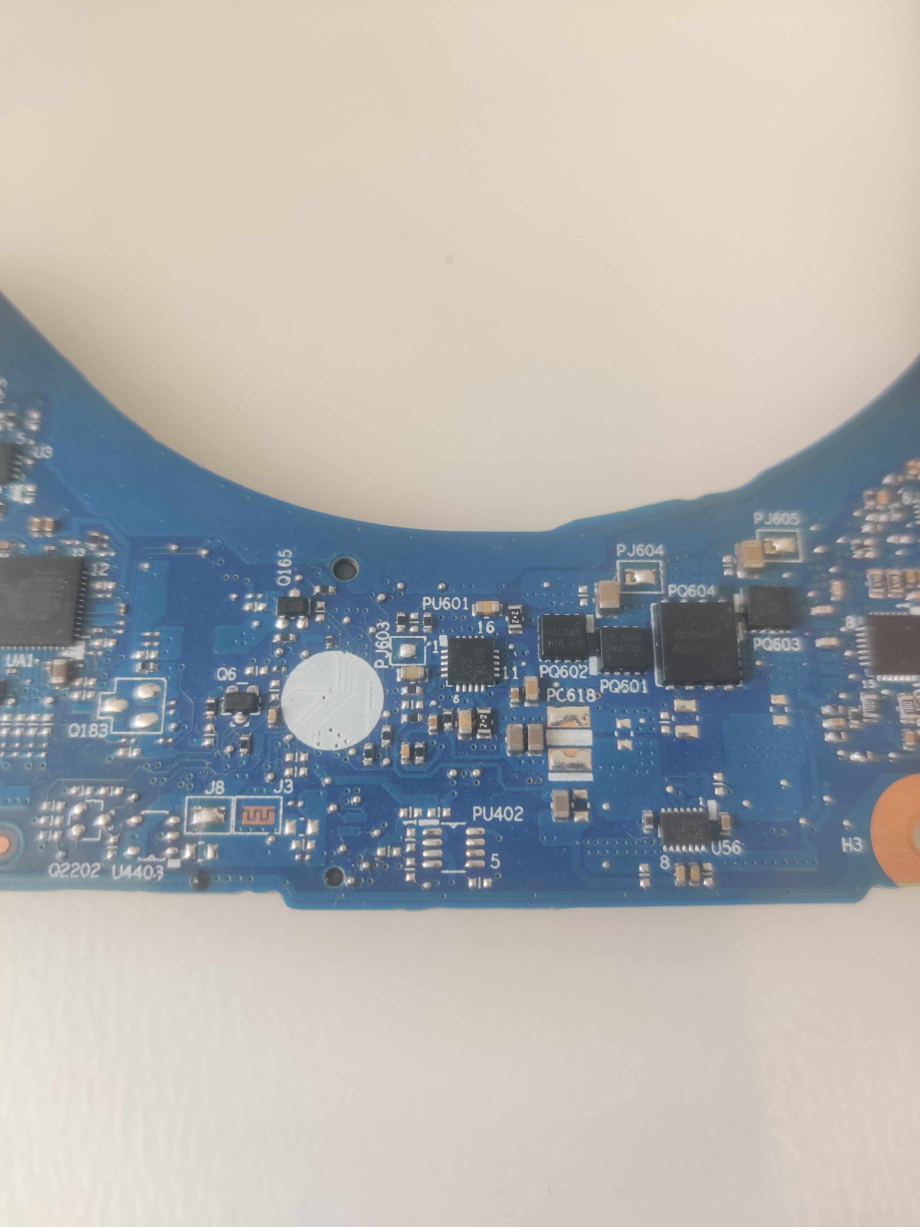

                                    The shorted part could be anywhere on the board that makes use of the (+5VALW) power rail created by this circuit.
                                    Flux and carefully lift up one leg or both on PL601. Then you can test the resistance again to determine if the shorted part is on the producer side (PU601) or the consumer side of this power rail.
                                    Do inspect the caps nearby PL601 to see if they look defective or burnt out.
                                    • mist79
                                      New Explorer
                                      • Apr 2024
                                      • 13
                                      Before I remove PL601 can you explain to me what you mean by that? test the resistance how? of PL601 to Ground?
                                      And nothing seems burnt out to me near PL601 from both sides of the board.
                                      • mon2
                                        • Dec 2019
                                        • 14732
                                        Flux and carefully lift up one leg of the electrolytic cap at PC616 that is to the left of this inductor.
                                        Then measure the resistance to ground again of this power rail.
