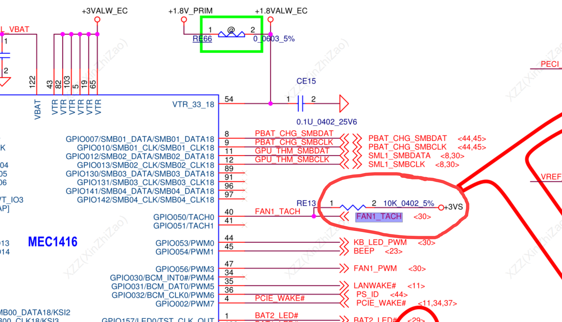

    Hello guys
    My laptop have a FAN issue, i tried with a new FAN but the issue persist.
    The motherboar is LA-G714P

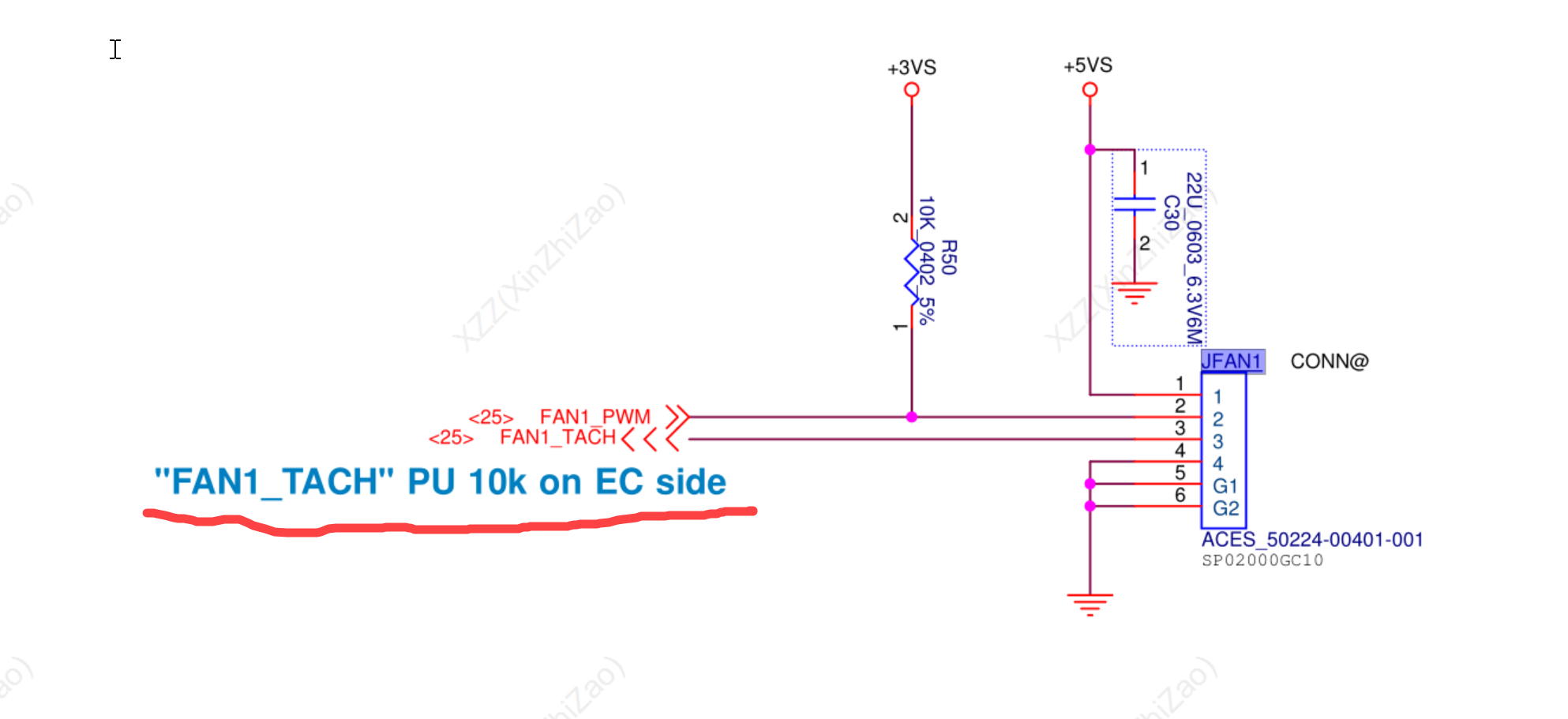

    I measured the JFAN1 connector
    pin 1: 5v
    pin 2: 0v FAN1_PWM
    pin 3: 3v FAN1_TACH (this pin should not be 0v if the fan is off??)
    pin 4: GND
    Tanks for advance!

      Yes, it is ok to have a voltage even without a fan on the TACH pin # 3. This is due to the 10k PU on the EC side of the controller. The EC is often a 8051 style microcontroller and used for dedicated functions like keyboard scanning, fan control, etc.
