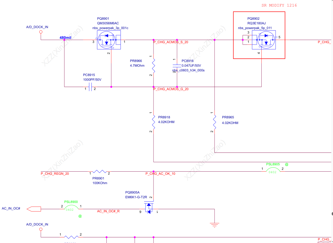

    I am encountering a problem on an Asus X421EA card which no longer starts; I checked the voltages, the 5v and 3vd are missing, has anyone encountered this problem, I have been looking for several hours without finding the source of the problem. Thank you!​
  • mon2
    • Dec 2019
    • 14657
    Start with voltage checks at the dcin power adapter connector. Next check the dcin mosfets that should follow this connector.
    Meter in dc volts mode @ 30v or higher.
    Check the voltage to ground of the first dcin mosfet with only the power adapter connected.
    Source (1-2-3) to ground.
    Gate (4) to ground.
    Drain (5-6-7-8) to ground.
    Post each measurement.

        PQ8901 pin 1 0v pin 2 0v pin 3 18,9v. PRS 8901 19v. PQ 8902 pin 1 et 2 0v, pin 3 0,223v

          See attached - appears to be similar.
          Click image for larger version  Name:	charger.png Views:	0 Size:	139.8 KB ID:	3264265
          Click image for larger version  Name:	DC_in.png Views:	0 Size:	80.6 KB ID:	3264262

              Remove all power. Meter in resistance mode.
              Measure the resistance across the PQ8901 mosfet:
              source & drain
              source & gate
              gate & drain
              Post each measurement. Checking to see if this DCin mosfet is leaky.

                  PQ8901 : PIN 1 ET 2 0V PIN 3 18,96V

                    I will already change QM3056 and see if the current comes out! I will keep you informed, time to order the component! Many thanks

                        I just replaced PQ8901 without result, I took measurements on the PCR8903 diode there I found 21ohm and 0 which is normal, I removed several components to isolate the problem without result! Do you have any ideas?

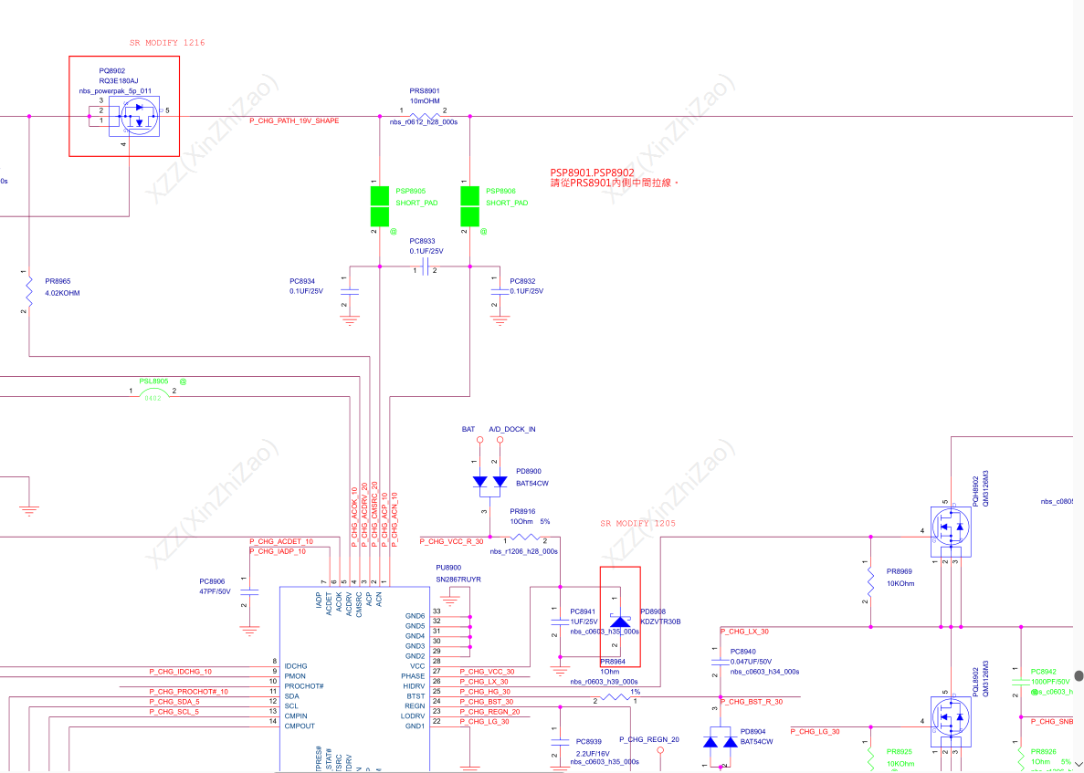

                          Re all the diagram that I found on the forum has points of difference with the broken x421ea r2.0 motherboard, some components are unknown, others do not correspond to the diagram, PC8915 PC8916 etc, do you have this diagram ? thank you

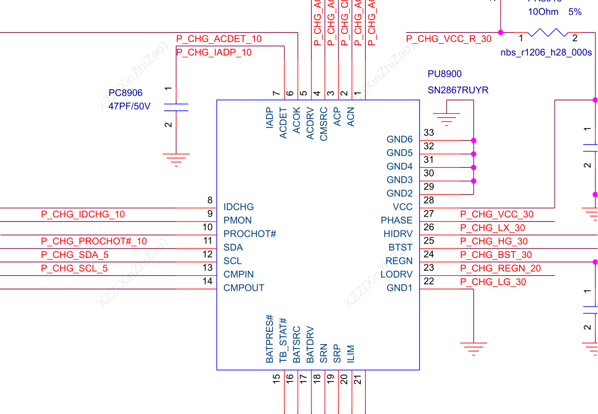

                          Which component makes the 3v, 5v and 3vs?​X421EA THK!!

                            Look for and post all part numbers for the QFN chips

                              Good morning Thank you for your interest in my problem, my problem is that the references on the boardview send me to components without references on the diagram, and sometimes the references are not found from the boardview on the diagram! From my previous question, are there other Asus X421EA diagrams? Thanks again​

                                I noted the references on the motherboard
                                -ALC3251
                                -9241H W021LF
                                -IT5125VG 128
                                -SV=7K
                                -Y038C 122
