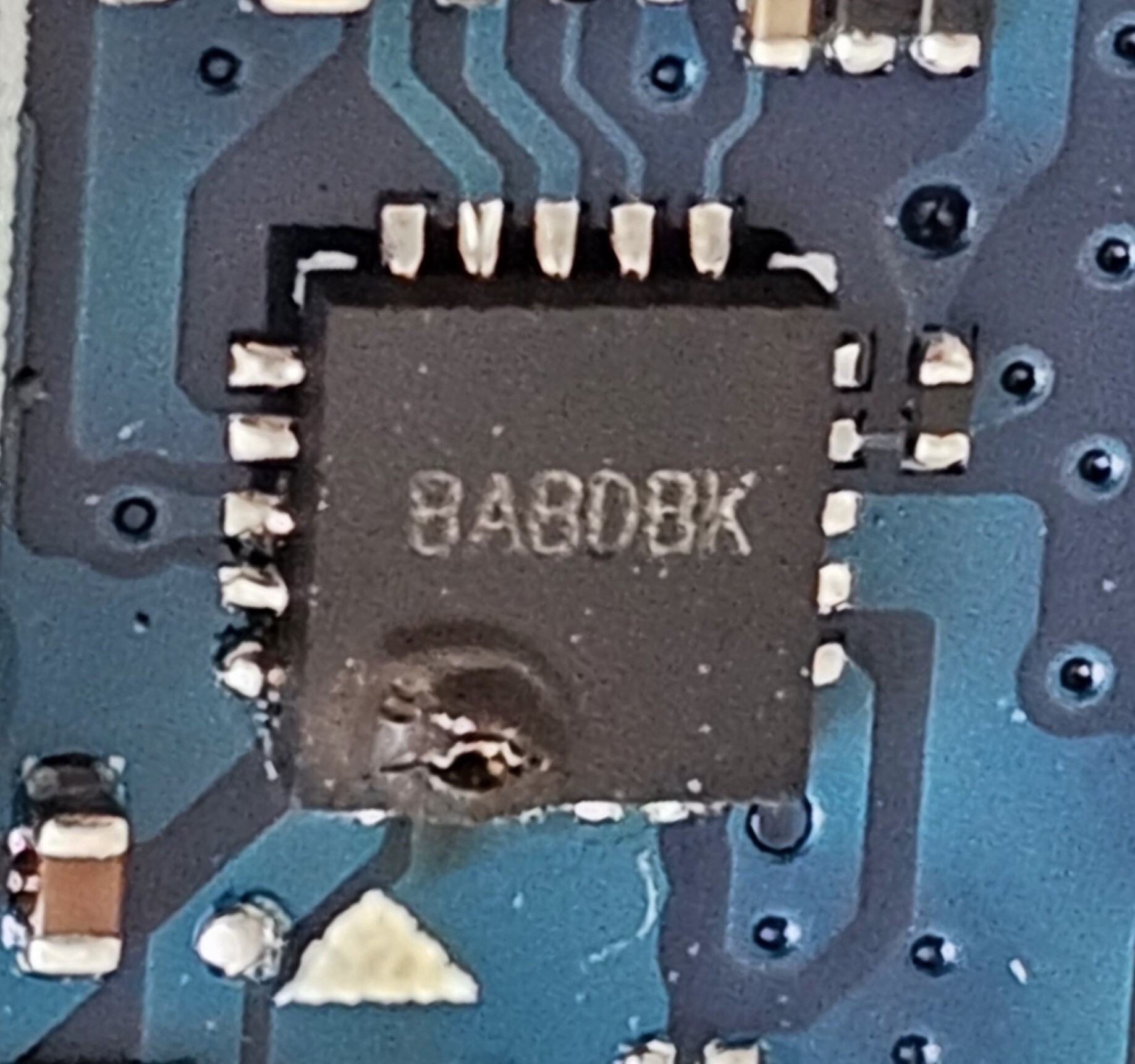

    Hi everyone, I hope I'm posting this in the right place. I'm new to this forum and I'm hoping you can help me out.
    My Samsung Galaxy Book suddenly stopped working and won't turn on at all. I noticed that the component in the attached photo looks burnt out. I think it's a voltage regulator, but I can't find any information about this IC online. I've searched using the code on the chip, but I haven't been able to find a replacement.

    BAB*** SY8288BRAC
    Check mainstream distribution first but is available on AliExpress.

      Thank you, you're the best!! I don't know how you did it, but you definitely have a lot of experience and knowledge!
      What other websites or stores do you suggest I check out before Aliexpress?

        See the Silergy database here:
        https://www.badcaps.net/forum/troubl...12#post1538202
        Just found this amazing item on AliExpress. Check it out! US $1.69 22% Off | (5-10piece)100% New SY8288BRAC SY8288B SY8288 (BAB5ZA BAB5ZD BAB...) QFN-20 Chipset
        https://a.aliexpress.com/_mN1ckz8​
