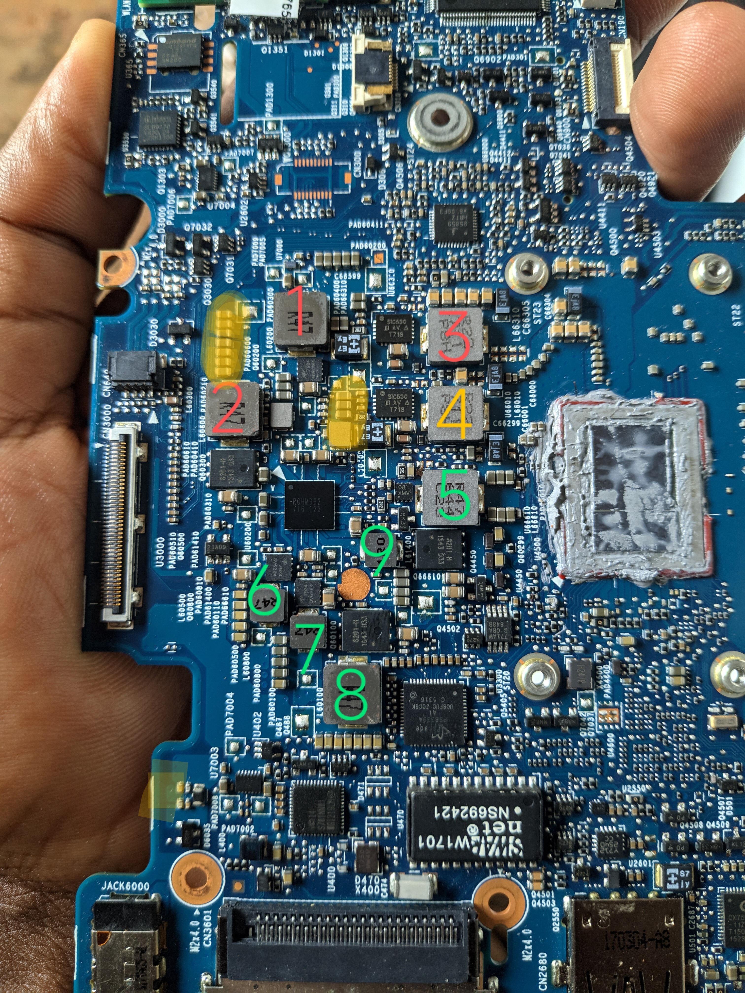

    Hello, I have this Hp pavilion 1030 G1 that starts with a single light on caps lock then it turns off, measurements at the coils, meter in resistance mode (not continuity mode) are as follows: The problem started just after it fell from a desk to the ground. I can't find a boardview or a schematic diagram anywhere, please help me 🙏
    1. 13k ohms
    2. 0.00 ohms
    3. 6.7 ohms
    4. 8.9 ohms
    5. 18.2 ohms
    6. 83.5 ohms
    7. 99.4 ohms
    8. 10.7k ohms
    9. 68.5 ohms
    Click image for larger version  Name:	PXL_20240426_140505609~3.jpg Views:	0 Size:	3.48 MB ID:	3260316

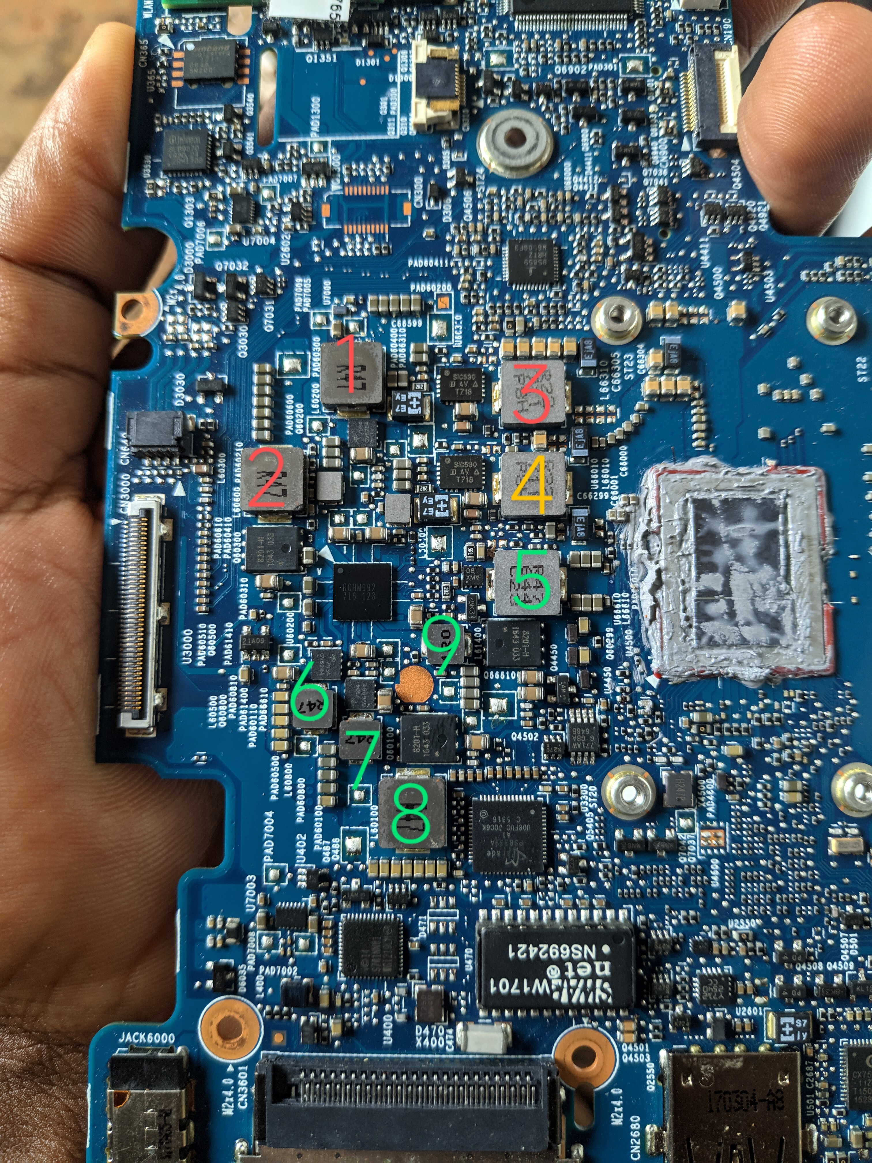

    All these highlighted caps arr shorted I don't know how that happened just from a fall
    • rogfanther
      • Jul 2006
      • 458
      • Brazil
      Parts 1..8 are not caps, but coils. They should read as low resistance, like when touching both tips of your multimeter.
      • sarry86
        • Jun 2021
        • 90
        • Tanzania
        Ikr, but I was saying about those highlighted in yellow

            • 21869
            Originally posted by sarry86
            Anyone?
            Desolder coil 2 ,check the resistance on both pads. If the short is on the side with the row of caps desolder the jumper,the solder blob just to the top right of the top cap and check resistance again. If the row of caps are the only thing between the coil and jumper and its still shorted one or more of the caps is bad
