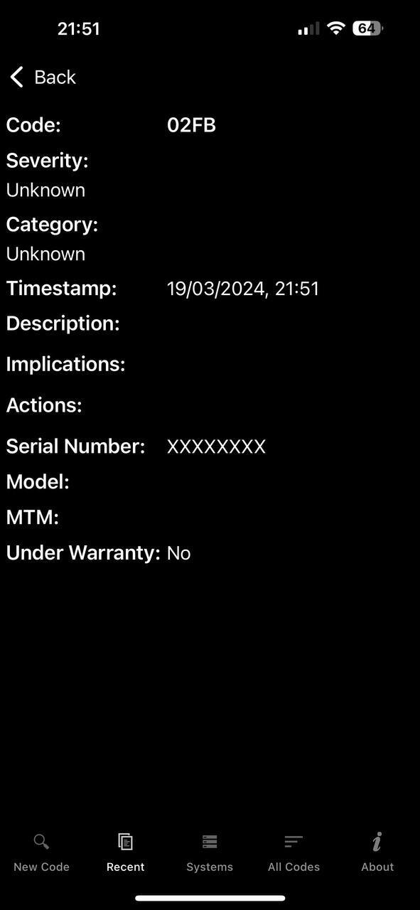

    im using lenovo pc diagnostics and error read 02FB...but i dont know what error is that....i try flash bios but still no display...anyone know about this error?
    board number - EA481 NM-B711 REV 1.0

    Possibly a bios issue - https://forums.lenovo.com/t5/ThinkPa...FA/m-p/5236552

      Originally posted by SMDFlea
      you're right, its bios....i try flash bios several times but still no display....and for the last file i download here and working fine https://www.badcaps.net/forum/troubl...95#post1685495
      thanks SMDFlea

        You`re welcome. By the way,with lenovo`s its important to flash the bios for the same model type.
