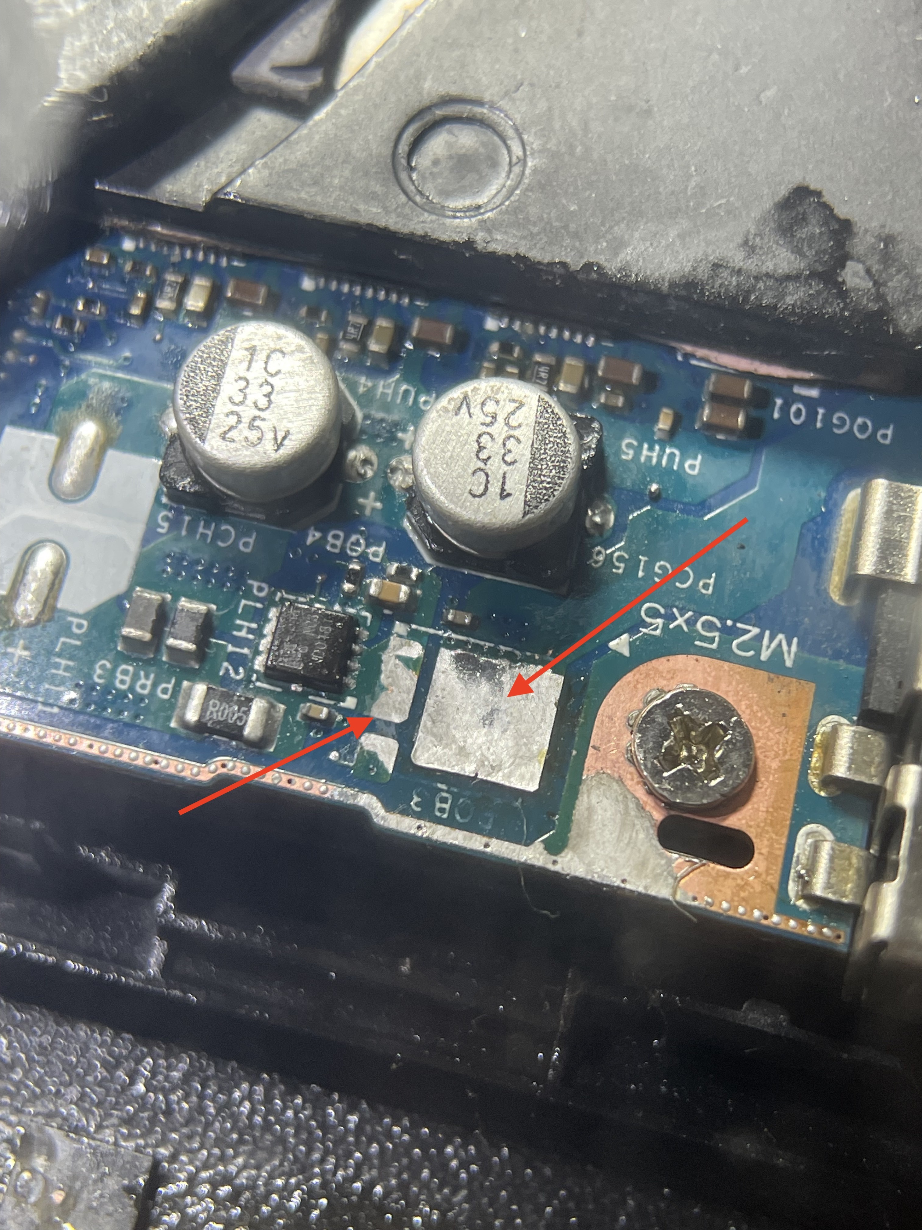

    ​Hi all,
    Excuse my ignorance.
    Does this look like a damaged PCB.

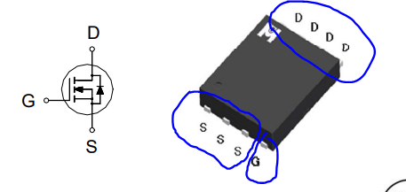

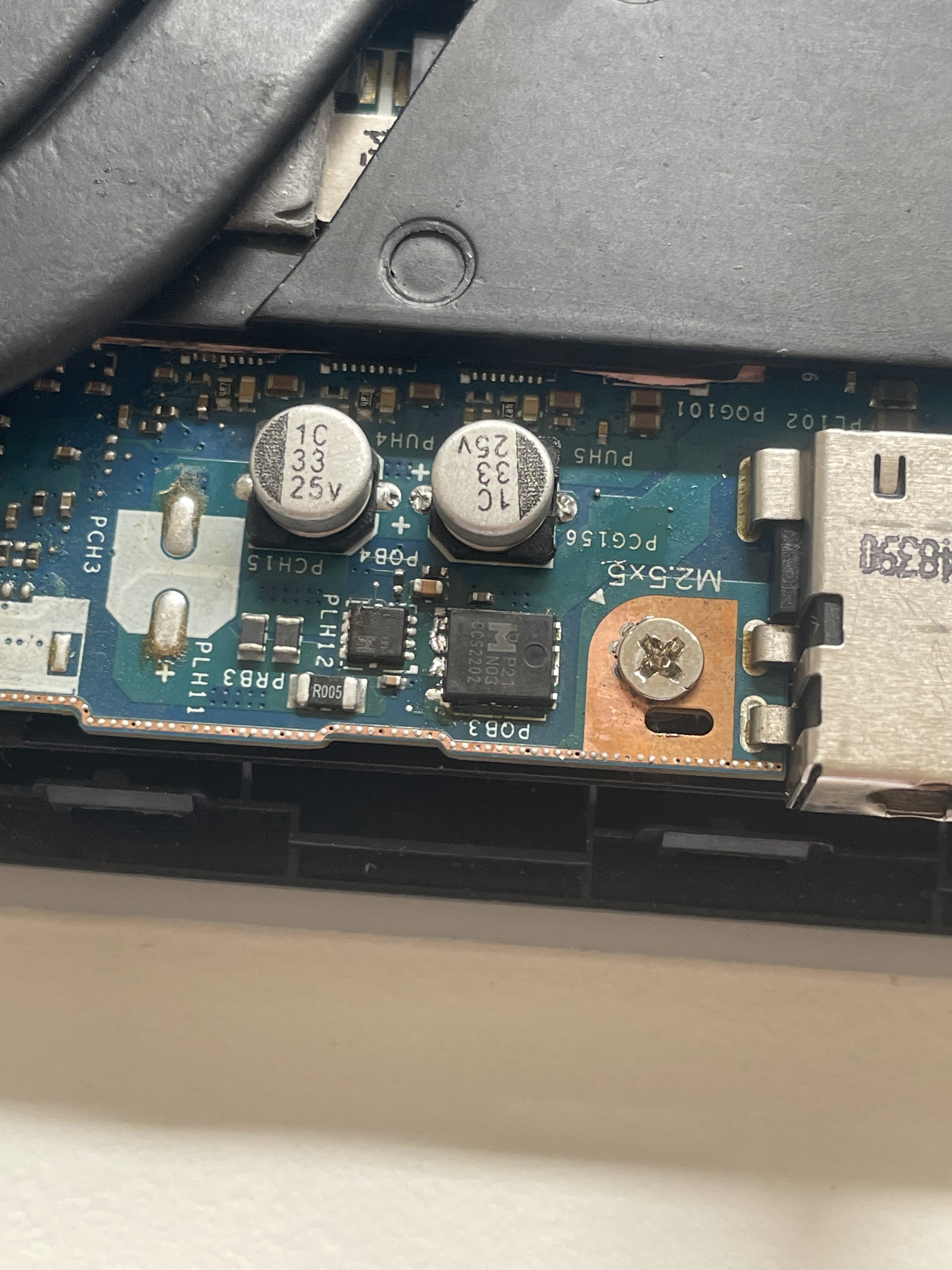

    This is how the N mosfet should be sitting on a working board.

    no, it looks ok

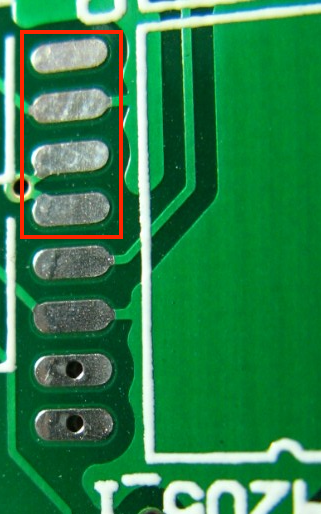

      Have you seen the left hand arrow? Shouldn't the pads looks like this rather than one piece?

        yes, there is little solder mask missing but those 3 pins are connected together anyway so it doesn't make a difference
