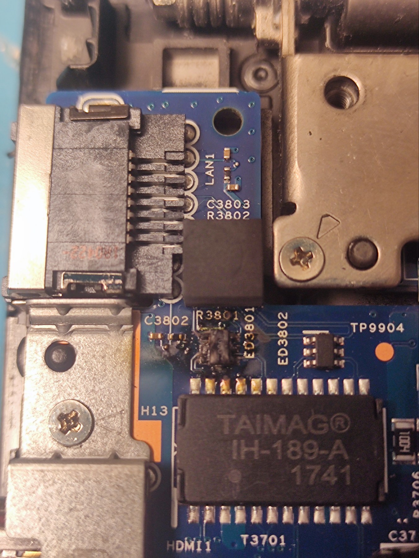

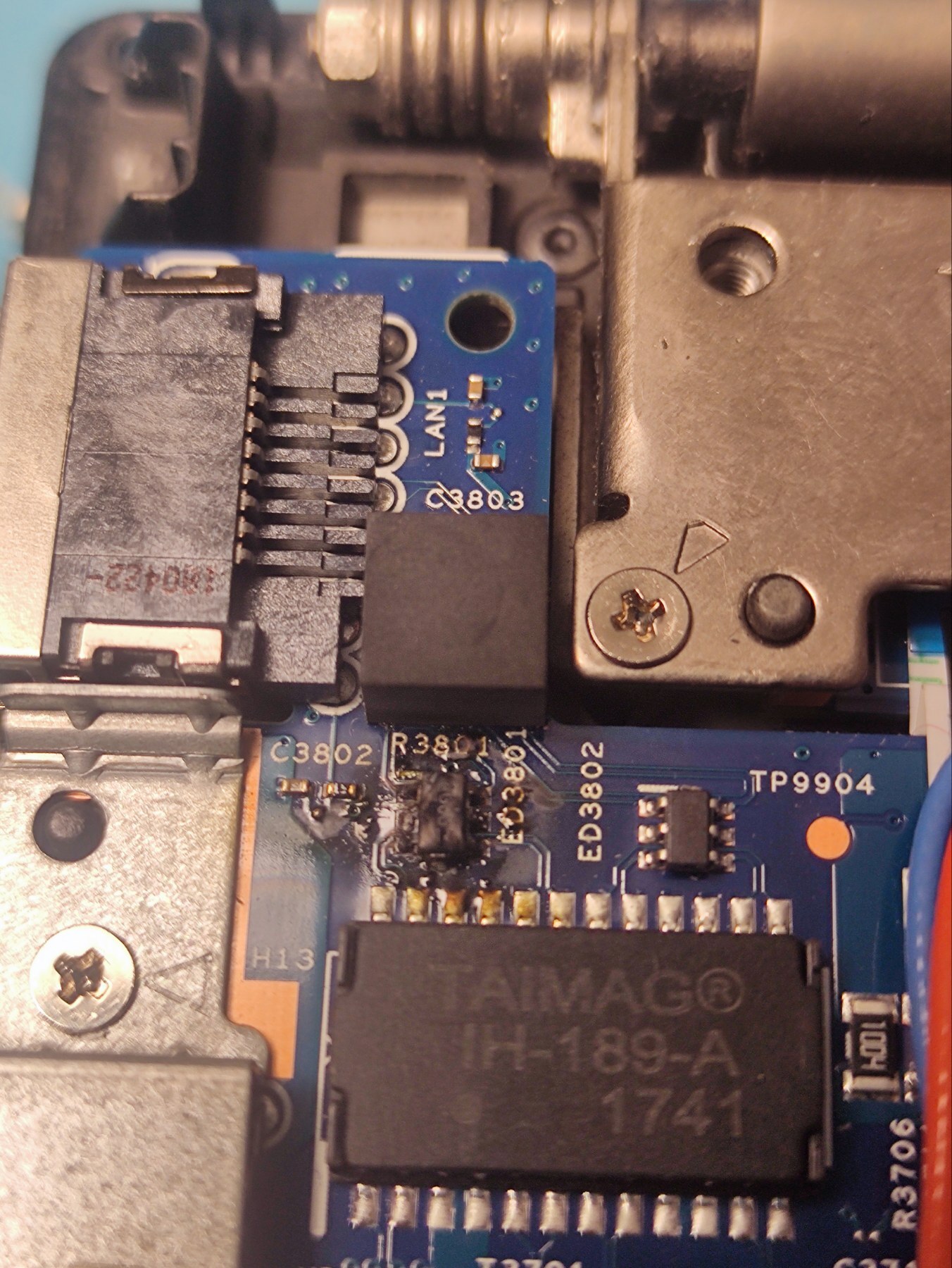

    Hello ,people.
    A laptop that i received , it works just fine. Finished all the tests (the full length one) + works without problems.
    But, this component was burned and it was removed ... but i have zero clue what it is.
    (The lines beneath it are destroyed burned to the ground of hell!)
    Lenovo Thinkpad T570
    See photos attached below

    Something must have happened around the RJ45 Jack to have this result. Regards

      Thanks for that, but the Ethernet works haha! So i don't know what the hell is going on

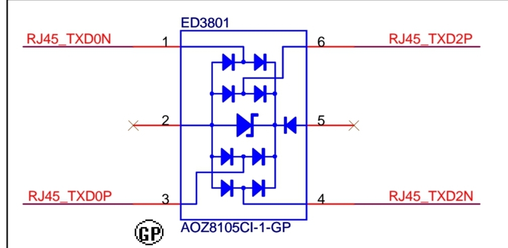

        It is an esd transient suppression device. It is dead now from some event. It needs to be replaced. Otherwise you will not have such protection in the future.
