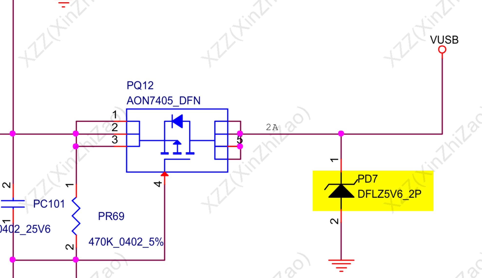

    Lenovo Yoga 900-13ISK - Diode FHL C8
    can anyone help me to find this diode? FHL C8
    It's from a Lenovo Yoga 900-13ISK
    See picture attached.
    Thank you

    Zener Diode 5.6 V 1 W ±5% Surface Mount SOD-123FL
    DFLZ5V6-TP Micro Commercial Co | Discrete Semiconductor Products | DigiKey

      • poky500
        • Jul 2022
        • 12
        • Italia
        Thank you so much! mon2

          Hello
          I am trying to find FHL CN diode from the same Lenovo Yoga 900-13ISK
          can anyone help?
          • mon2
            • Dec 2019
            • 14659
            See post #2.
