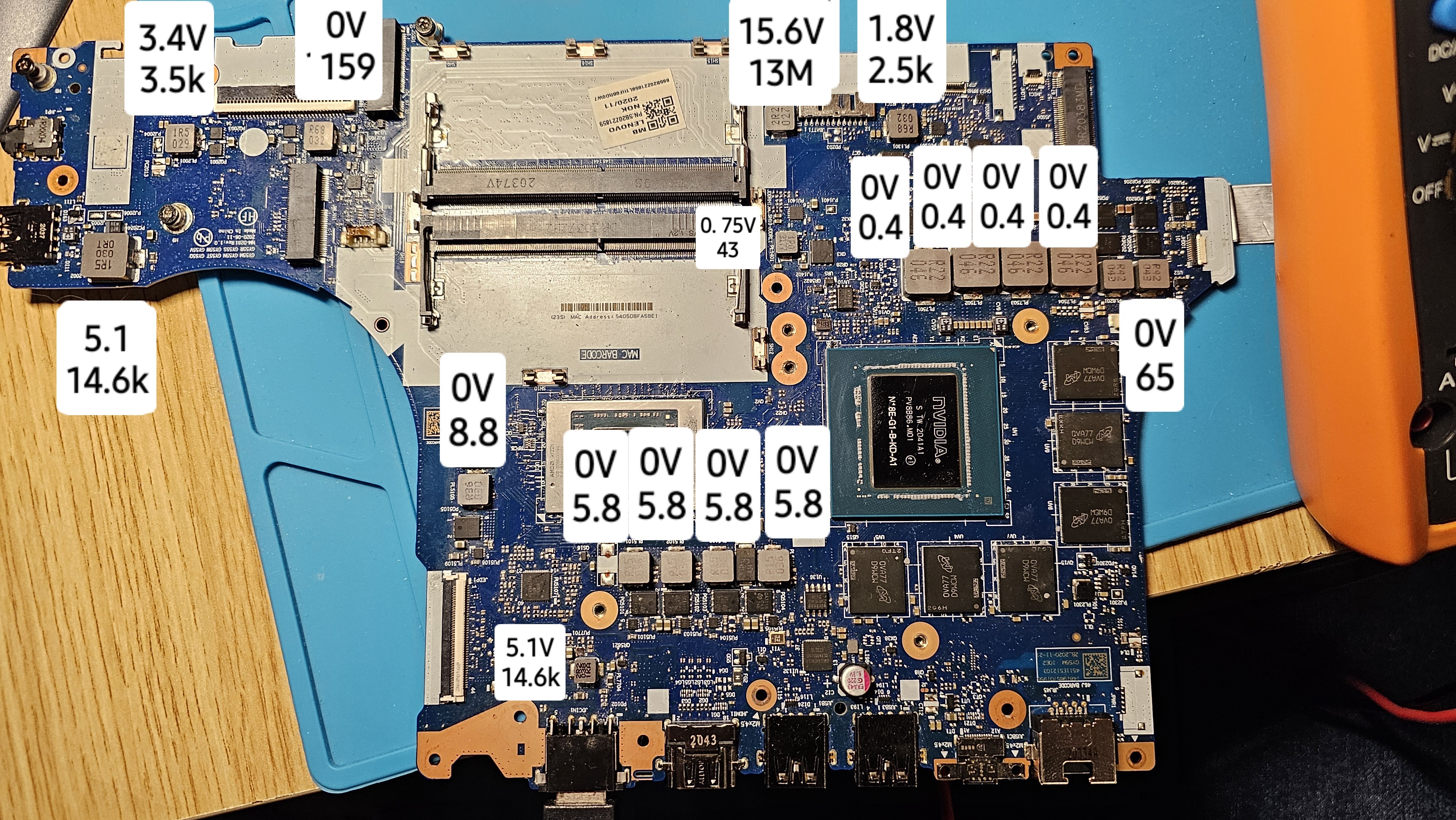

    State: when power button pressed white power button led lights up for 10sec the off for 8sec and then back on for 10 and that is happening in the loop. When charger connected charging light is on battery is charging. Checked with mmeeter. Done some basic fault finding but no luck. I've reprogrammed bios. No good. I want to start from scratch. Please guide me what to measure first cause I'm lost now. Thanks.

    Simply everything. A overview of the whole board, resistances to GND and voltages of all easy accessible power rails would be a good start.

      Attached voltage and resistance on each coiI and also boardview for this mobo. When powered on voltage does not change. Looks to me that I got 1.2V missing. RT8231A voltage regulator. What should I do next ?

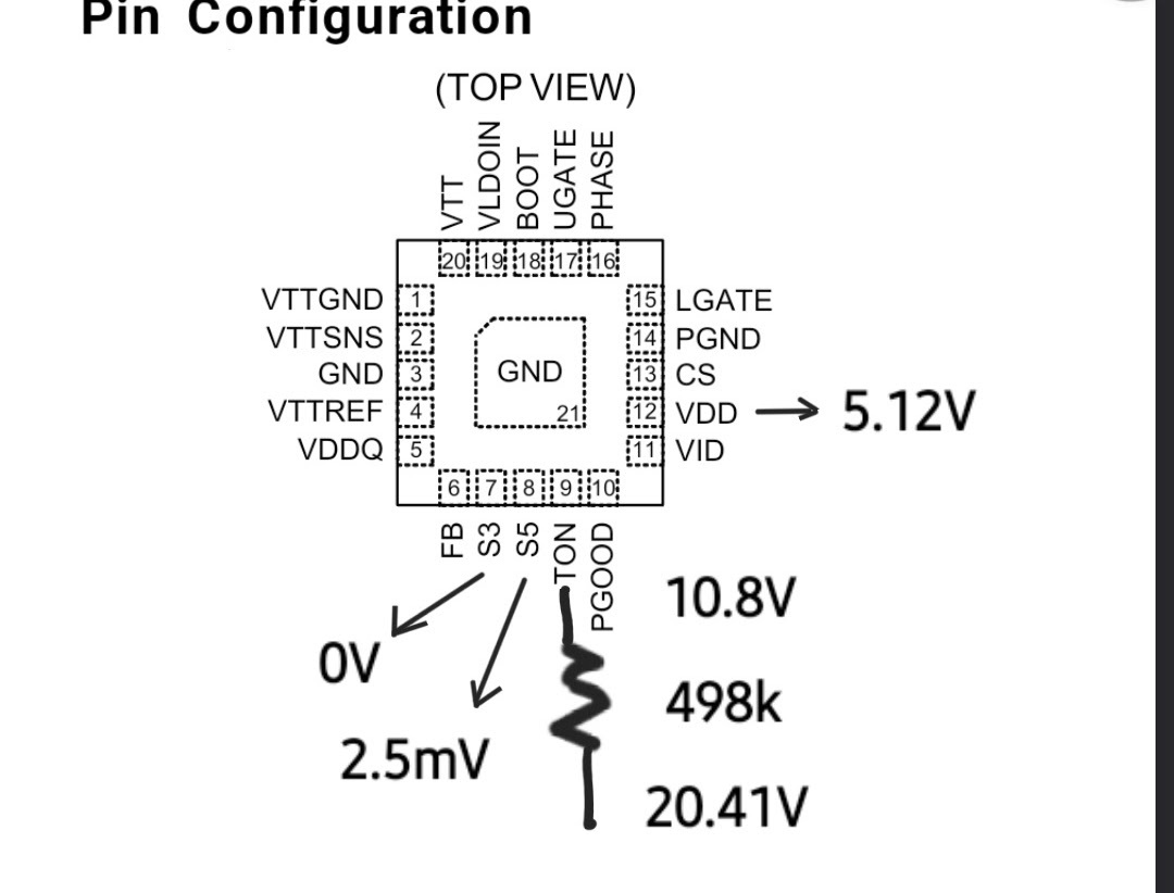

        PU2701 is your ram IC.Check whether you have voltage on pin7/8(after pressing power button). Pin12 VDD is present or not.PR2711-voltage on both sides. Do check whether 3/5V ALW rail is switched to 3/5v VS.

          Attached results for PU2701 and PR2711 resistor after pressing power button.
          Just not sure how to check whether 3/5V ALW rail is switched to 3/5v VS. Can you advise?

            Enables are missing for ram regulator.SLP_S3/SLP_S5 both are missing as PCH is not responding. DC-dc transfer of 3v/5v to 3v/5v VS must be checked. Without schematics i cant confirm where is the conversion circuit.You need to look at mb closely-its not that difficult to locate it on mb.
