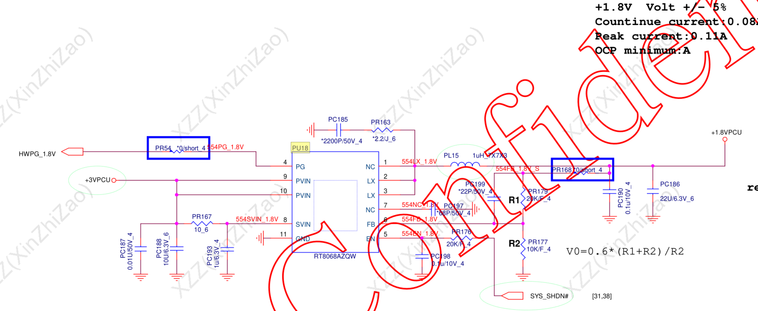

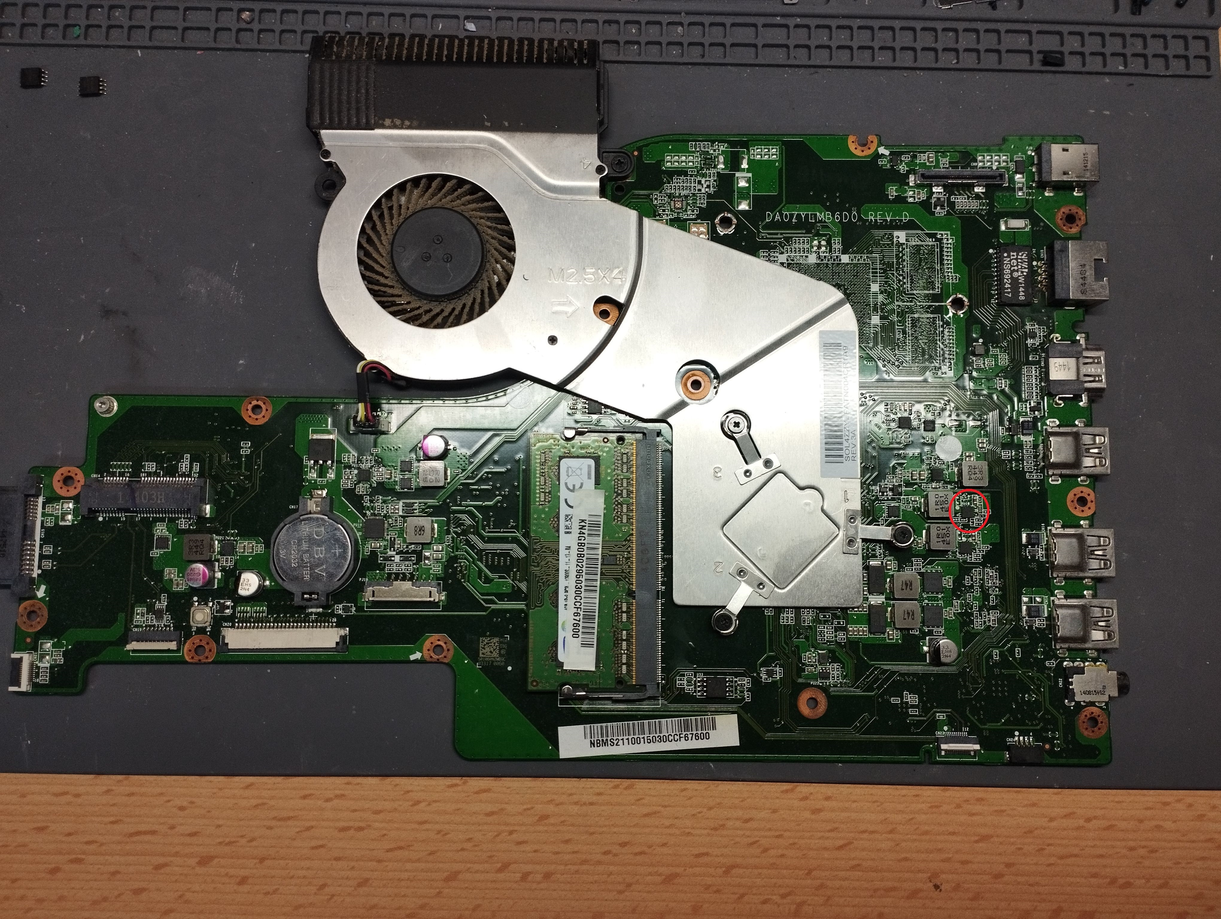

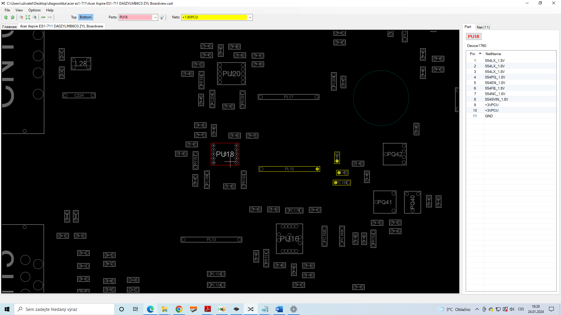

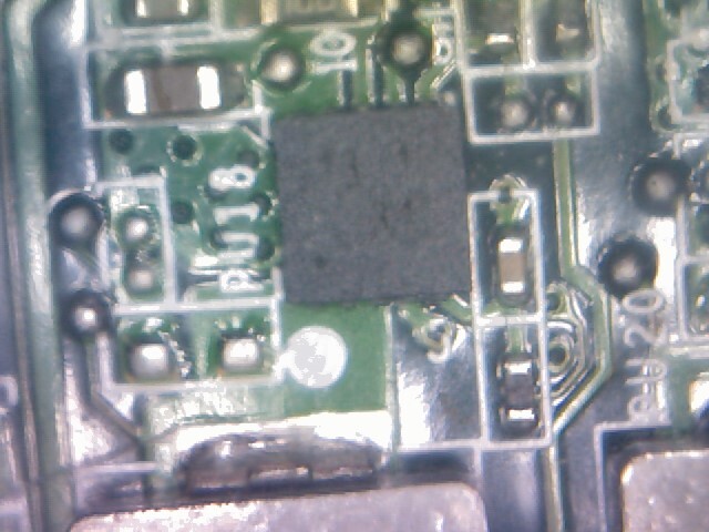

    Hello guys, please help me with identify a component on motherboard for Asus ES1-711 DA0ZYLMB6D0 rev: D. Schematic not available.
    This IC should be DC-DC converter for 1.8V, marked 13 1 31, check attached files.
  • mon2
    • Dec 2019
    • 14861
    RT8068AZQW
    Datasheet:
    RT8068AZQW Richtek USA Inc. | Integrated Circuits (ICs) | DigiKey
    Click image for larger version  Name:	PU18_schematic.png Views:	0 Size:	658.1 KB ID:	3203697
