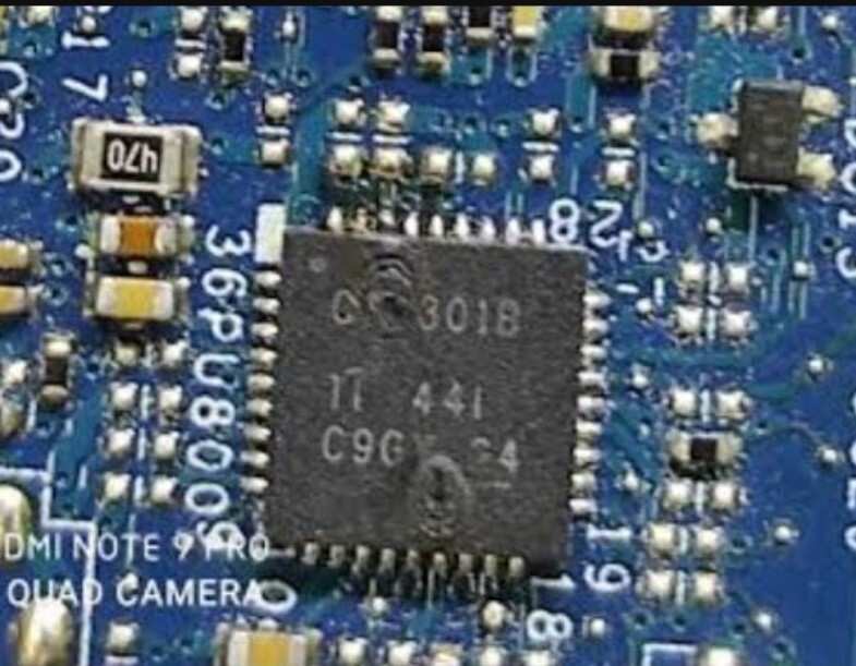

    Model : Dell E7240 ( LA-9431p)
    All coils ok.. No short
    When injecting voltage supporting charging ic CD3301B ic is heating.
    After replacing new cd3301b ic, the new ic is also heating.
    *** This attached image is for reference.

    If it is heating:
    1) is the component a known good device?
    2) soldered in ok?
    3) check the resistance to ground of each pin (with no power). A short or low resistance load can cause heating.
    4) a number of YouTube videos claim this part can be bypassed- not sure
