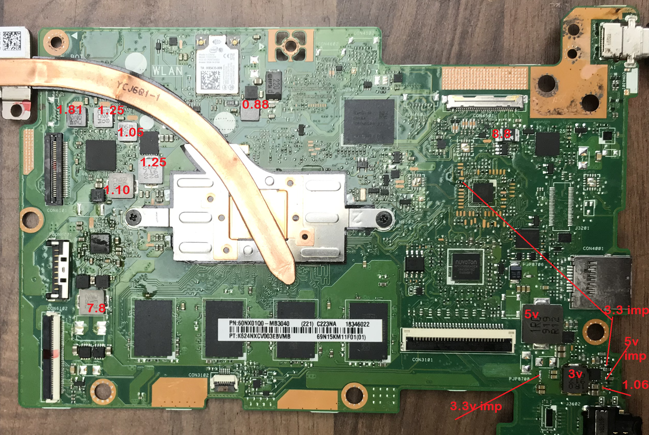

hi everyone, i have fixed and measured some voltages on this motherboard. hope this will help you guys to fix this faulty motherboard
chromebook ACER A223NA voltages
