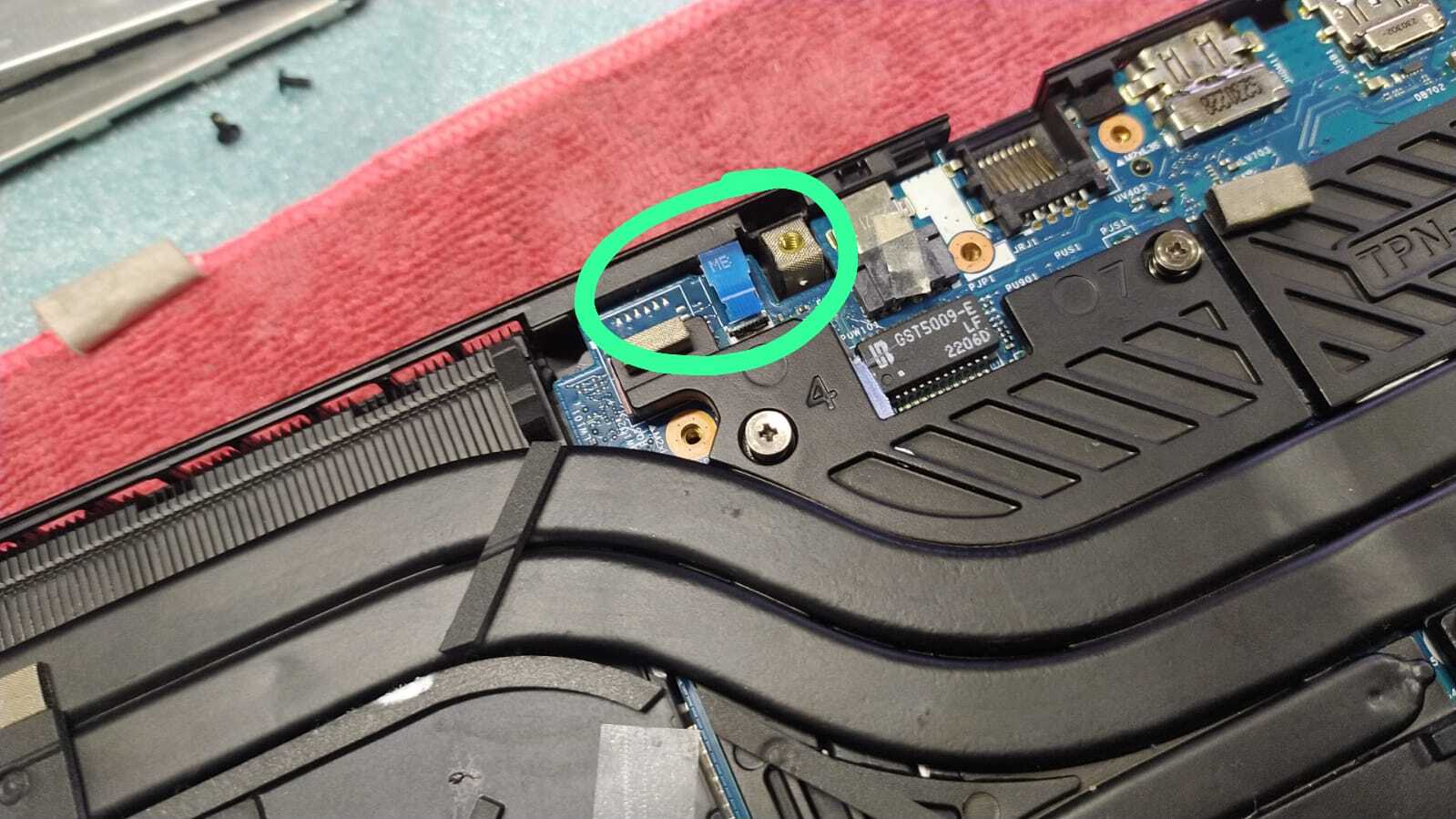

    Hi Guys,
    Got a weird one here. I have a HP OMEN 16-WF0032TX that's in my shop for no power. If I disconnect the battery, and the AC adapter and hold the power-on button on the keyboard, when I connect the adapter the laptop powers on. If I shutdown and close the lid, once I re-open the lid and press the power button, no power. If I shutdown and keep the lid open, when I press the button the laptop powers on.
    I have checked around the display connector if I can see anything that doesn't look right, its like an issue with the lid sensor. Has anyone seen this before?

    Yes,LID sensor seems like the issue.

      I had the same problem and i fixed it, you should change the Lid sensor.
