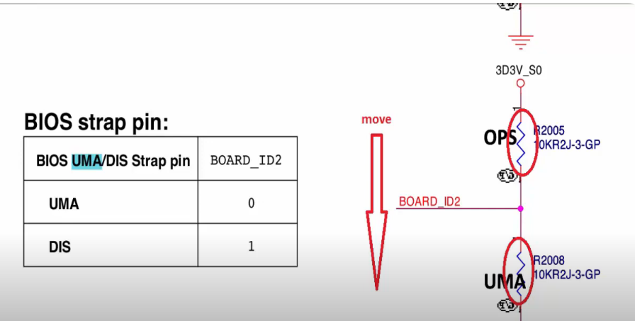

need help converting dell inspiron 3543 discrete to uma
  • bembeno
    • Feb 2016
    • 313
    • egypt

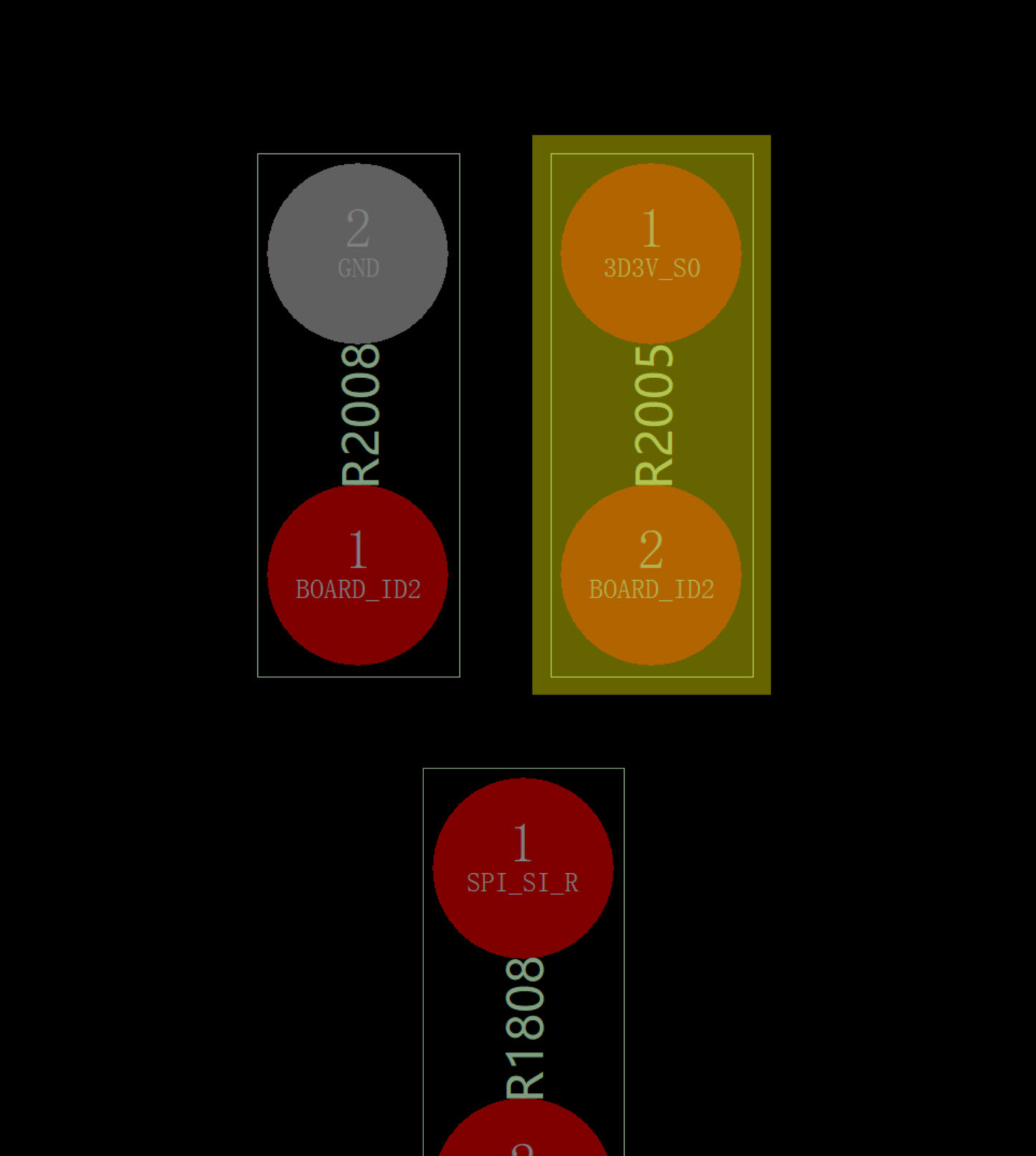

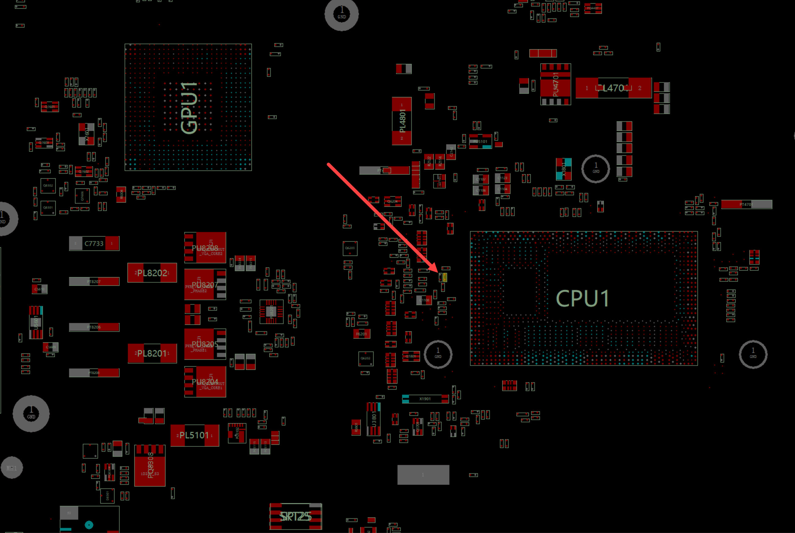

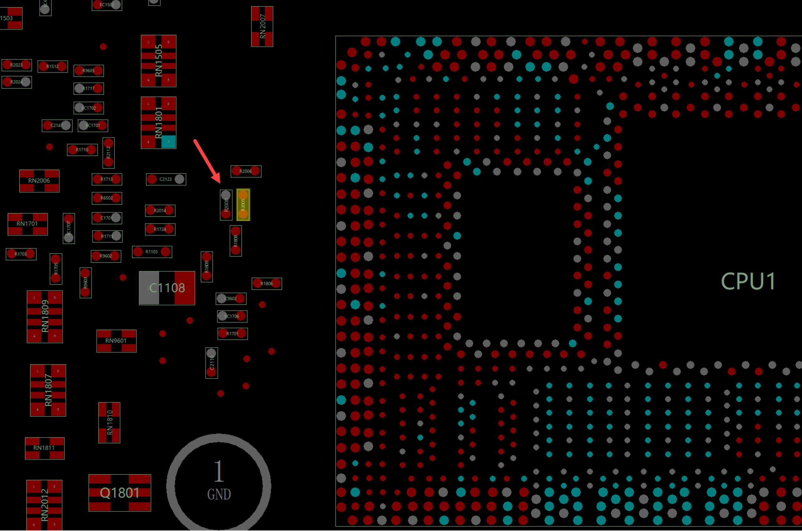

ID:	3154534 need to detect the place of r2005 and r2008 on the board i cant find them and the boardview.cad file didnt work
  • mon2
    • Dec 2019
    • 14664
    See attached.
    • bembeno
      • Feb 2016
      • 313
      • egypt
      thank you bro
