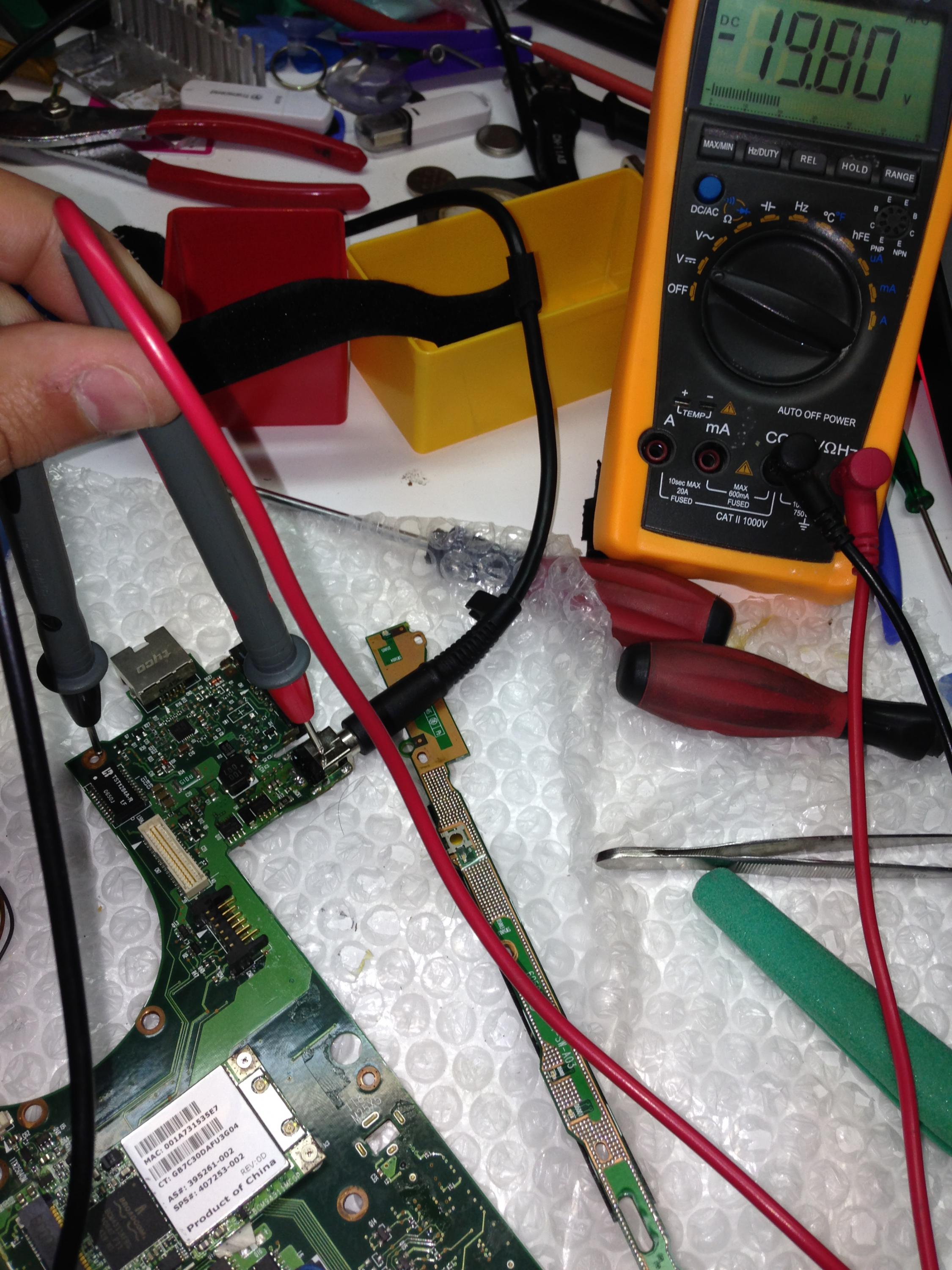

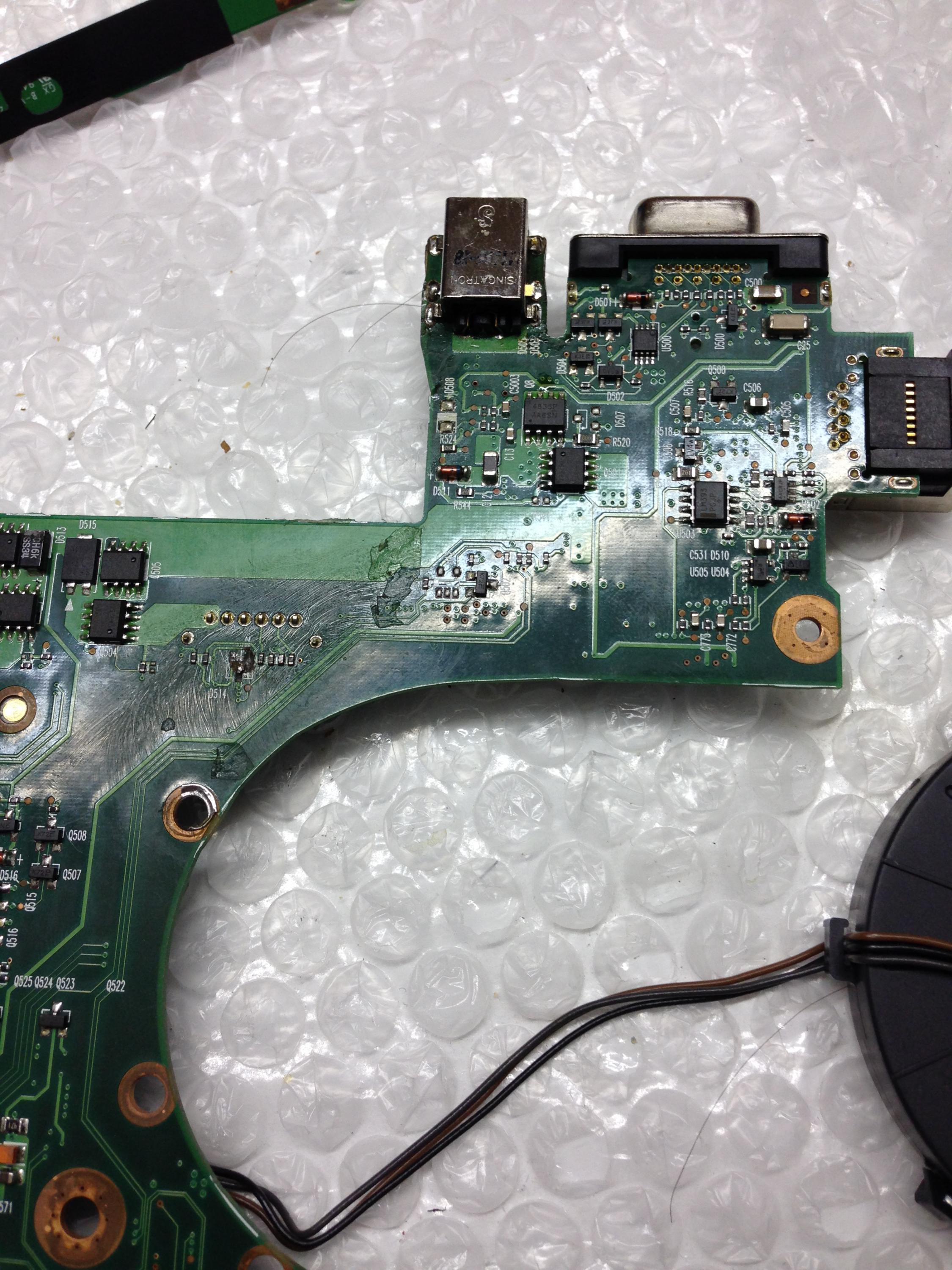

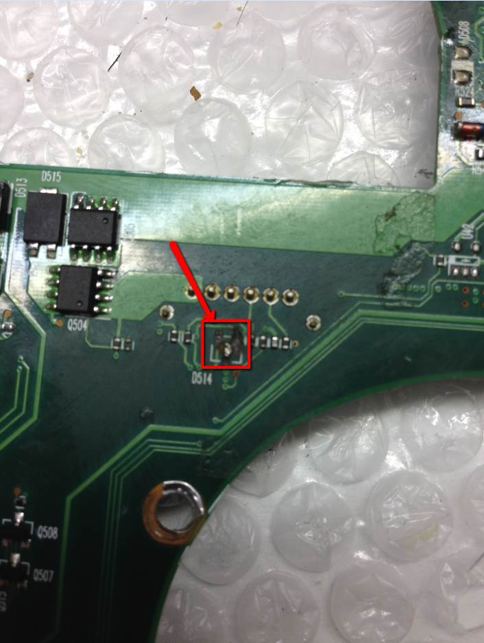

    Hi, i get some old laptop. There is short cut on board but i cannot find where. I have 19V on ground. There is no heating components, or any indicator. I found some burned dual zener diode.

    hmm, i have ordered burned dual zener diode. But still cannot find how i have 19V on ground
